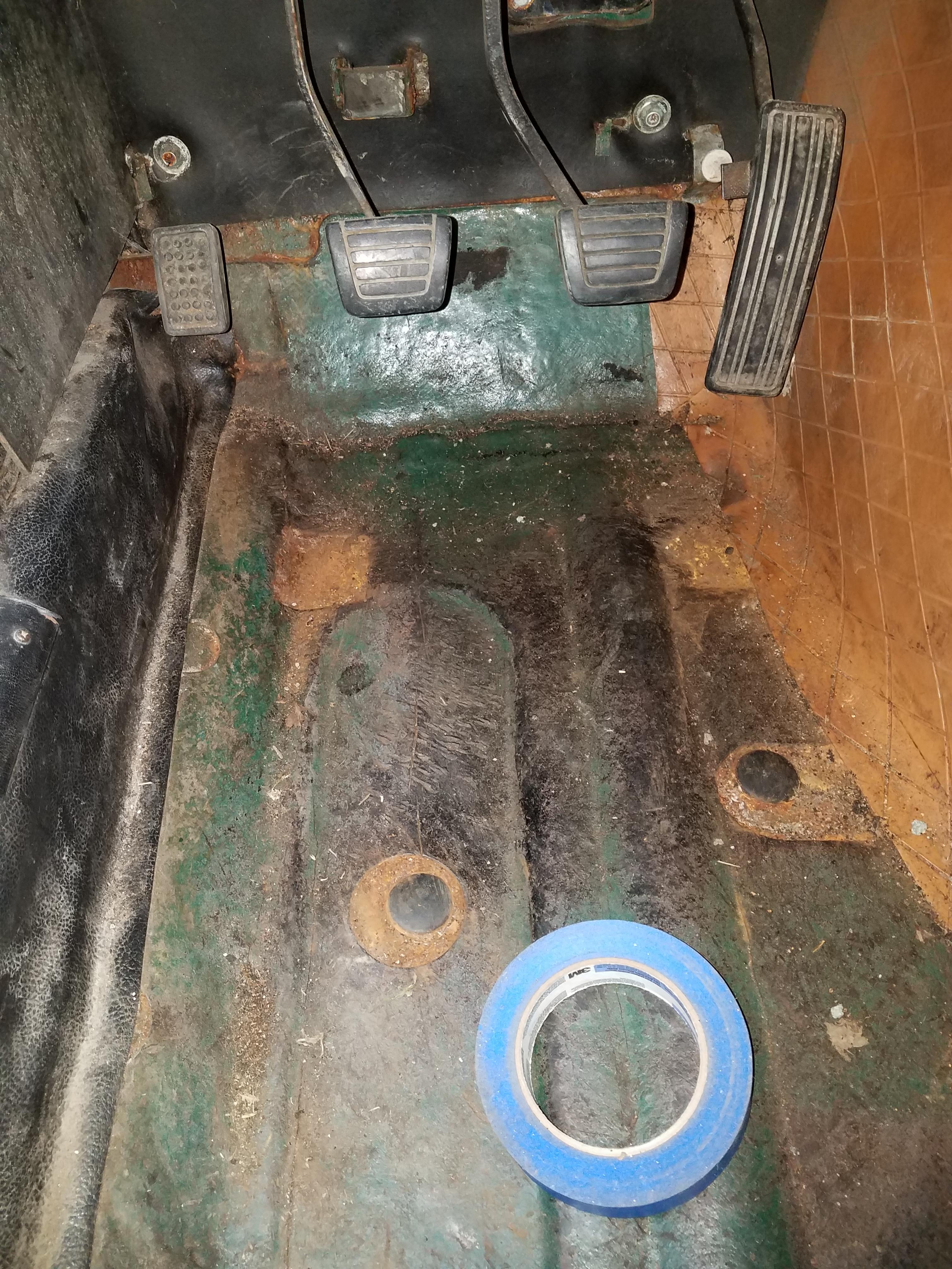

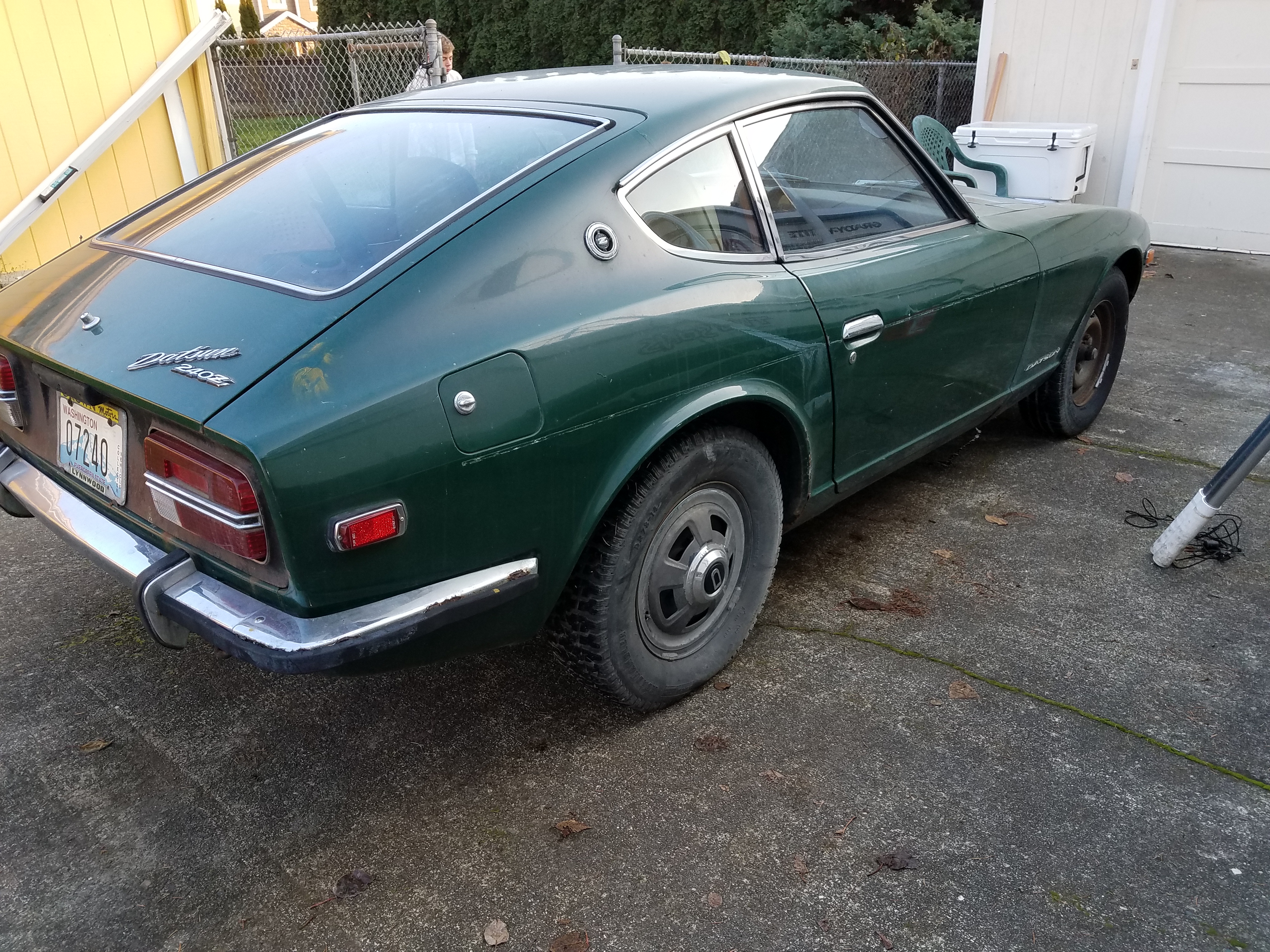

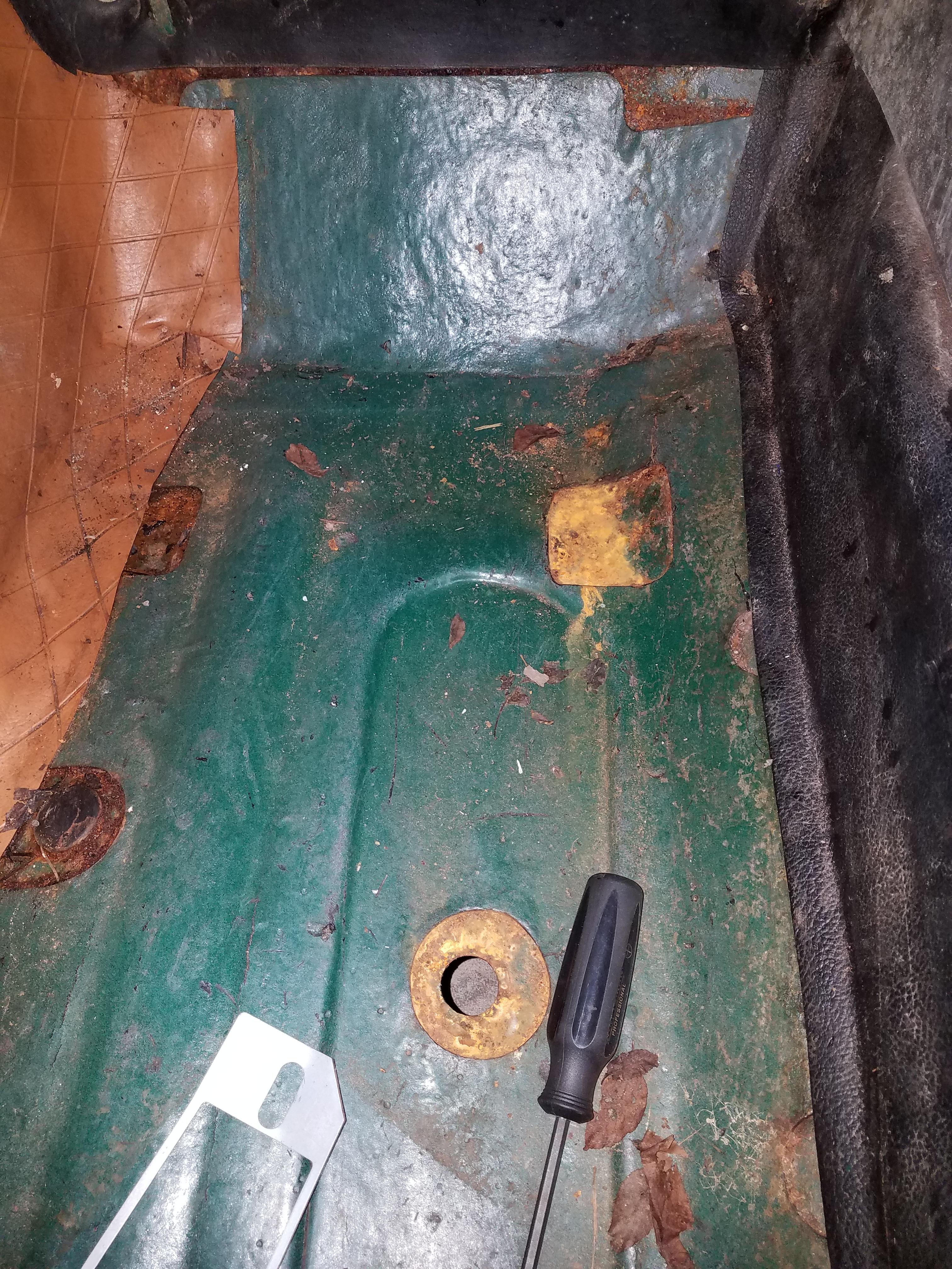

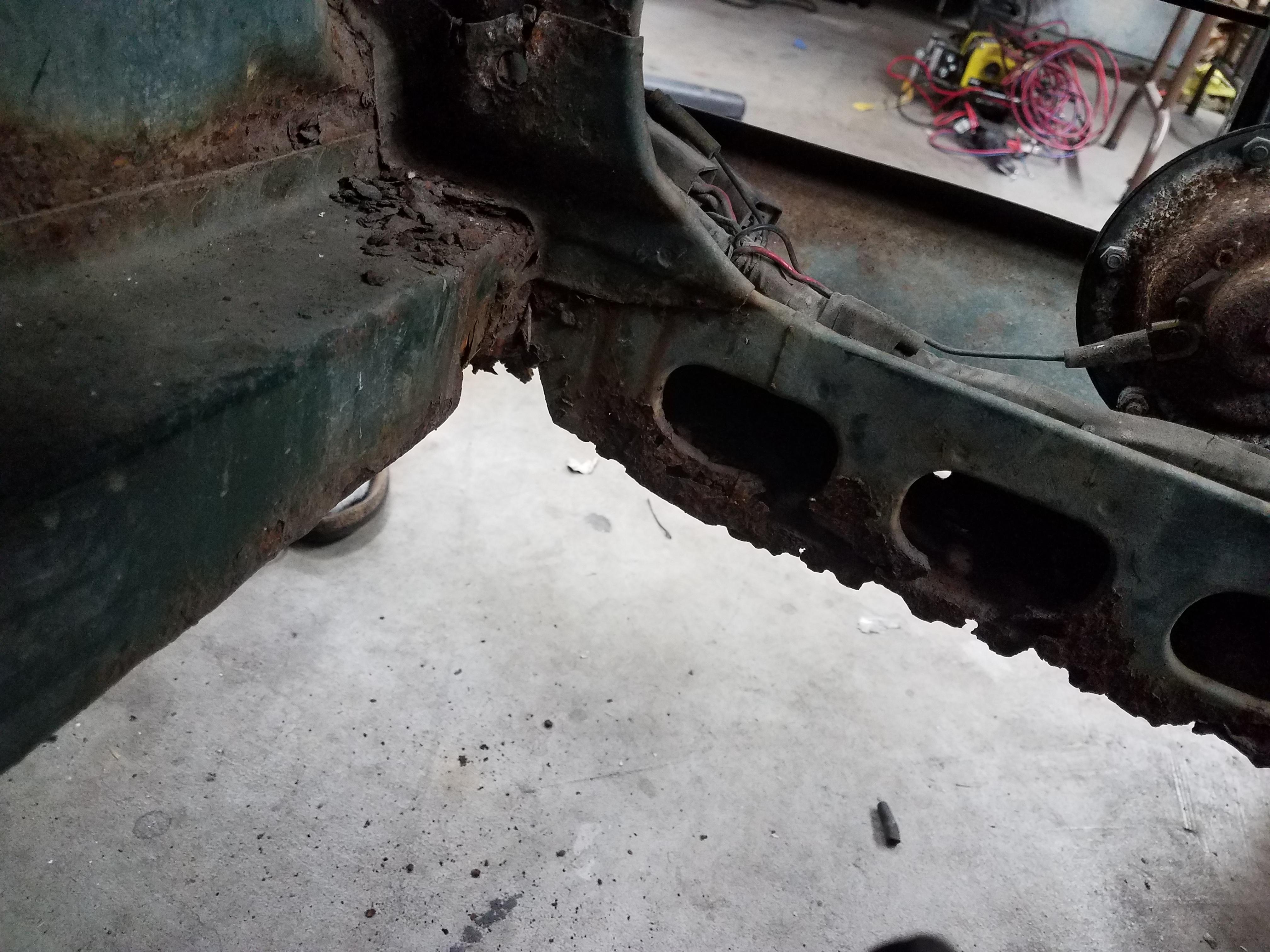

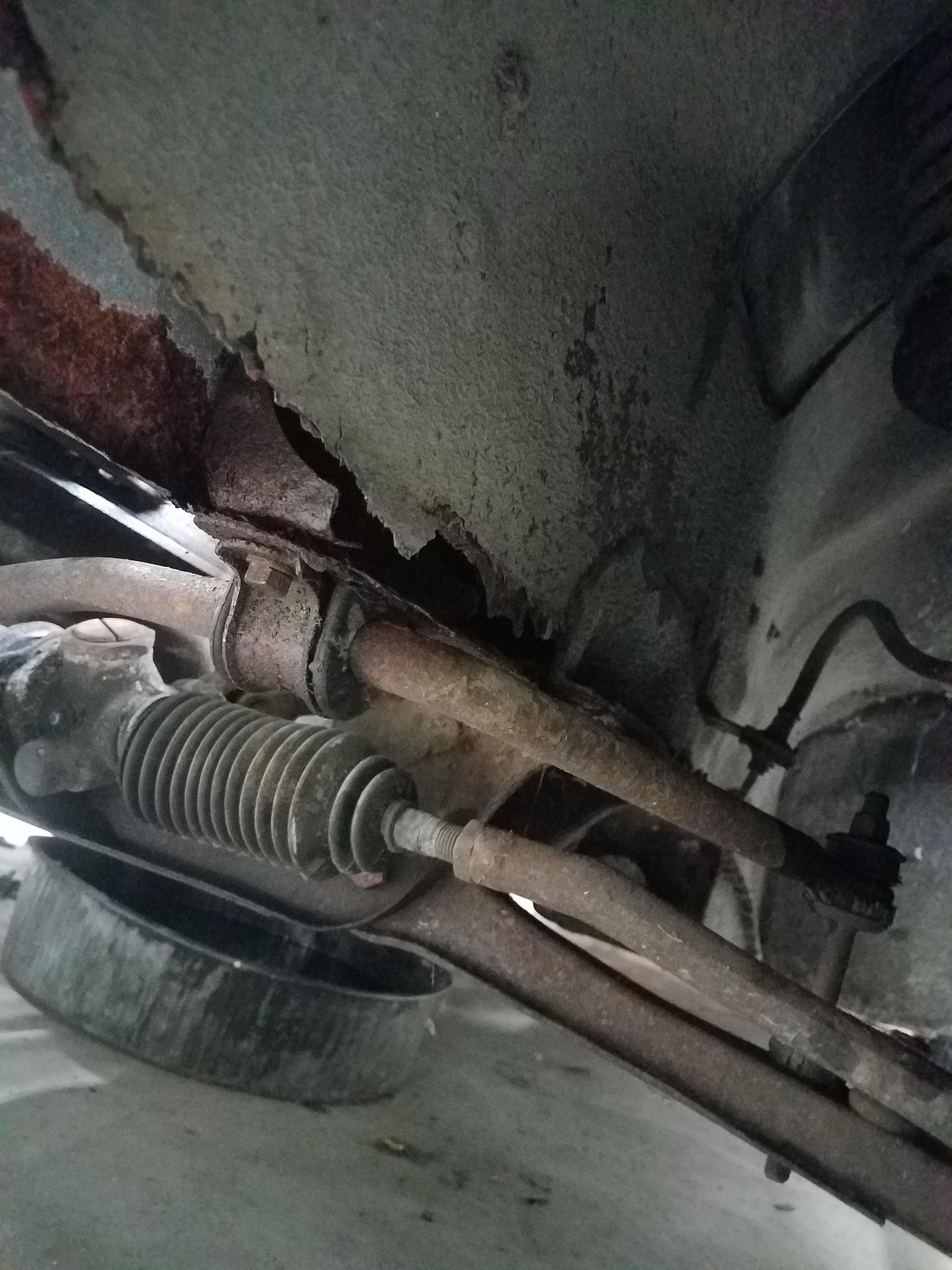

I recently acquired a 6/71 240z. It has cancer but not terminal. Front frame rails, radiator support and under the battery, the floors aren't that bad minor patching in front of the pedals. I found an affordable 74 2+2 that is rust free. I'm wondering if I can use from the firewall forward and just replace the entire front of my car. What fits and what doesn't?
I'm hoping to keep all of my Mechanicals and exterior panels until I'm ready to paint, which may be a few years. My car is pretty unmolested with original paint.

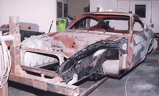

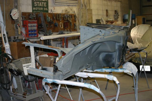

Whoa, that's a big project, I guess it is possible but you would have to mount the 240z on a well designed jig with reference points, take some very careful measurements of the 240 and compare them to the 2+2 to be sure then drill out all the spot welds... and when it is done you may still end up having to do extra work to match up the fenders to doors.
I would be tempted to just remove the parts you need from the 2+2 and stitch them in to the existing 240 body, I think you would end up with less alignment problems.
Oh, and welcome to the forum, lots of info and help here.  Which ever way you go take lots of pics before and during.

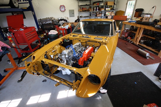

You can do all kinds of swaps.....been there done that. You’ll need a good frame shop ( and $$$$$$) to make sure everything lines up.
Edited by Diseazd
You do have to very careful to graft the clip on in the right place. A frame rack would be best, like shown in Diseazed's pictures.

If I do the work myself a frame rack is not going to be an option. I have a little bit of experience grafting a car together with a friend which we did in my shop. I'm no pro at this that's for sure. Both of the projects above look similar to what I'll be taking on.

This is definitely a good option, however the many unknowns when I start tearing into this leave me to believe that I will be safe or if I have a donor car on hand. If I get a good donor and have it at my house I can make those decisions as I go. I've looked at a lot of aftermarket frame rails and floor pans but I know that battery tray is not available.
The lower inner fender is rusted away on the left side. Even with new frame rails you'd still have to make that area. If it were my 240Z I'd fix the rust or replace the nose with another 70-72 240Z nose rather than use a later nose. If I remember and have time tonight I'll get some pictures of the early and late inner fenders so you can see the differences.
