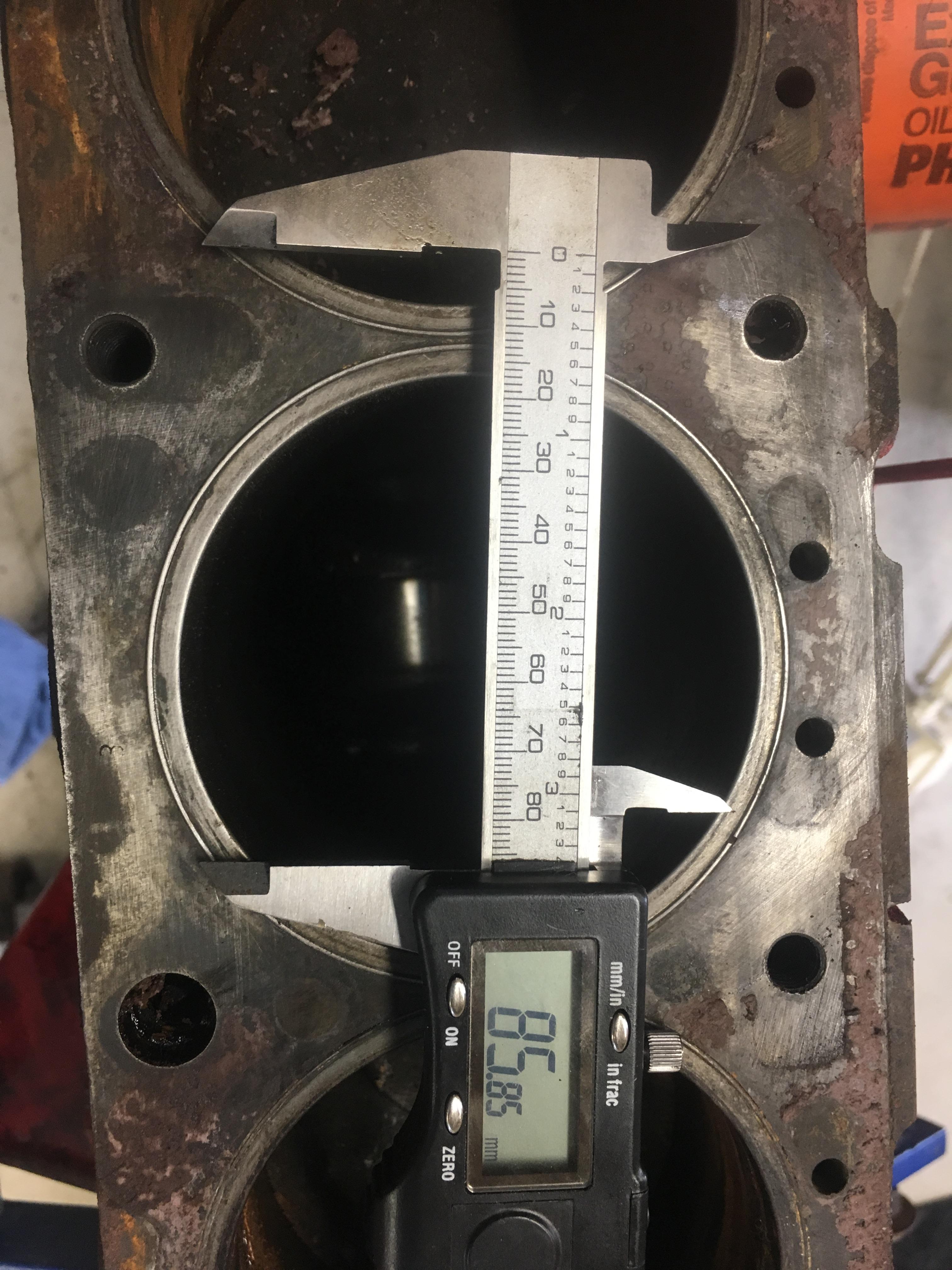

So  this is getting more interesting. 86mm bore and  O- ringed . The cam seems basically stock . Shims are .035 so betting chambers are about 39cc .

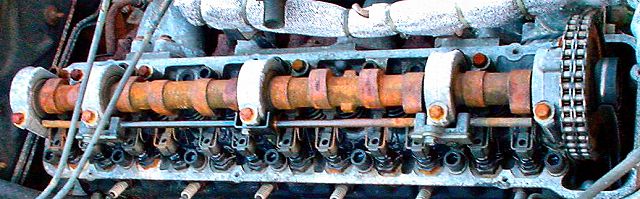

So this is getting more interesting. 86mm bore O- ringed . The cam seems stock . Shims are .035 so betting chambers are about 39cc . The top of the head was also surfaced . Head passed a pressure test and is .009 out of flat . Valve seats look like they were done right but still investigating . Cam will have to be turned , most of the rockers are okay ,  it some have some pits. Springs are rusty enough to warrant not using them . Lash pads and retainers are okay . I'm going to try and make a good head out of this e31 . Ports were only blended for the bigger seats

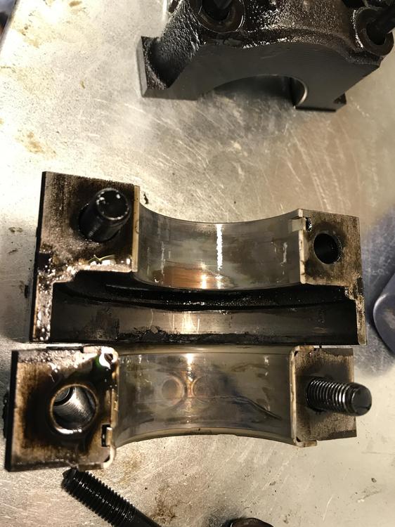

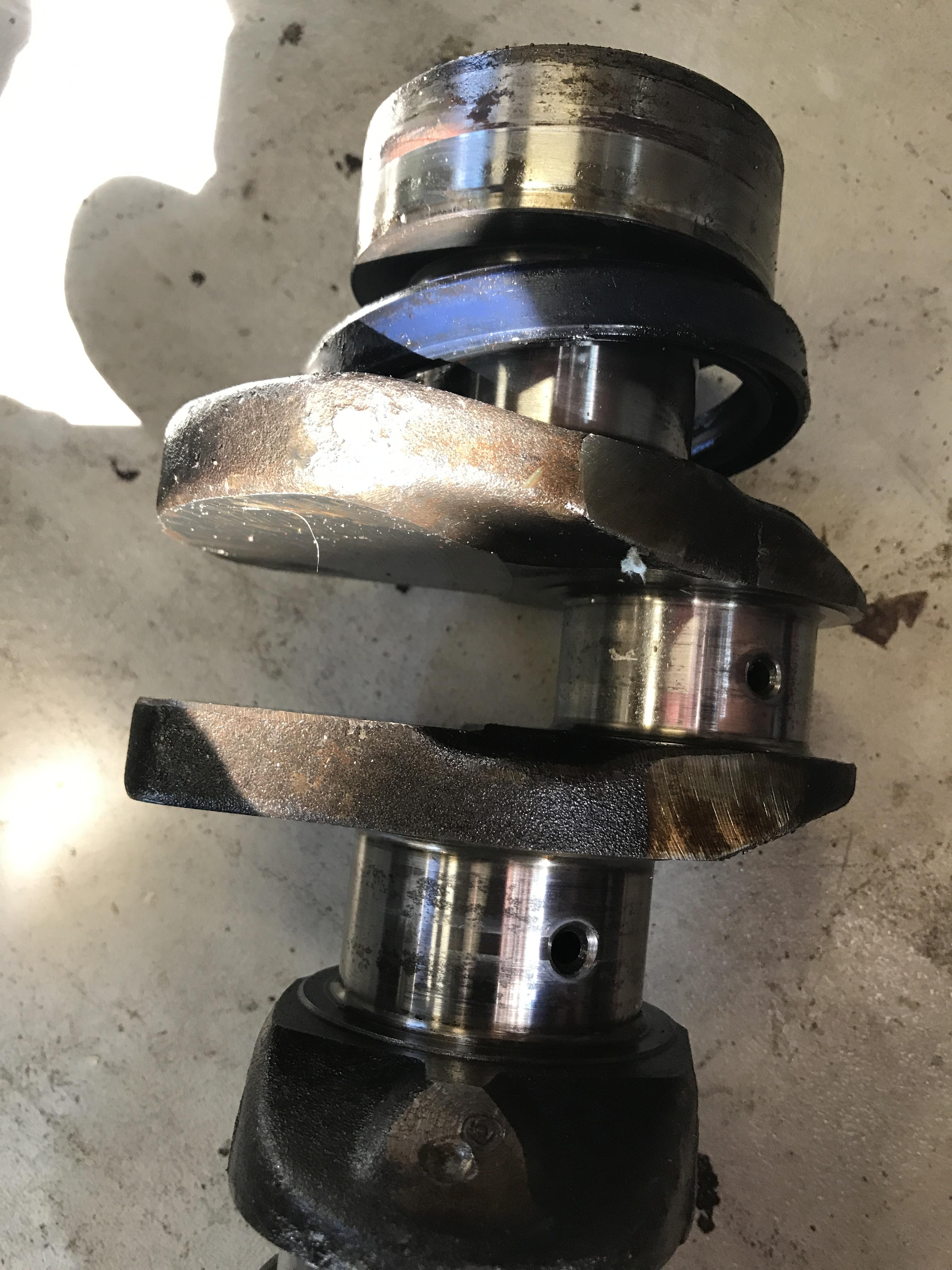

Crank journals and bearings have had a hard life

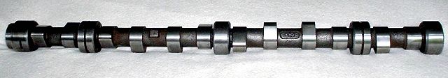

Restoration is so cool. Blue is right.....send that cam off to Isky and it'll come back like new. Wish we could send ourselves off and have us come back like new.....:wacko:
Guys - it's just a stock cam that will have to be reground to be anything of interest to me .  The head is my main concern. The block is toast but might be able to sell off the pistons and rods and the crank will probably polish up. Not sure if I want to try and punch out another L24 just make this engine again.
I did contact one of the previous owners and he said it ran like well, but he didn't do the work
I wonder what the story is on this engine? Those pistons are unique.....who made them (cast not forged) and why the light valve spring retainers? Shaved head for compression, but a stock cam? Why a stock cam, and are you sure it is stock? Was this a transplant from a 70's race car? Looks like someone drove the hell out of it.....maybe raced it. Very interesting....wish it could talk.
