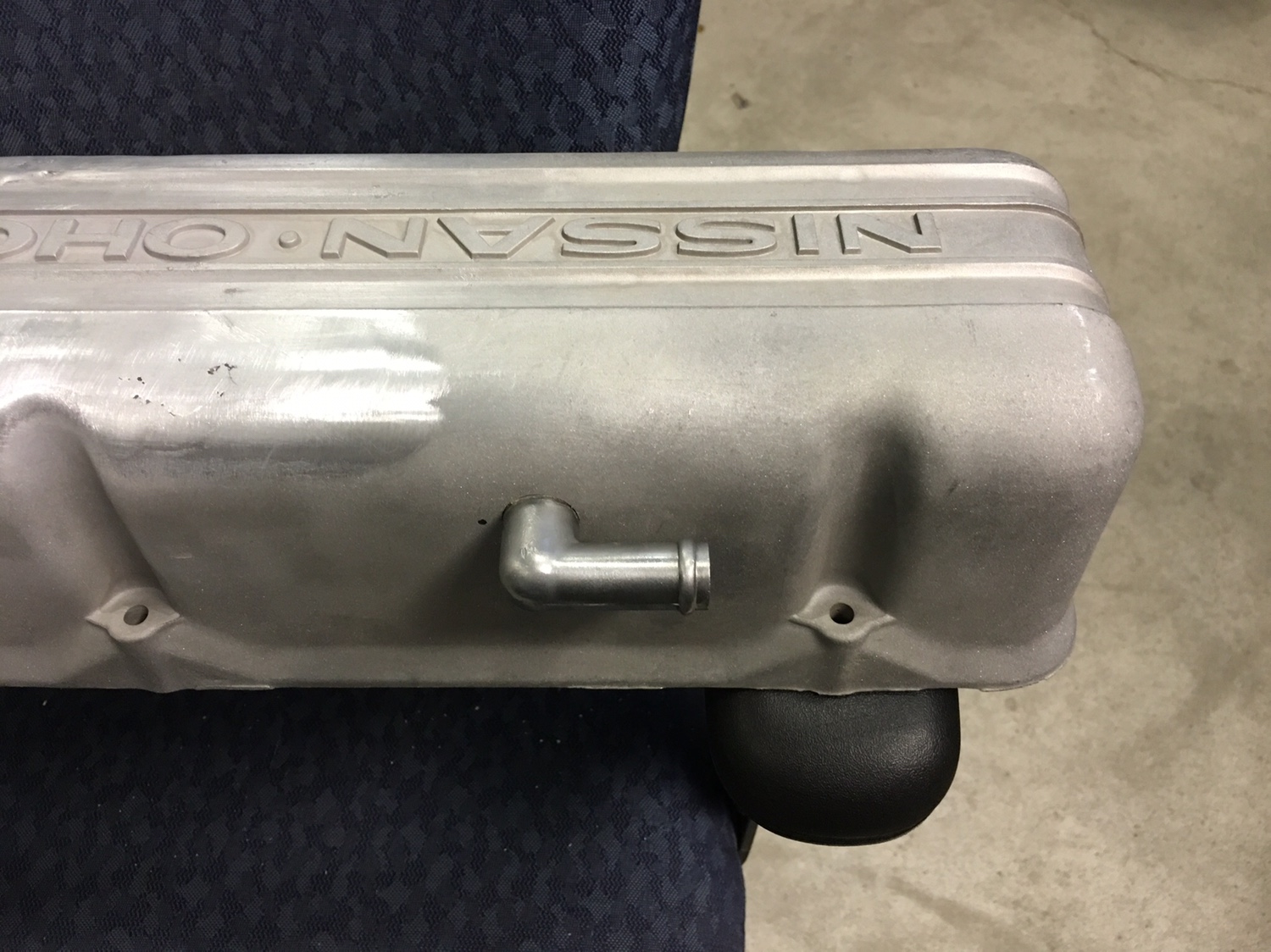

From what i understand in my searches, the thread for the valve cover breather is a bilok 1/2 NPT. Does anyone know where to source fittings for this? I'm looking to obtain a right-angle to 8AN fitting.

It would be easier to have an aluminum AN fitting welded to the end of the stock elbow than to source a Bi-lok fitting.
I've also discovered that you can run a 1/4NPT tap into the end of the stock elbow (not too far, it will split!) then get a $2 1/4NPTM to 8AN adapter.

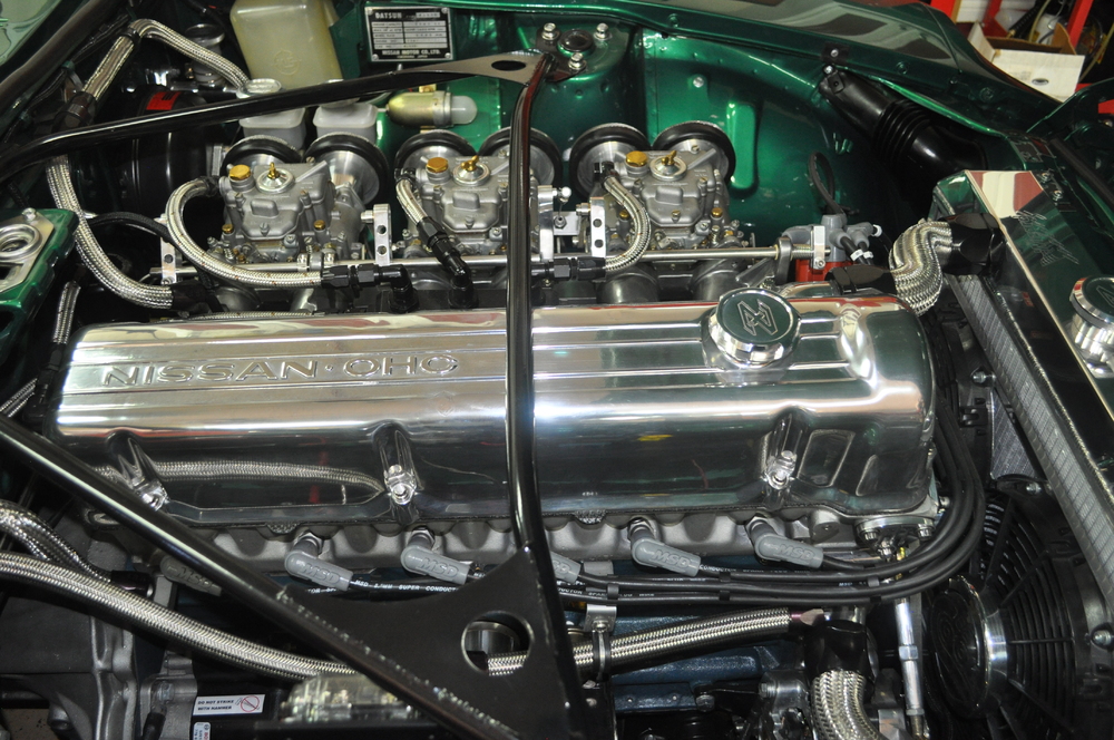

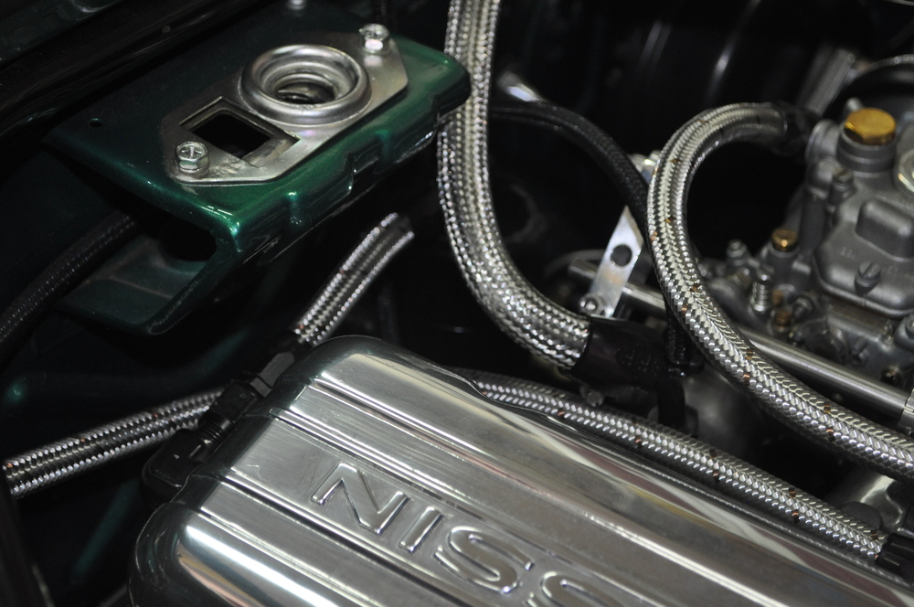

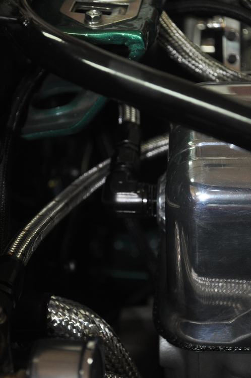

I've actually been through this as I wanted to install a catch can directly from the breather port and wanted to also us AN fittings.
I can tell you for sure that the original threads are not 1/2 NPT.  I purchased a 1/2 NPT right angle AN fitting and it was too big.  I ended up purchasing a 1/2 NPT tap and retapped the hole.  Was not a super hard effort and made for a nice solution in the end.
Since then I have actually had the breather hole welded over and smoothed out to the contours of the valve cover and welded in a 1/2 NPT bung in the very back of the valve cover and have attached my catch can there.  Makes for a cleaner and fairly unique installation.
I'm willing to bet the Bi-lok thread that is used is the tubing compression nut thread end. I searched a bit once trying to track down what that thread is, and about all I can remember it is a straight thread, and nothing common.

Mike W- lol, it's funny that you responded on this thread (thanks btw)!  I didn't realize you didn't know my nick on here! :) Anyhow, the 1/2 NPT tap and drill is what I may end up doing. I do really like the rear relocation though...those pictures don't do it justice. Seeing it in person is pretty schweet. I do still want to pursue the relocation but was thinking about saving that for another iteration...either way, that solution is my end goal at some point...it's just too clean.

I agree with you on the baffle plate and so we designed something that I believe will be more than sufficient in terms of preventing a significant amount of oil from being slung around and ultimately ending up in the catch can.
I removed the old baffle as it was no longer needed.  There are 2 bosses cast into the cover at the very end of the cover.  I drilled and tapped these so I had something to mount the new baffle to.  I fabricated a very simple L bracket out of some 3/32 aluminum stock and this new bracket actually "covers" the hole made by the newly welded in bung.  I then drilled about a dozen small holes in the bracket right around the area of the hole so it makes sort of a mesh filter.  I mounted the new baffle and secured it in the cover with red loctite.
So far so good.  No significant flow of oil from the cover into the catch can and everything else seems to be running fine.
