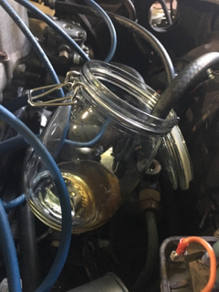

Hi guys, so this is what I've been able to find out this morning. Let's see if I manage to post some pics through this app.

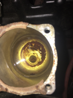

So I checked obe of the floater bowls (the other one was sealed with silicone and I didn't want to mess around with it). It did have fuel in it and also a bit of crud, although it didn't seem like a lot to me (you judge by the pic).
What I did see, is that the sealing on the floater bowl is rotted and broken (you can appreciate it in the pic), and I must say the car run a LOT worse after I put it back together. Could that actually be the source of my problem?

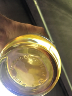

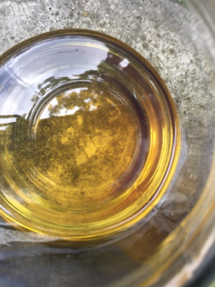

After that, I opened the fuel line after the pump and let it run into a jar to see if there is soot. I let it run for about 4 minutes I think it was, and this is the result.
As you can see, there is some stuff, although not as much as I would have thought. And it seemed to pump all the time without a problem.

It's called a "float" bowl because there's a float inside that moves up and down to seal the fuel inlet and maintain a certain fuel level.  A floater in a bowl is a whole different thing.
Your fuel direct from the tank doesn't look terrible.  There shouldn't be crud in the float bowl though.  A simple filter before the carbs should keep the fuel clean to the carbs.
Silicone on a carb float bowl is almost always bad.  It means somebody did a half-job.  You don't want any broken gaskets on the carbs either.  I'd get some new gaskets and clean and reset those carbs to spec. myself. then reinstall them with a good fuel filter to keep things clean.  Just for starters.

I don't think the broken cork gasket on the float bowl would cause any running problems just gas spilling or leaking out when you're driving.
