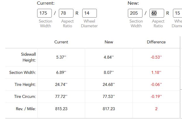

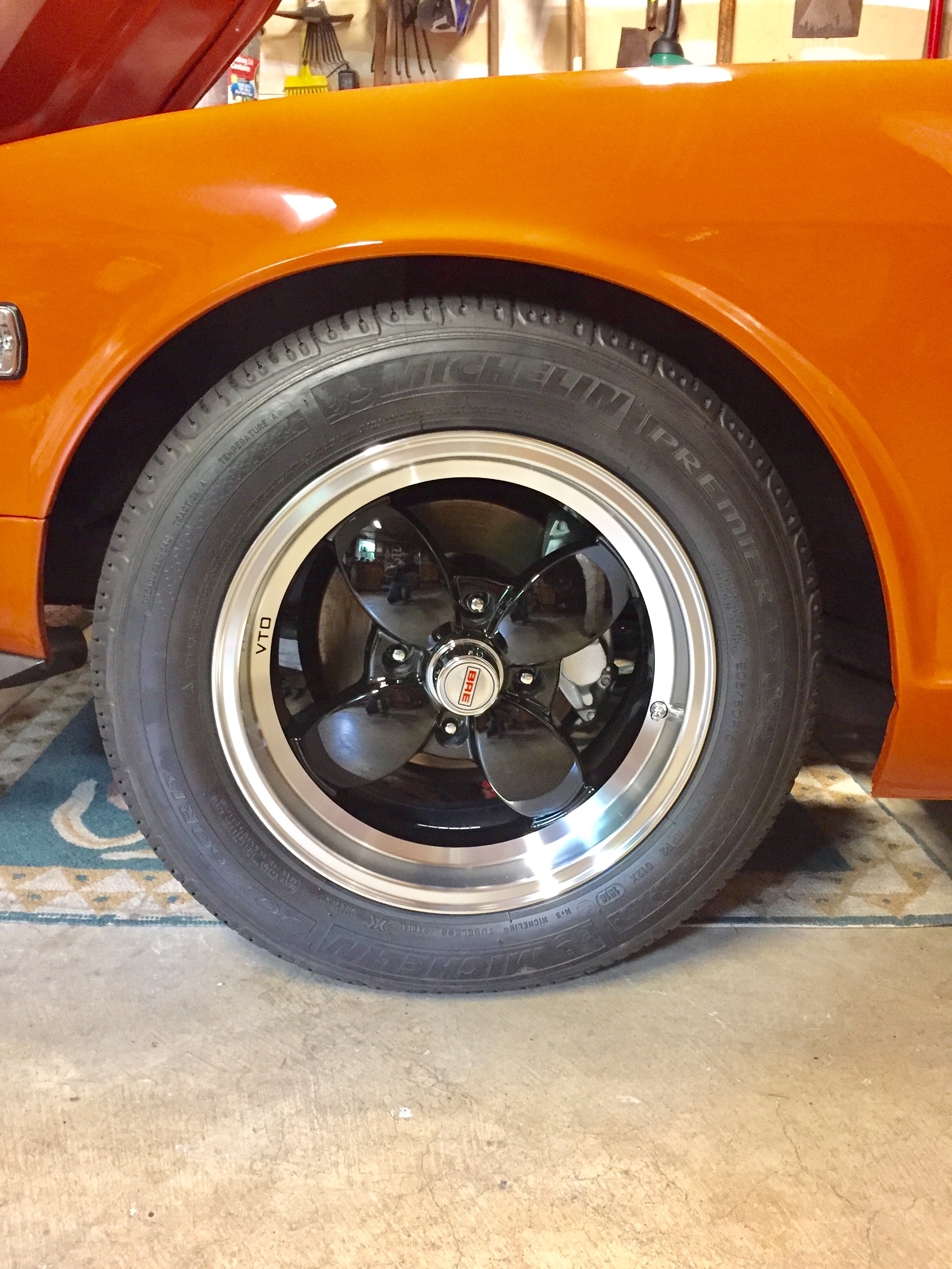

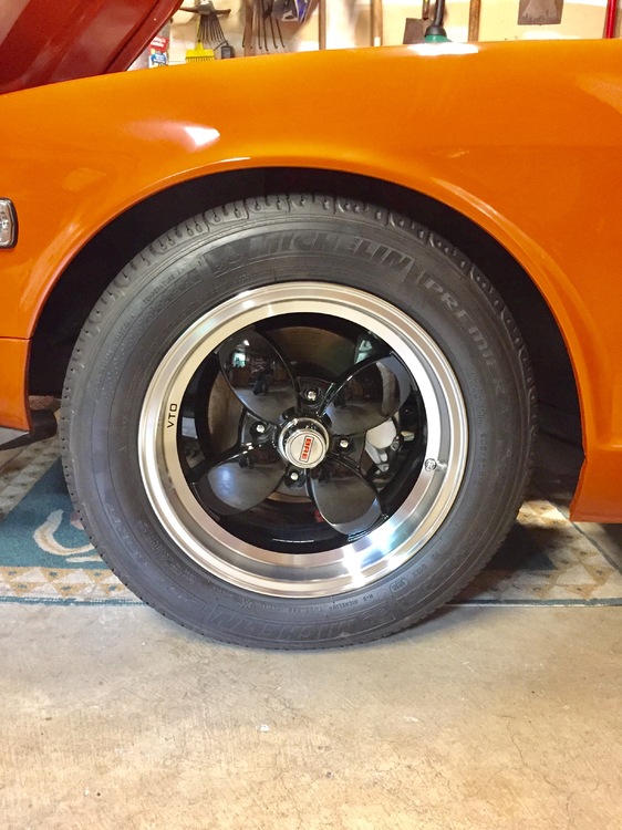

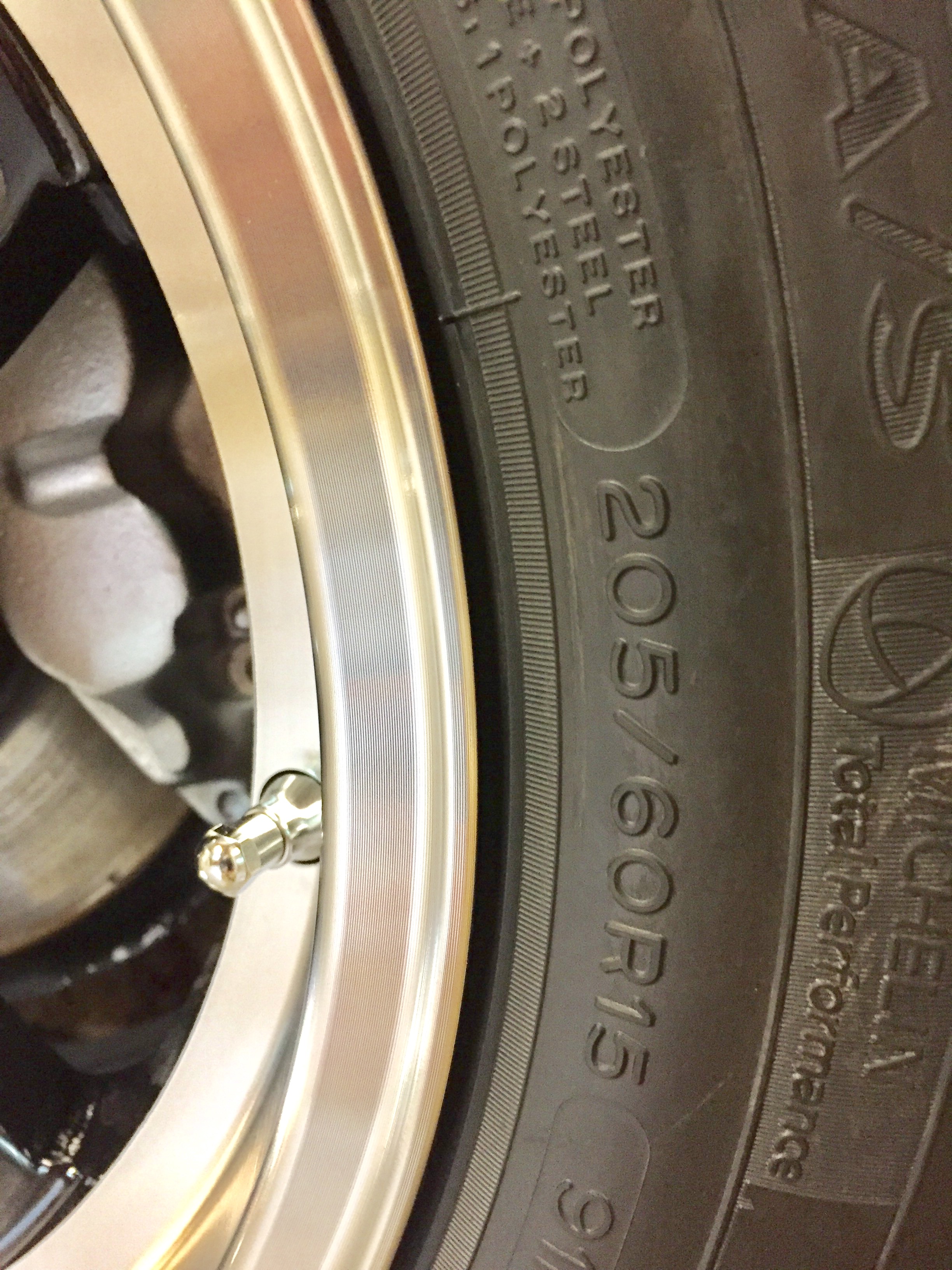

These are 205/60/15. This matches the stock tire height of the original wheels and tires so the speedo should register the correct speed.

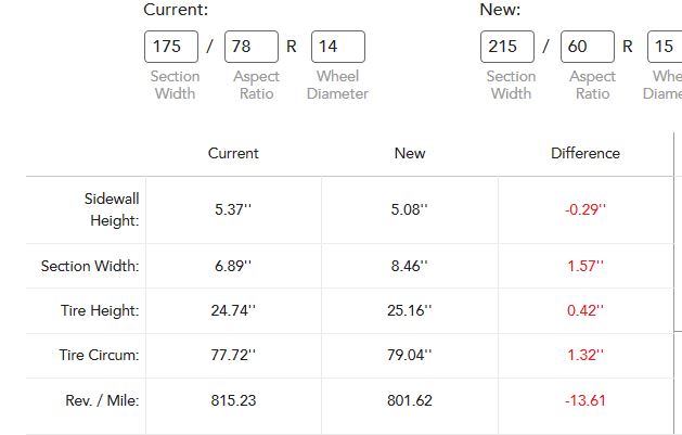

I have the original spare tire for my '71 240. It is a 175HR14, no sidewall size listed. It's my understanding that this tire is pretty much a 175/78/15, but who knows really. Based on that here's how I picked my equivalent wheel/tire size. This is from a tire equivalent calculator on the Discount tire web site;
https://www.discounttire.com/learn/tire-size-calculator
Here's your tire choice
Here's my tire choice
According to this my 205/60/15 is pretty darn close to the original tire size.
@moelk, Are you running 205/60/15 and if so did you have to do any speedo calibration for your speedo to show correctly? From your reply this isn't clear.

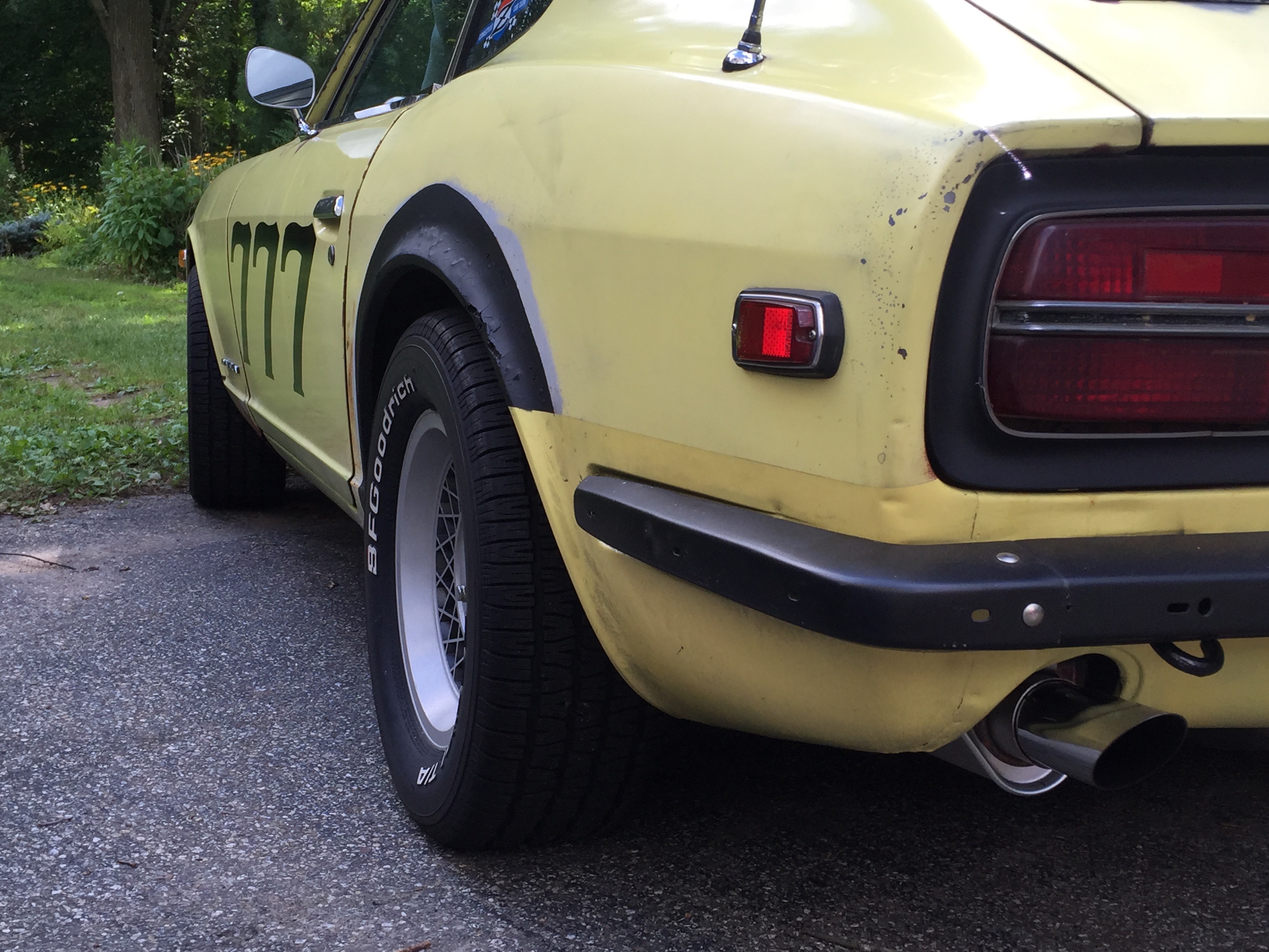

I'm running 225/60-14 on 6" wide vintage Appliance wheels.
It's the biggest 14" tire that matches OE diameter. They fill in the wells nicely and handle great compared to 195's.
