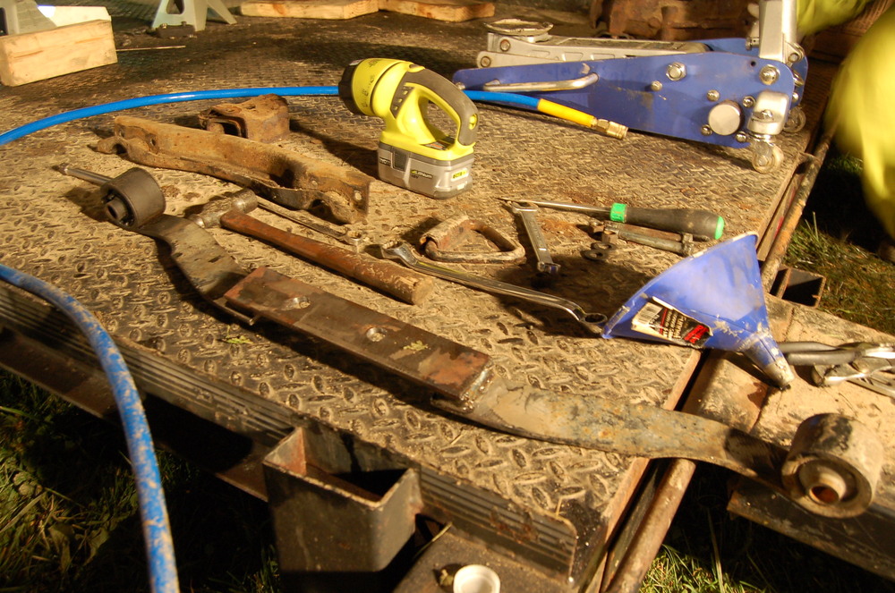

Nine years ago during my first 24 hour race with my 260Z, we broke the R180 diff and the only diff I could get my hands on mid-race was a R200.  With no R200 mustache bar handy, we modified the R180 mustache bar to fit the R200 diff.  This happened at 1am in the rain with practically no fabrication tools.  It wasn't easy, but we did get it mounted and got the Z back on the track.  Bottom line is that they are indeed very different, but ANYTHING can be made to fit with the right motivation.  ;)
