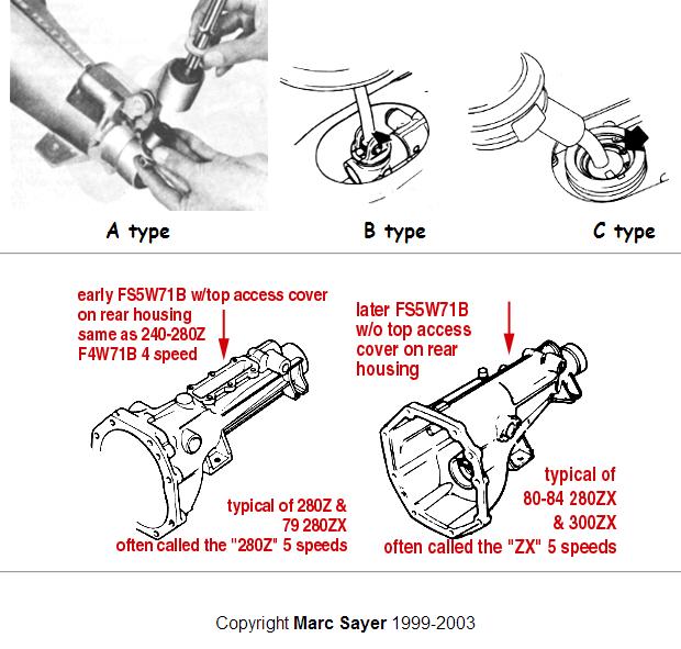

You have an F4W71A which is the original series 1 transmission. The selector can wear just like the F4W71B and FS5W71B, but the components aee a little different. That free movement you are feeling is what is making the chatter sound in second gear.
The problem you are experiencing is an accumulation of wear allowing things to more out of harnomy of each other and increacing frequency magnitude etc. This is a similar problem Nissan had with the 280Z and to cure it they bolted a huge block of metal to the diff mount cross member.
Your transmision has wear and that is now showing in second gear under load at certain revs (frequencies).
I would try to replace all the bushings and the two rubber cones in the selector. I'm not sure if that are available. Reduce the free play and it wil most probably cure your rattle. Have you tried removing the gear knob. That changes the momentum of the gear stick and can confirm that selector free play is a cause.

Have you tried changing the oil in the transmission. A member on this forum "Chickenman" recommends an oil from AC Delco or GM. The part numbers are AC DELCO USA part number is: 88900399. GM USA part number is: 12377916. I can not order the GM or AC delco oil here so I have no experience with it. I'm using Redline MT. Here is a thread on the oil subject.
Another thing you can try is increasing the pressure on the detent springs. There are three in the Adapter plate, but the one you need to look at is the 1st, 2nd selector detent spring. You can increase the tension by adding washers behind the spring. It's easy to do with the transmission in the car. This thread discusses the detents springs. His transmission was popping out of 3rd gear, but if the detents are loose they allow movement and transfer that movement to the selector stick.
They are all simple things to do and you can do it with the transmission still in the car and relatively low expense. I would try them before pulling the transmission out for a full rebuild.
