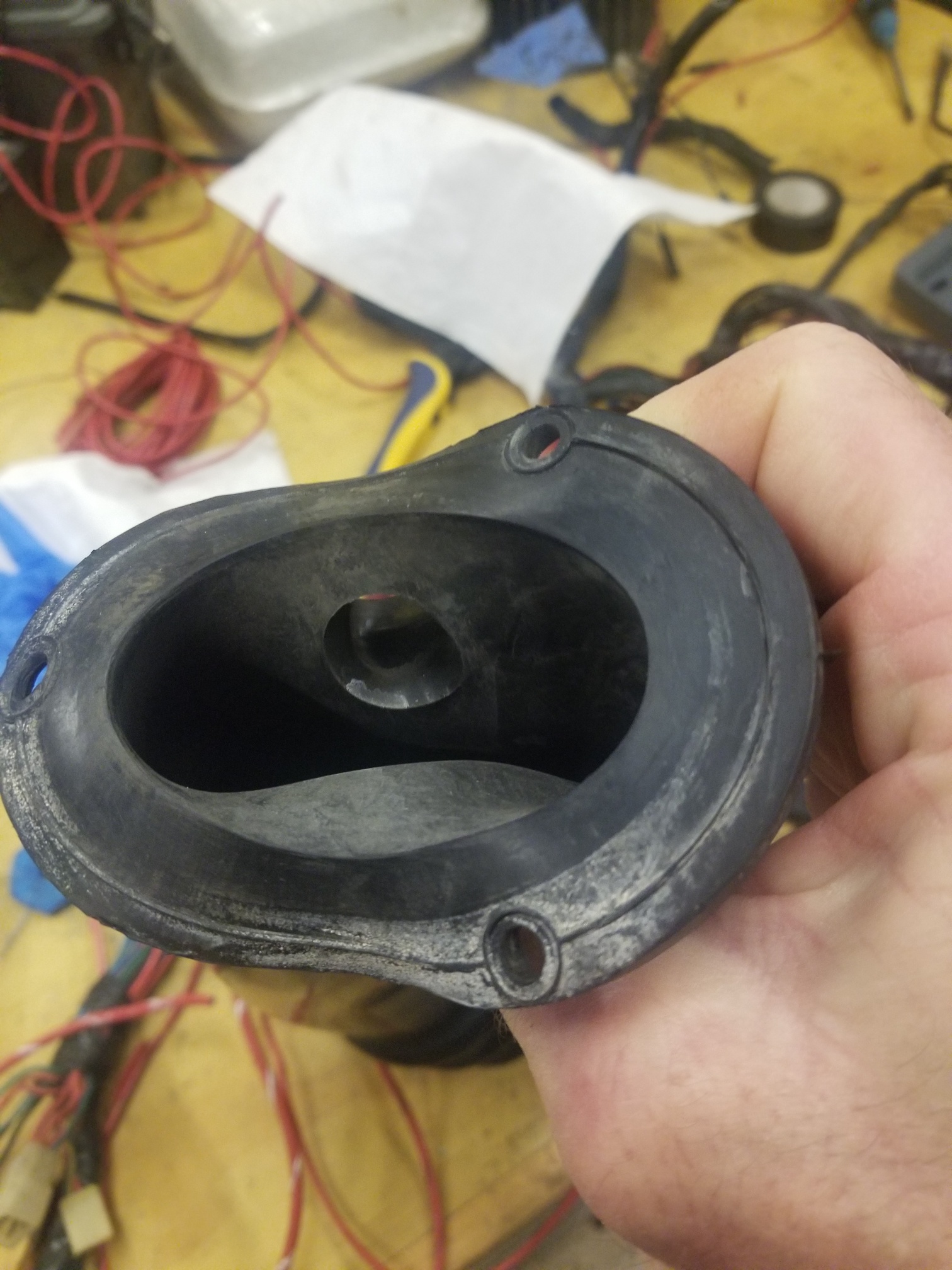

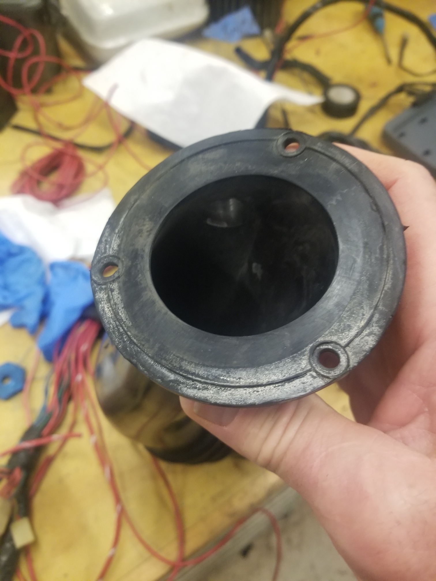

It has been over 10 years ago since I did this but as best as I can recall I installed the grommet and then fed the in-cabin connectors and wires through it one-by-one. No removal of connectors from the wires.
On 2/21/2023 at 1:59 PM, Namerow said:
I wonder whether they were able to install the wiring harness at the factory with the firewall grommet and end connectors already in place?  If so, I'd like to know how they did it.
YES, because it was new, and all soft and flexable😄

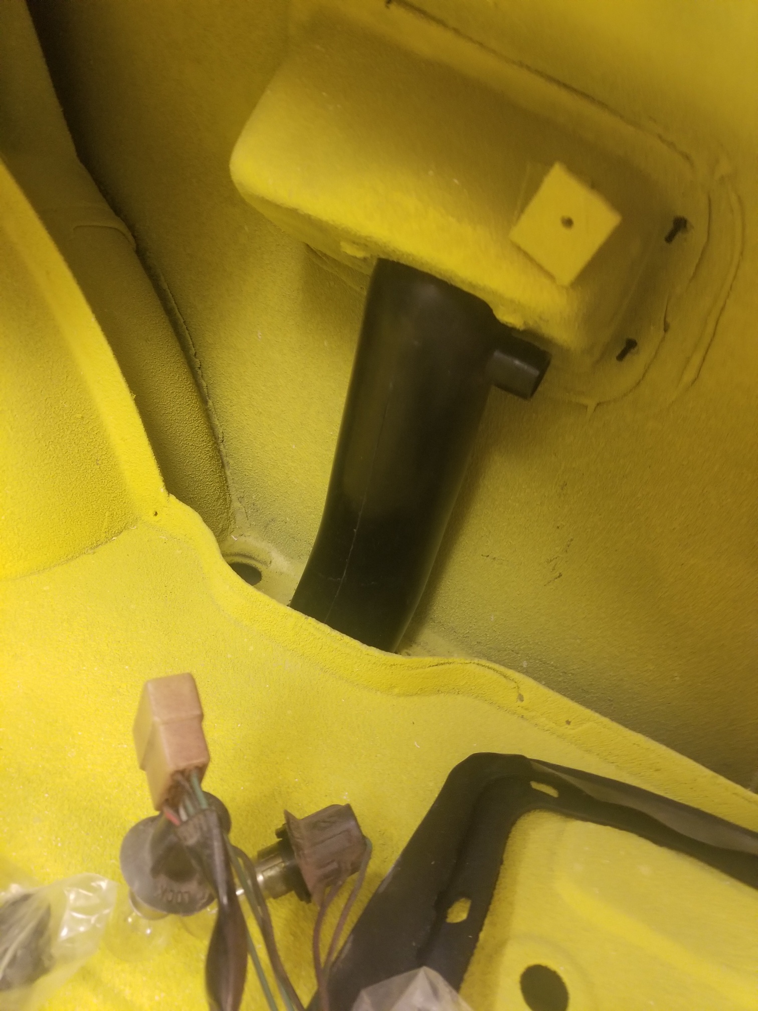

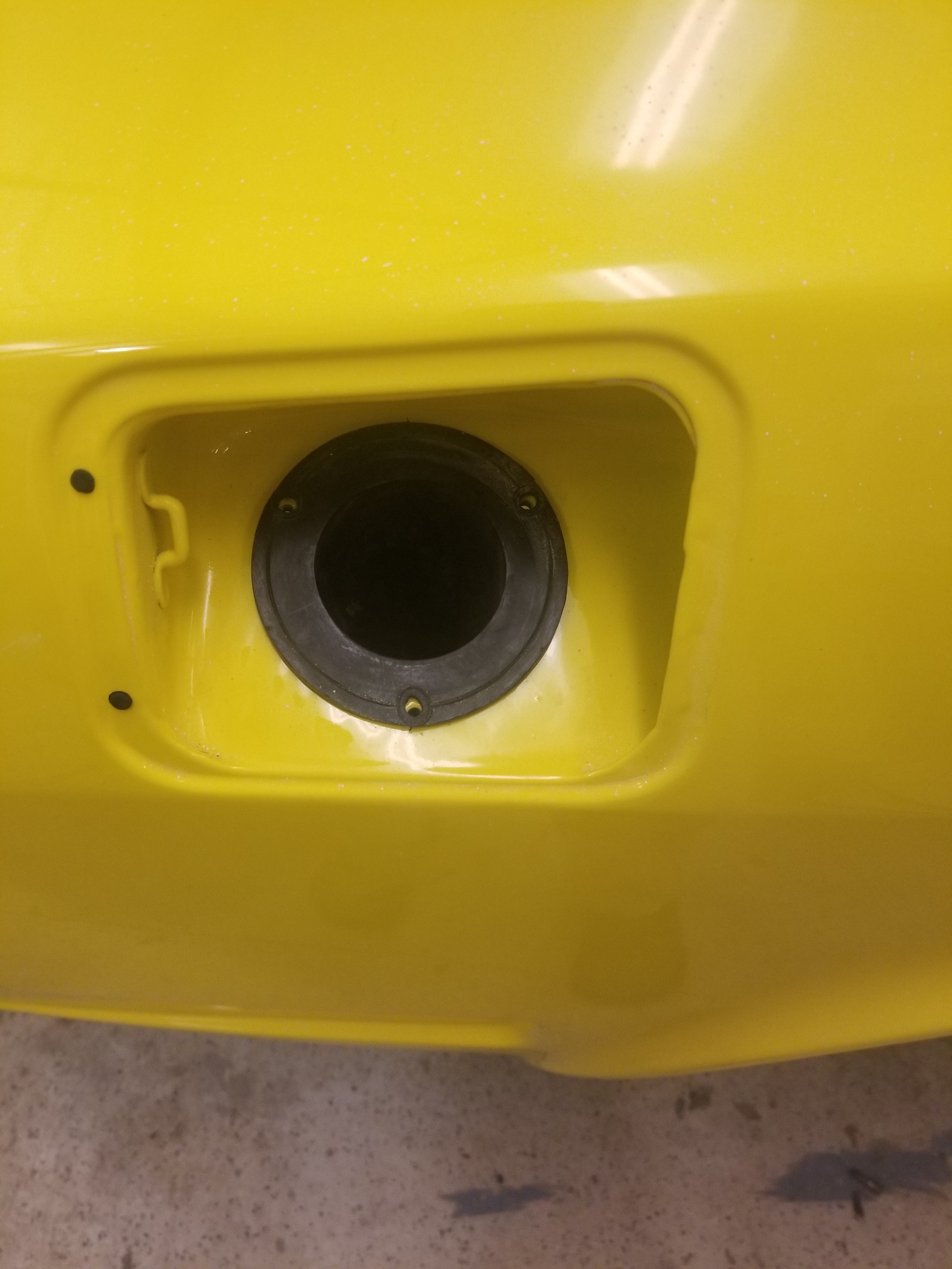

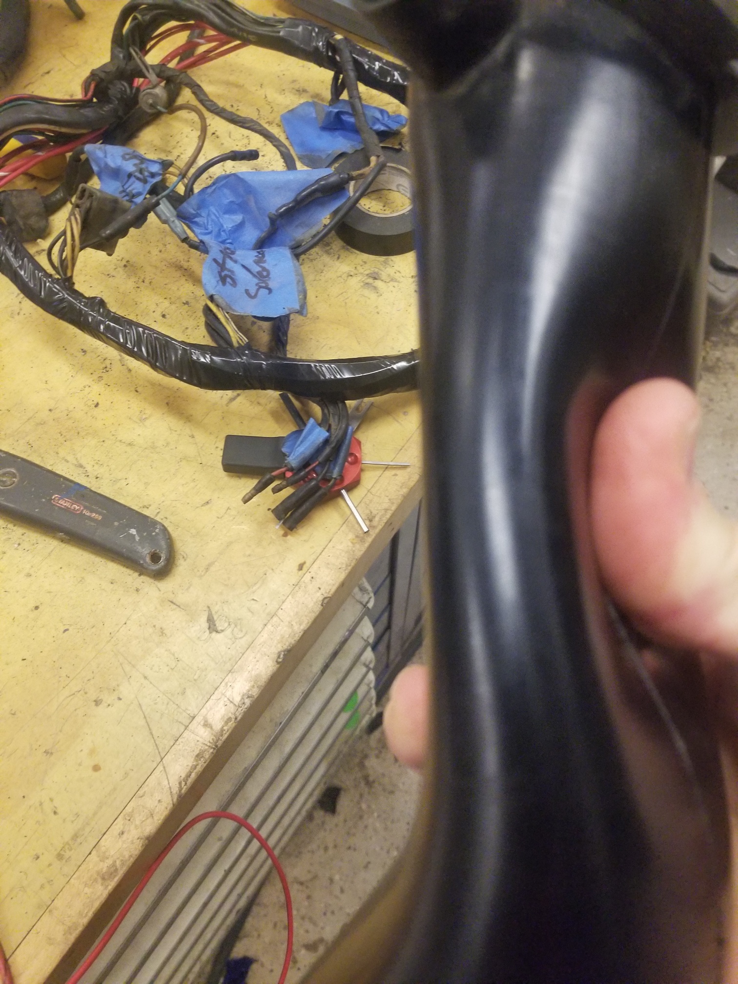

So I spent a little more time on the car today
I had this filler neck and it was stiff but not pliable. So I soaked it for about 36 hours. Made all the difference in the world. Really amazing...
Turns out it needs to be pretty pliable to get it installed

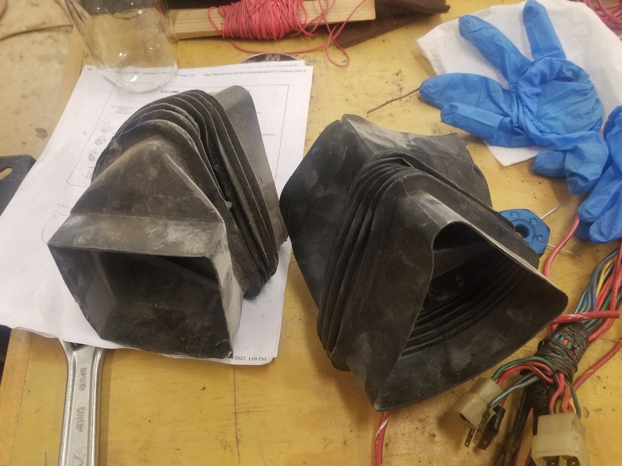

Who was looking for these?

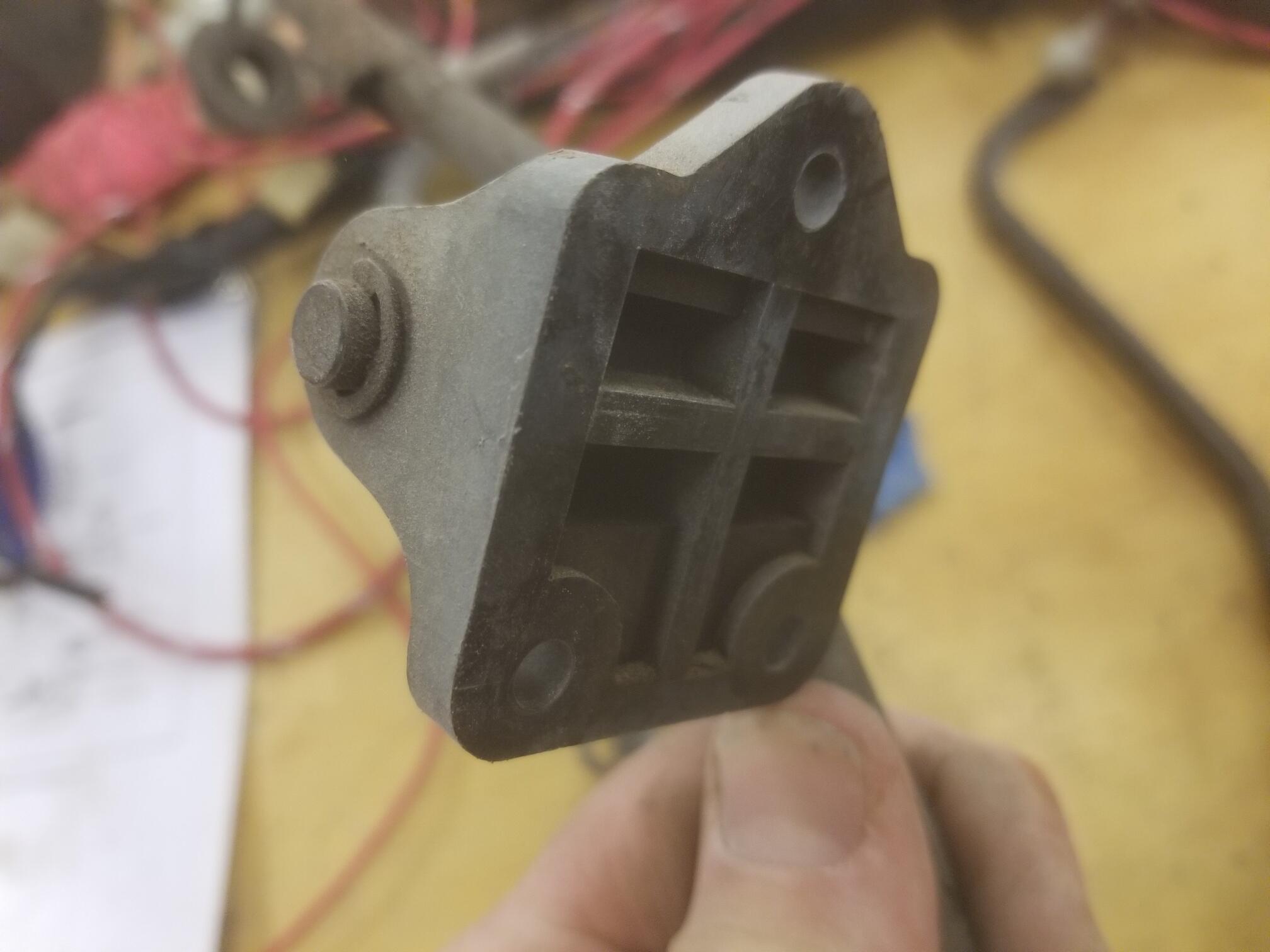

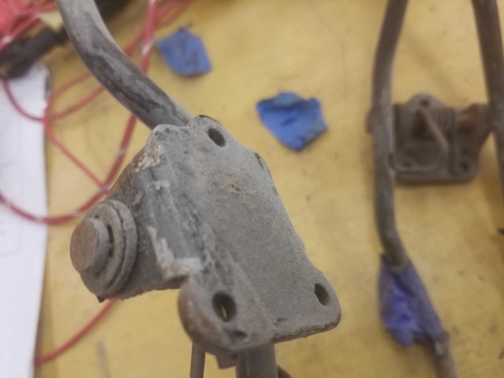

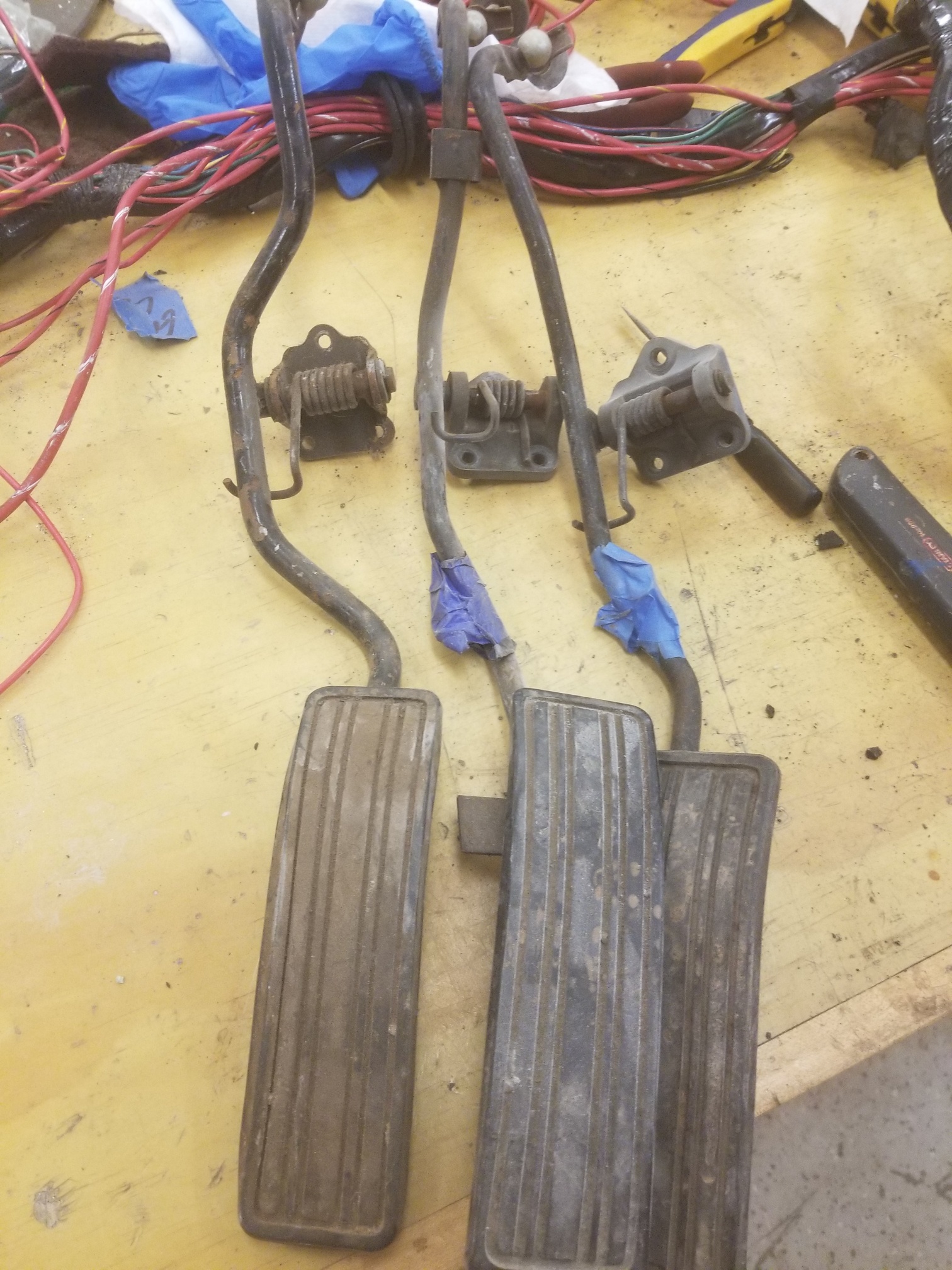

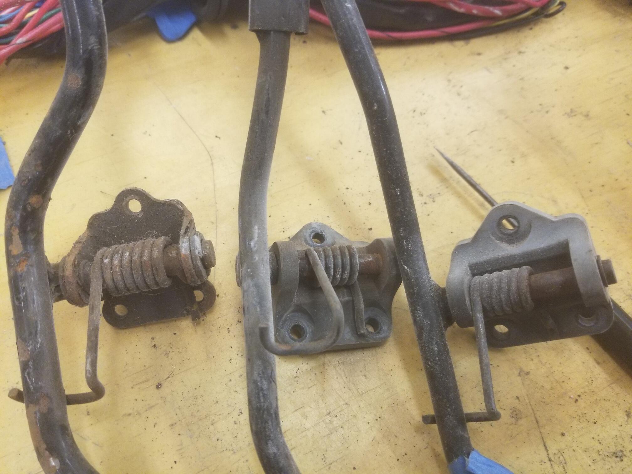

Also I have this selection of gas pedals:
Which was is correct for my 71?
2 have plastic pivots and one has a metal pivot. The one with the metal pivot is also shaped a little differently
