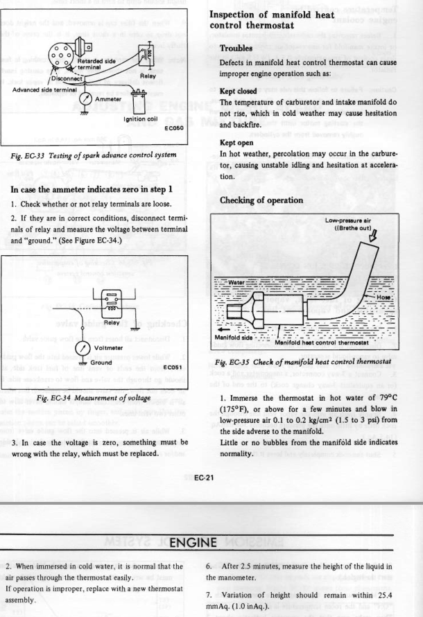

I looked back to where I found a drawing of the thermostat placement and find also that Nissan has a check procedure.  Made a copy.  It's in the 1972 FSM, page EC-21.  I didn't find anything in 1973 though, and the Parts Manual shows it as disappearing in June of 1972.  Maybe that's Build date.

Page EC-12 and Fig. EC-20 from the 72 FSM indicate that the operation of the manifold heat control thermostat are as you all have described above. It closes above 150* F.
Fig. EC-20 shows a section of the thermostat. It may be that there is a mistake in the section labeling as there is the possibility that #7 Adjusting Nut and #8 Case Cover have been transposed in the image or vice versa. If so, there may be some adjustment to the thermostat as mentioned by Namerow.

Cool.  I missed that one too.  Doesn't look like the "case cover" is threaded.  Looks crimped, so probably not unassemblable.

I agree it  probably can't be taken apart, but thought it interesting that there is an adjustment nut as Namerow suggested.

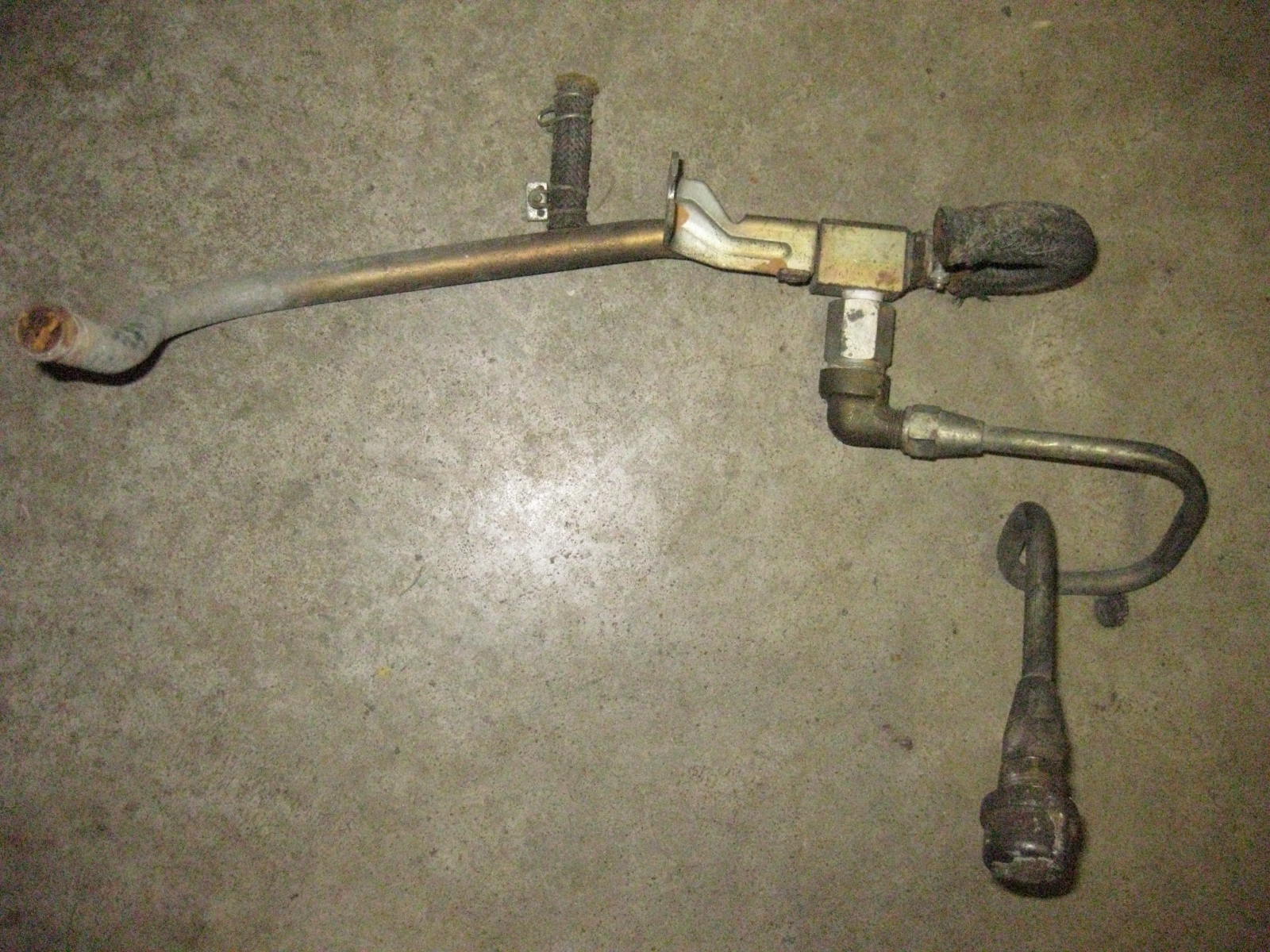

This photo is of the original rear manifold water pipe assembly from my 73.
IMG_0046.thumb.JPG.fcc1c957bf37057e4fa8e
IMG_0048.thumb.JPG.09e337466e62c2cab01a2
I may be wrong, but I think the location of the manifold heater thermostat was moved to the rear manifold water pipe and the term for the device was changed to "Water Control  Valve". I'm pretty sure it is the silver hex sided piece in the photo above. (I know many will think that this is just a bunch of discarded plumbing pipe, but the only part that is NOT supposed to be there is the iron pipe cap at the end that the PO placed on it when he had this mess removed from the car in a conversion to  downdraft Weber carbs)
The "Water Control Valve" is  shown in the 73 FSM section EC-1 as #9.

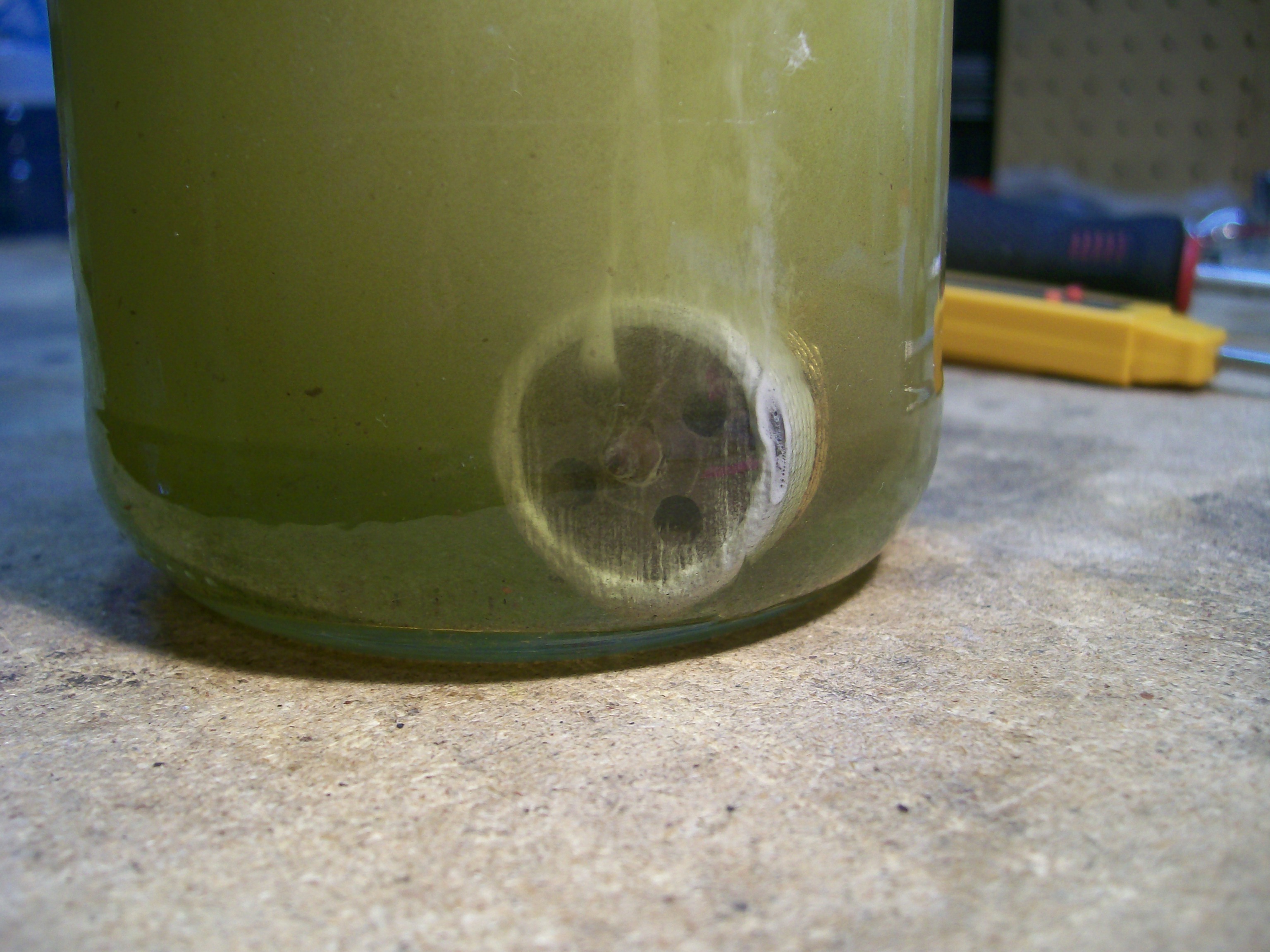

  • I've got my thermostat soaking in CLR now.  There was a lot of 'action' right off the bat, so my suspicion about mineral build-up might be correct.  We'll have to wait to see, though, whether it frees up the workings.

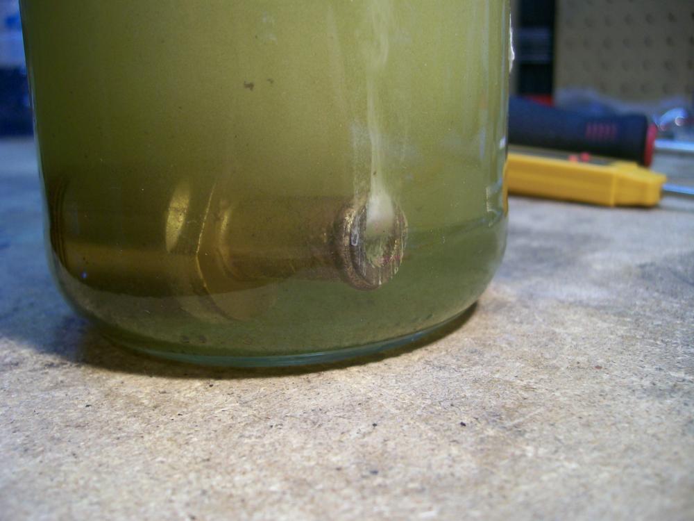

Well, I'm afraid that the C-L-R 'de-liming' didn't work :(.  I soaked the T-stat main assembly for about 4 hours.  The bubbling action was strong and constant... so much so that it began to occur to me that the stuff might be dissolving something other than just mineral deposits (like brass, maybe).
Anyway, I pulled the valve out of the C-L-R and repeated the 'blow test' (per the FSM-recommended procedure).  Used boiling water fresh from the kettle (showed as 195 degrees F, although immersing the valve probably dropped it to 180 - 185).  I sucked up the water into the valve -- to ensure that the pellet was actually seeing the hot water -- and then waited for over three minutes to see if the valve would close.
No joy.
After this, I removed the hose that I'd connected to the valve and then clamped the valve housing in my bench vise so that the outlet port (i.e. hose end) was facing up.  With my inspection light, I could clearly see the tip of the tip of the pellet shaft, c/w the little E-clip on the end.  Using a small pin punch, I tried lightly tapping on the end of the shaft to see if it would show signs of movement.  Nothing.
Then I tried pushing down as hard as I could on the pin punch to see if I could move the shaft back against the internal spring.  Still nothing.
So I'm at an impasse here.  Non-functioning part that's locked in the undesirable position (i.e. always open, meaning that hot coolant will always be flowing through the intake manifold passages, even when the engine is up to temperature).  Don't know if it's seized, out of adjustment, dead, or all three.
As you can see from the third picture, the little lock nut and adjuster stem are tiny and both appear to be made of brass (i.e. fragile).  They also look like they're firmly attached to one another, so I'm reluctant to put a wrench on the nut to see if it will turn.  I'm even more reluctant to put a screwdriver in that itty-bitty slot to see if the 'adjuster' will turn.  Also, I'm not even sure how the adjustment works (I think that turning the screw may just move the whole pellet/shaft/valve downwards towards the valve seat).
