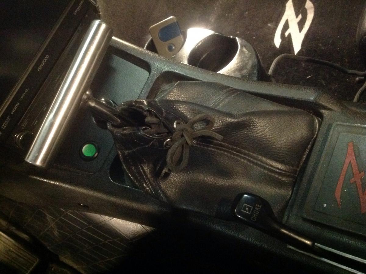

Couple weekend's ago, I had the console out (unrelated project), and somehow I decided it was time to try yet another "improvement" of changing my gearshift knob style. I've always wanted to try a "T" type handle, so out came the shift lever from the tranny.
Well guess what I found. A damaged plastic pin bushing, on the right side.kinda crushed. Still there, but not in good shape. I did notice my shifter was SLIGHTLY sloppier than before, but not enough to make me go looking.
Well, I proceed with my T shifter mod, (fodder for yet another post), replace that bad pin bushing and put it all back together.
Natch, I had to take it for a drive to try out the shifter feel. Off I go merrily banging gears with a big grin on my face. It wasn't until I was bombing down the local freeway did a lightbulb finally go off and I says to myself, "Hey! where the hell did that gear whine go? The trans is totally silent!!!!
So what changed? Well two things. The bushing of course, but also the length, shape and mass of the shifter rod. Apparently the noises that the trans makes ALL THE TIME was getting transmitted to the shifter rod with that bad bushing. Now with a good set of plastic bushings and a different rod shape and reasonant frequency, the thing is now quiet.
Who'da thunk it? Anybody change their pin bushings to some solid metal ones notice any increase in tranny noise after doing that?

Alrighty then, its settled. Who would like a big icy cold shiny piece of stainless steel welded to the top of their gear shift lever? Only trick is mounting it to the tranny and getting it through the three shift boots.... It can be done.
I have all sorts of internal transmission shafts that can easily be turned in serious shift T knobs..... This one is 5/8 diameter and 4.5 long.
