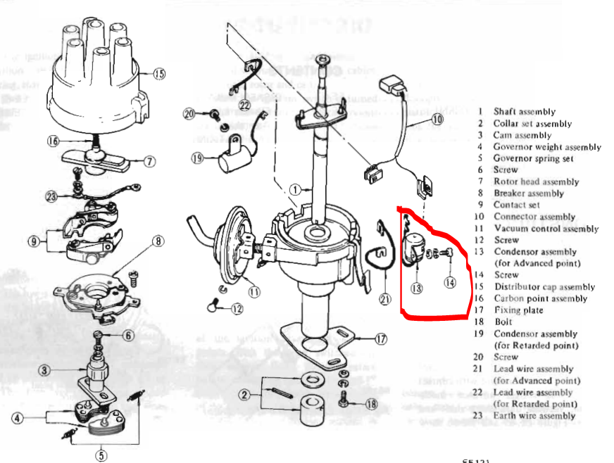

Hey!  Isn't the condenser you're talking about, that stops arcing, usually mounted on the side of the distributor?  Could still be bad and a new one probably won't hurt.  I remember from Chevy world that the condenser was actually mounted on the points assembly.  The distributors were bigger I think and it all fit under the cap.
post-19298-0-09666500-1431298841_thumb.p
I am assuming from the diagram that I should only have one set of points and only one condenser, because I believe I only have one set of points

Seriously though. If your points are visibly arcing, I suspect your condenser is toast.

The points were sparking when you cranked the car but I should have suspected scorching sooner
There should be a MINIMAL spark " at the points " when you open them. If you have a medium to large spark at the points when you open them, then it is likely that the distributor condenser is shot. The condenser is mounted on the side of the distributor. It had two purposes:
1: It absorbs the electrical current when the points open, so that the points don't arc. Arcing will rapidly burn and pit the points.
2: The condenser causes the magnetic field in the coil to collapse much faster when the points open. This cause a BIG increase in Secondary current.  If the condenser is weak ( or missing ) , the Magnetic field collapses slower and you will have a very weak spark at the plugs.
The points condenser should be replaced every time you replace the points.
Note: When you go to install new points, drag a piece of clean white paper between the points first. Do it a couple of times till the paper comes out clean. New points usually have an anti-corrosion coating on them, to prevent corrosion during storage. This coating must be wiped clean before installation, or you can " burn " the points. It's actually the oil coating that burns.

Thanks for the tip. That may be what was scorched on the points. I believe the condenser was replaced when I had the shop work on it a while back. The points look fairly new. I will probably replace it anyway as they are very cheap.
