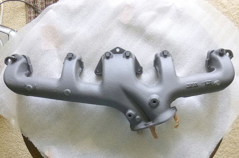

I bead blast mine to metal and have them ceramic coated. If you don't want to spend the $$$$ for ceramic coating, bead blast and paint with VHT.

Did a powder coater do that for you?
Yes, there is a Company that does powder and ceramic coating about 20 miles from me.
After getting it back and looking it over, I thought why didn't I grind off all the casting edges
if going this far? It would not have taken too long. Too late now.
