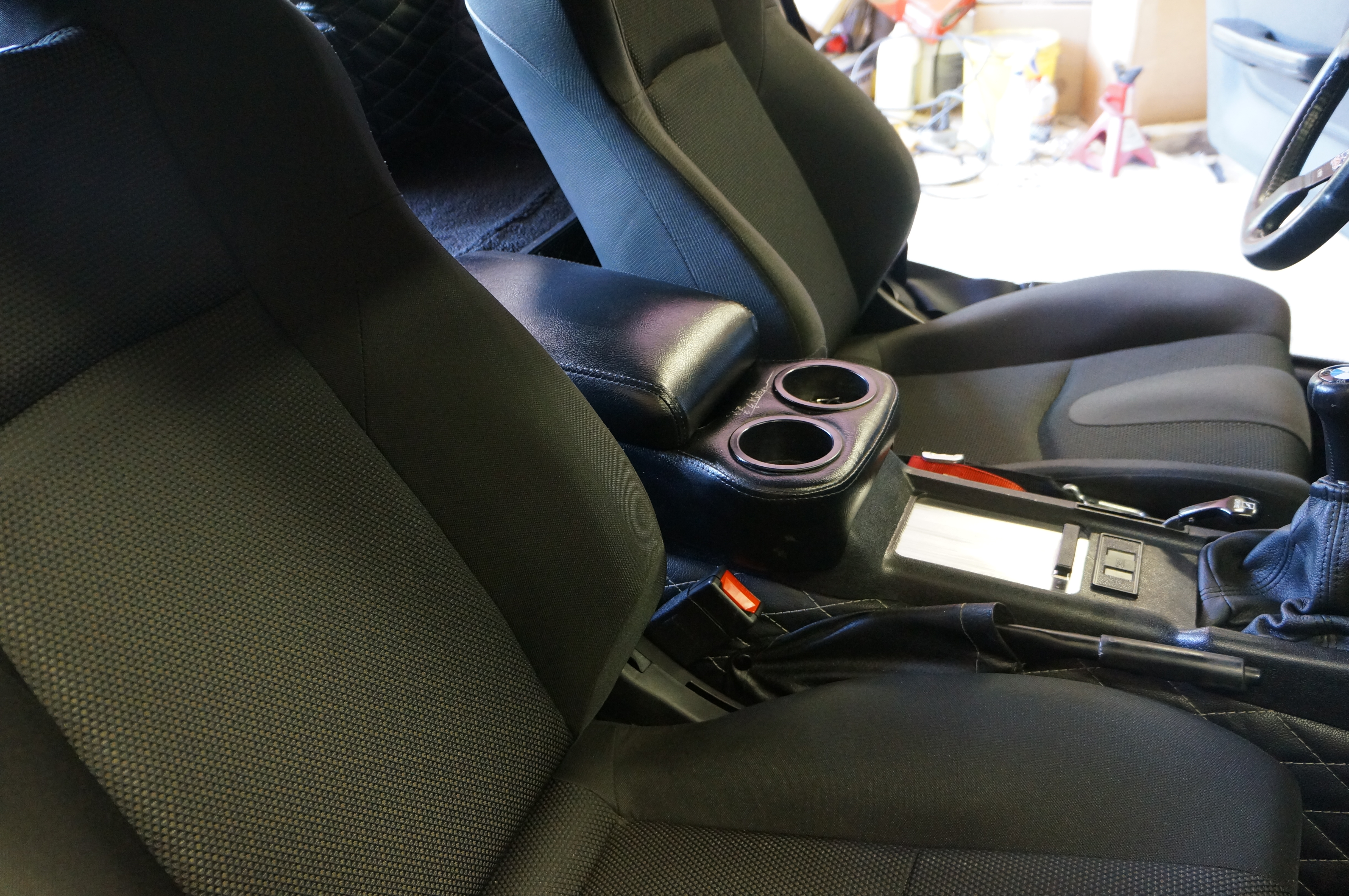

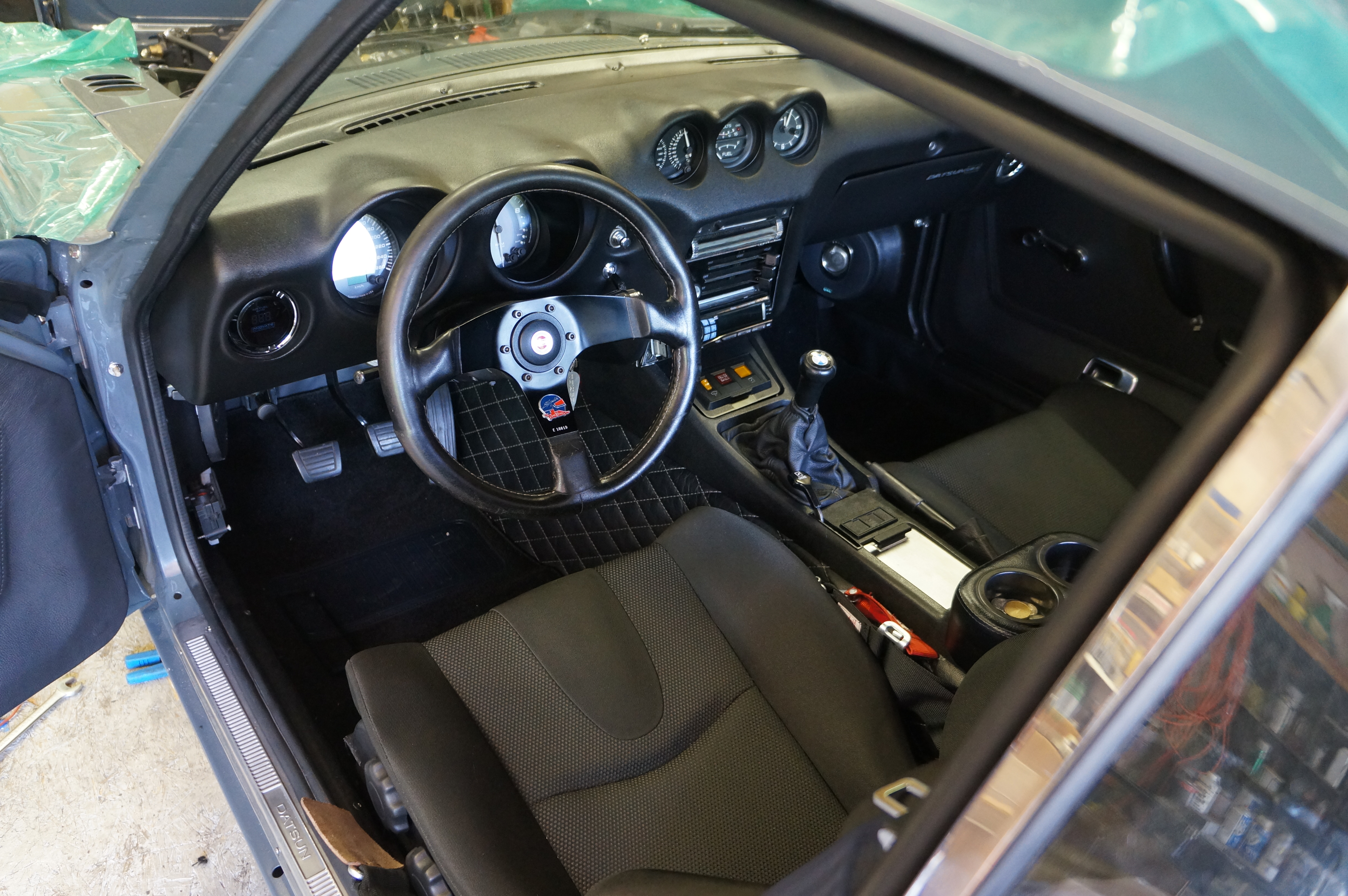

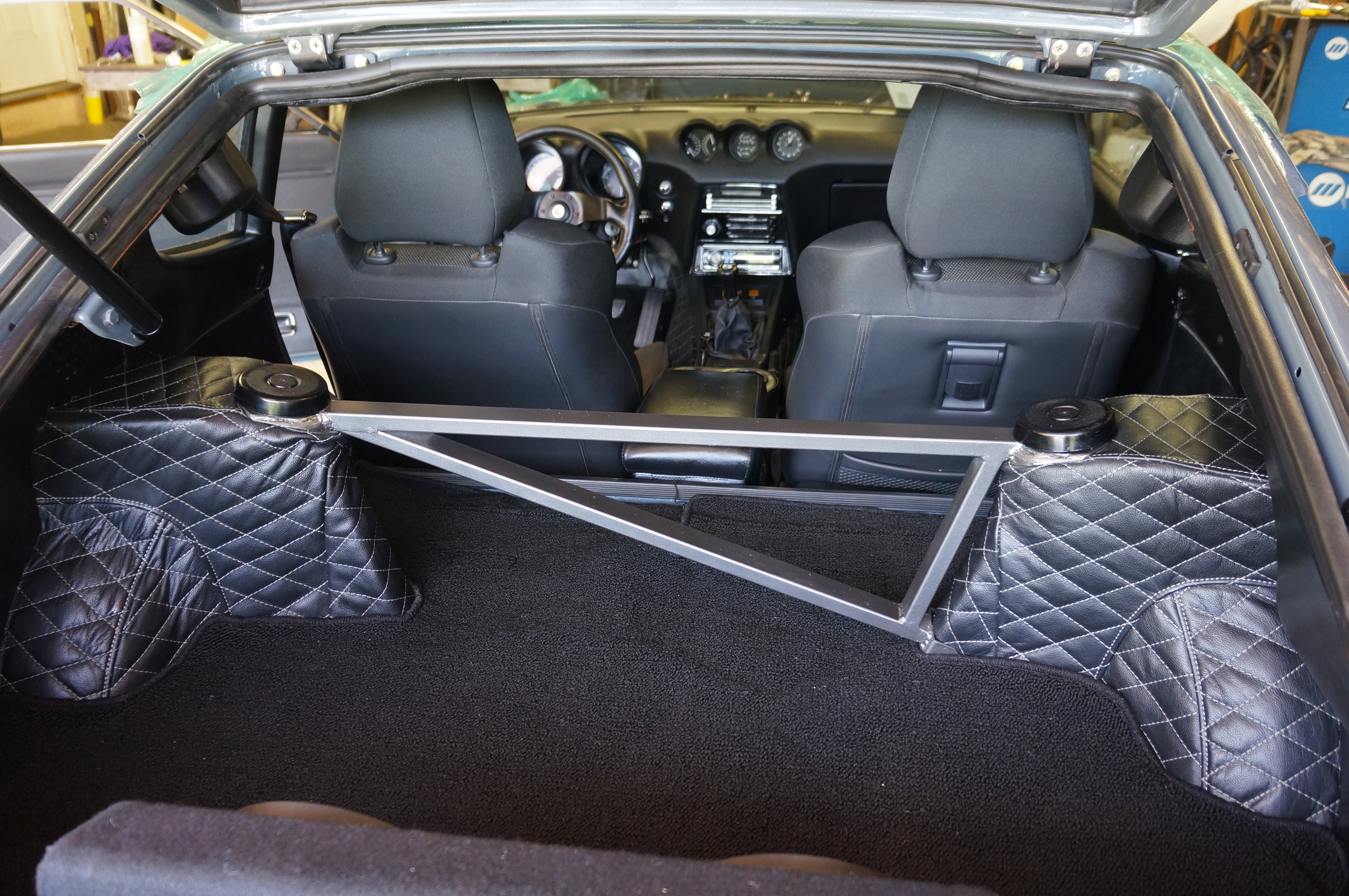

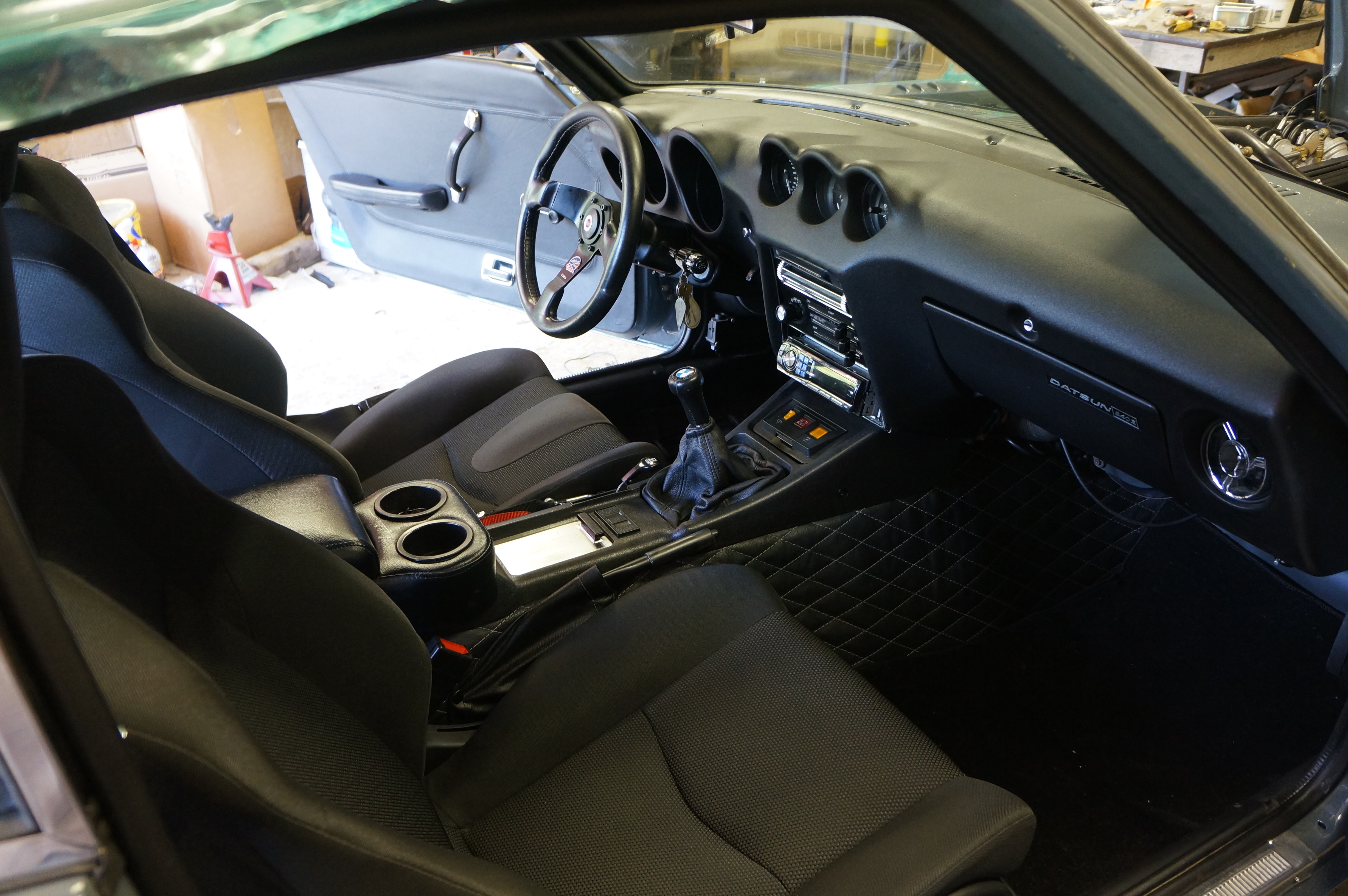

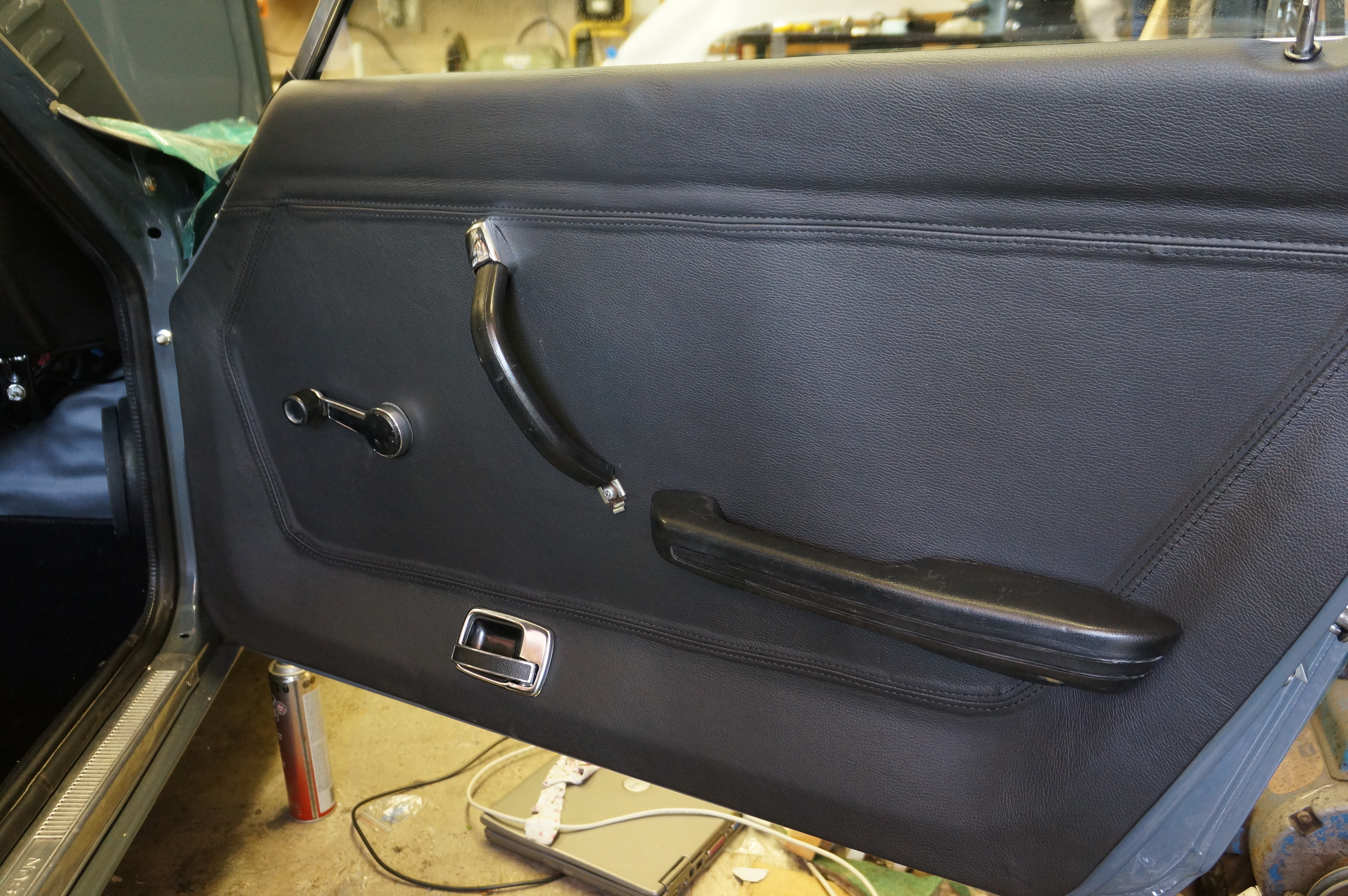

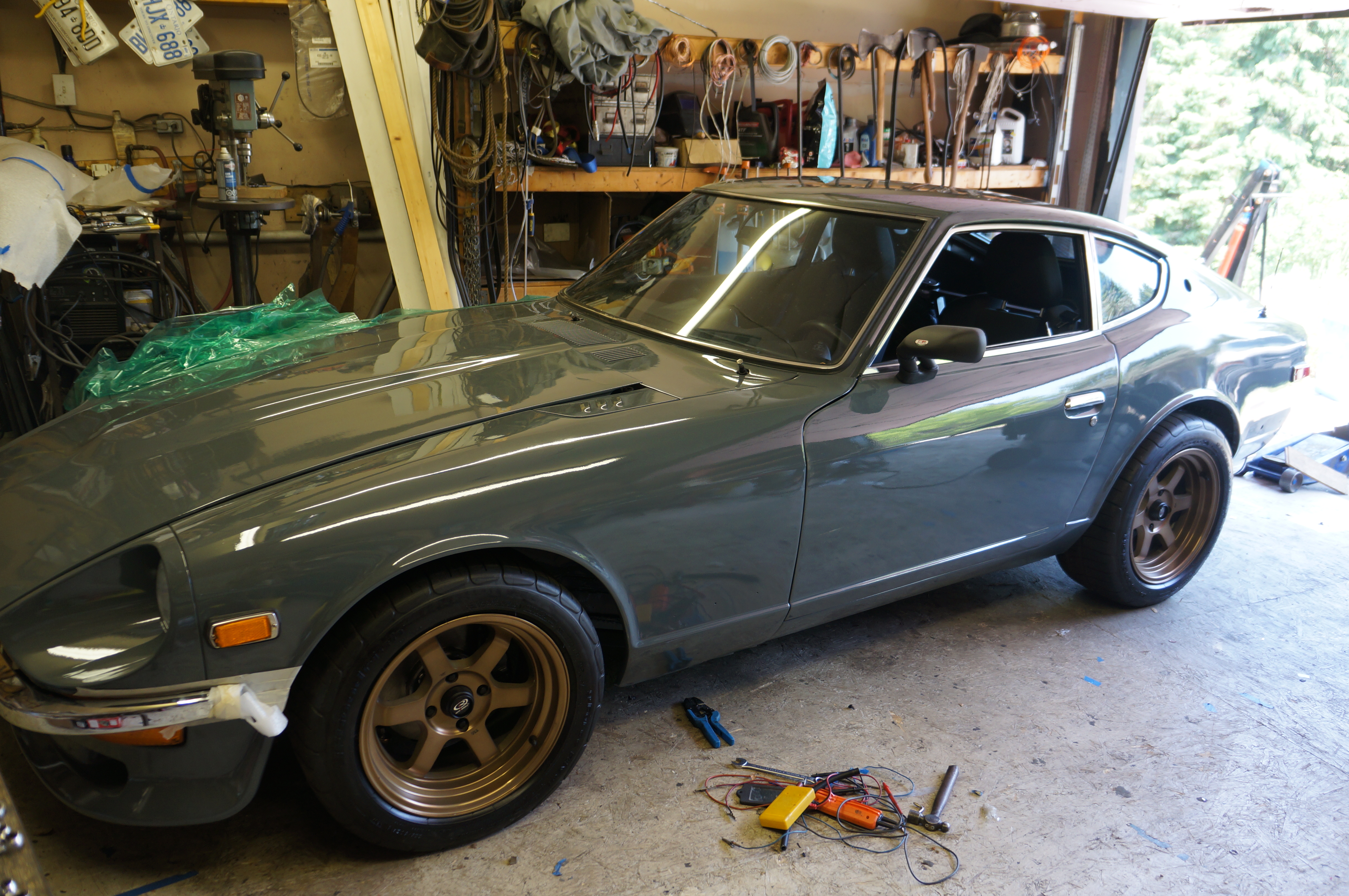

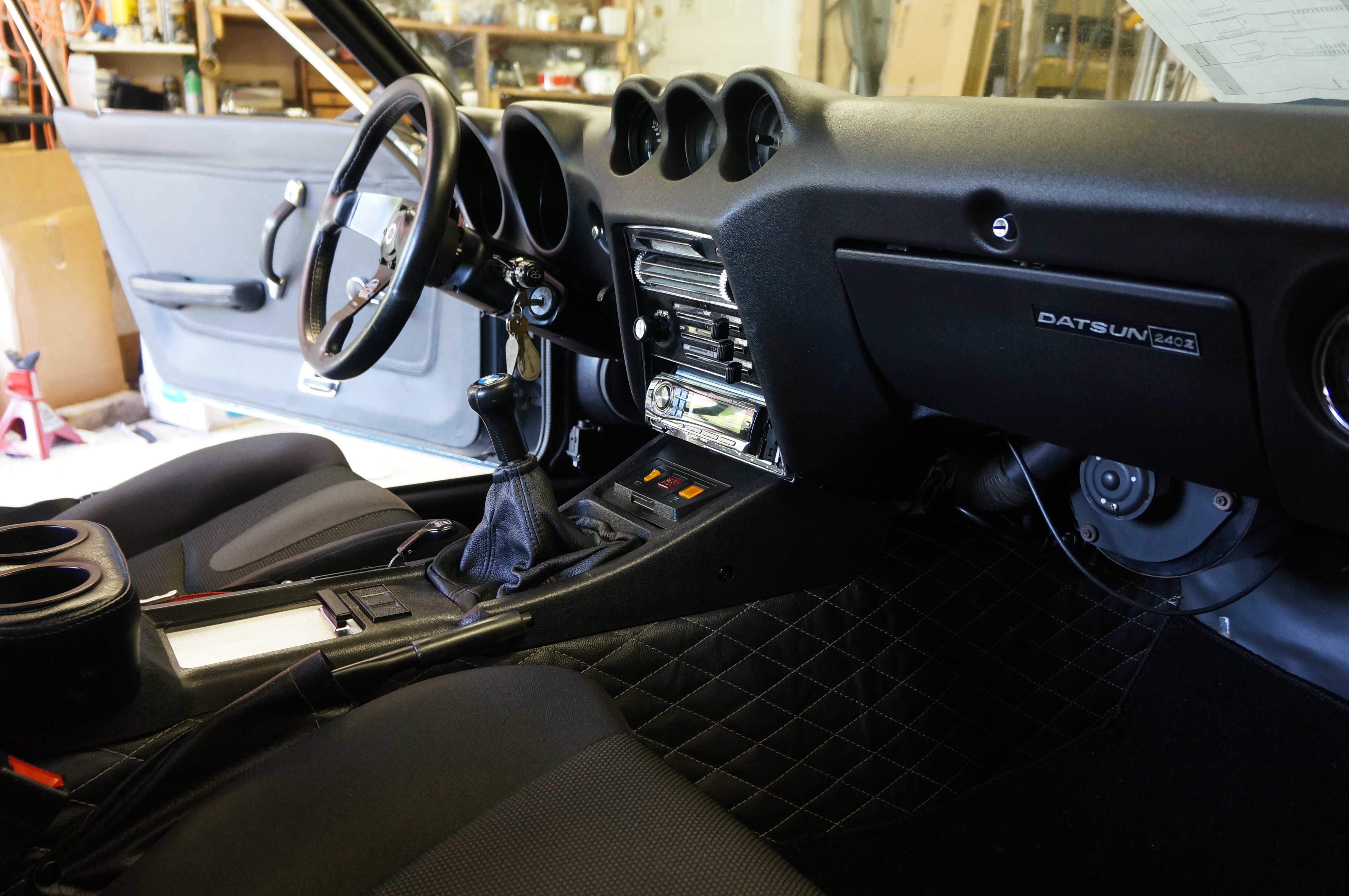

Well, getting down to it, finished the interior today, still missing a pull knob and a chrome cap but it is pretty much done. Matt is coming to tune the megasquirt tomorrow morning, I get the safety certificate on Tuesday and hopefully licenced that afternoon. Then I get to start slowly driving it around to see if all my steering mods worked and of course then back up to Jody so he can buff out the paint.
I borrowed my wife's good camera to get some better shots than the old shop cam is capable of.DSC02815.JPGDSC02817.JPGDSC02818.JPGDSC02819.JPGDSC02820.JPGDSC02821.JPGDSC02825.JPGDSC02829.JPG

strut tower bar looks pretty neat! i like it. i like ittttttttttt.
how are those plug-n-chug cup holders? I know the one for the Z31 300ZX has the cup holders on the rear, not at the front. I wonder if it would be more like an elbow holder with the seating position of most Z chassis with it at the front.

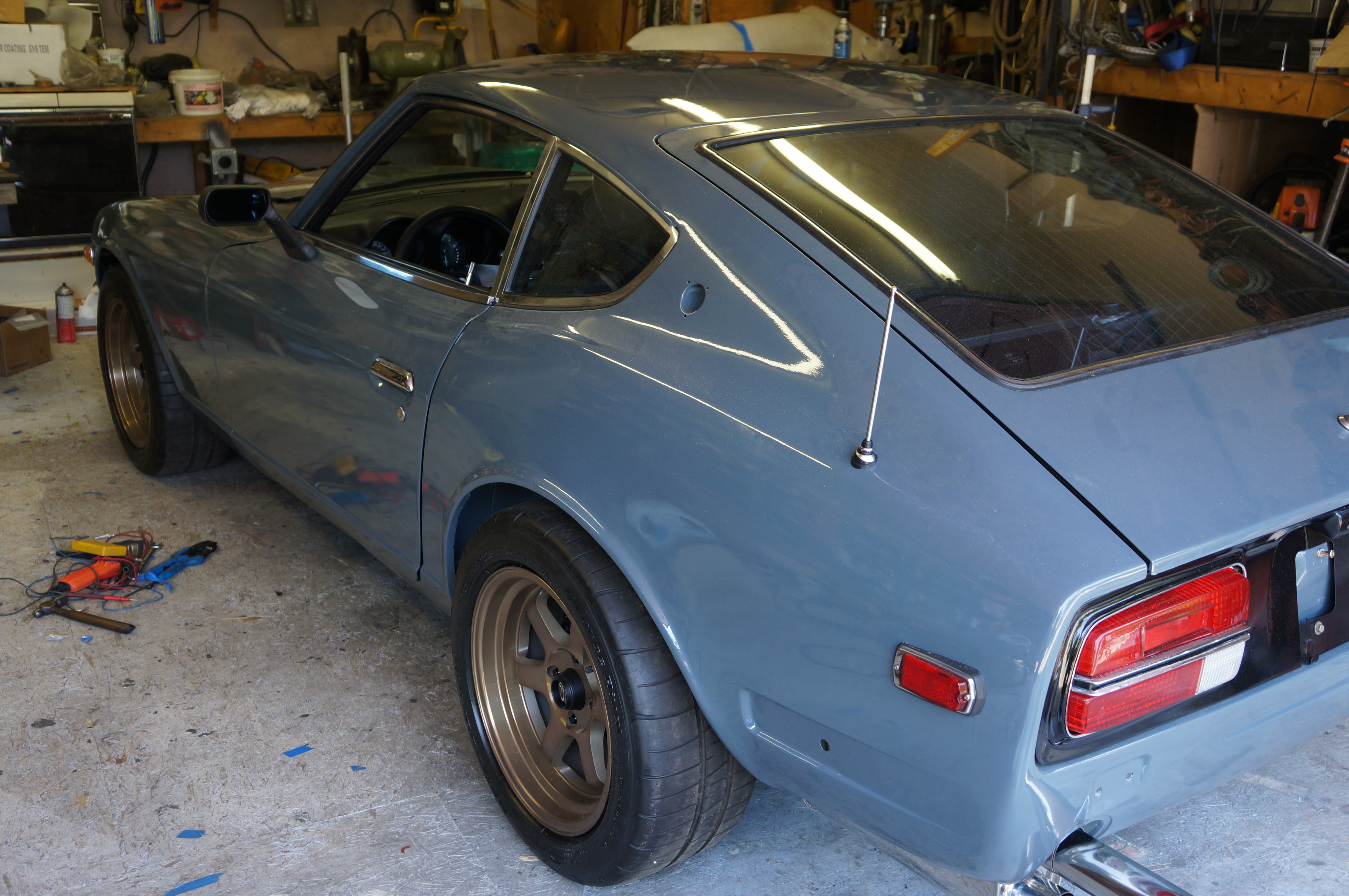

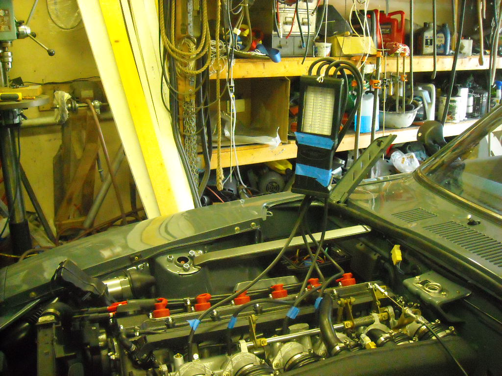

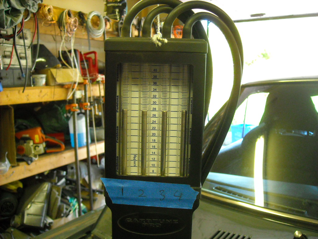

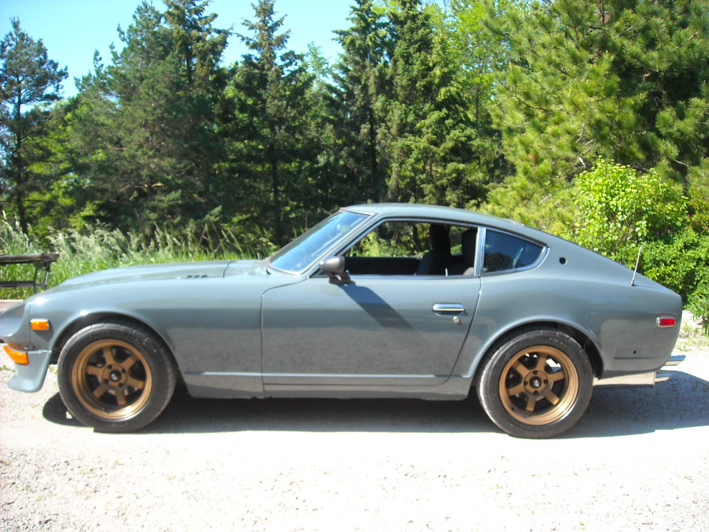

She is on the road! first time in about 20 yrs, Matt tuned it from idle to about 3200 rpm so I'm trying not to push it too hard until I can get down to his shop this week and finish the tune on the highway. Got the TB's balanced using my old motorcycle manometer, evened out TB 123 and 4 then pulled the tubes from 1&2 and put the on 5&6 and balanced them with 3&4.
DSCN1568.JPGDSCN1570.JPGDSCN1569.JPGI'm leaving as much outside trim and badging off until Jody gets the cut & buff done at the end of the month.
Years ago I read somewhere that you must do a second torquing of the wheel nuts after a few miles when you have installed new wheel studs, that came flooding back into my head after I heard some clicking happening on the front wheels, I was only a mile from home so headed back. Two nuts were loose and all the rest of them needed re torquing:blink:
That's one of the reasons I never let myself get too far from home when shaking out the bugs, I had a list of 8 things to work on before I even got out of the driveway. But the thing I have been most concerned about was the 1.75" drop of the steering rack, that the car wasn't going to have that great handling anymore, very pleased to report that the TTT off set tie rods and the bumpsteer spacers did the trick, the handling is spot on, nothing strange, it all feels very familiar.
No bad sounds coming from the LSD OBX rear end and I did lay a little patch just to make sure both tires were leaving rubber on the road, the braking isn't as good as I hoped for but there is still room for tweaking. So far it is feeling very good, very much like the old Z but a lot more power and NO squeaks, pretty sure that is the stitch welding.
