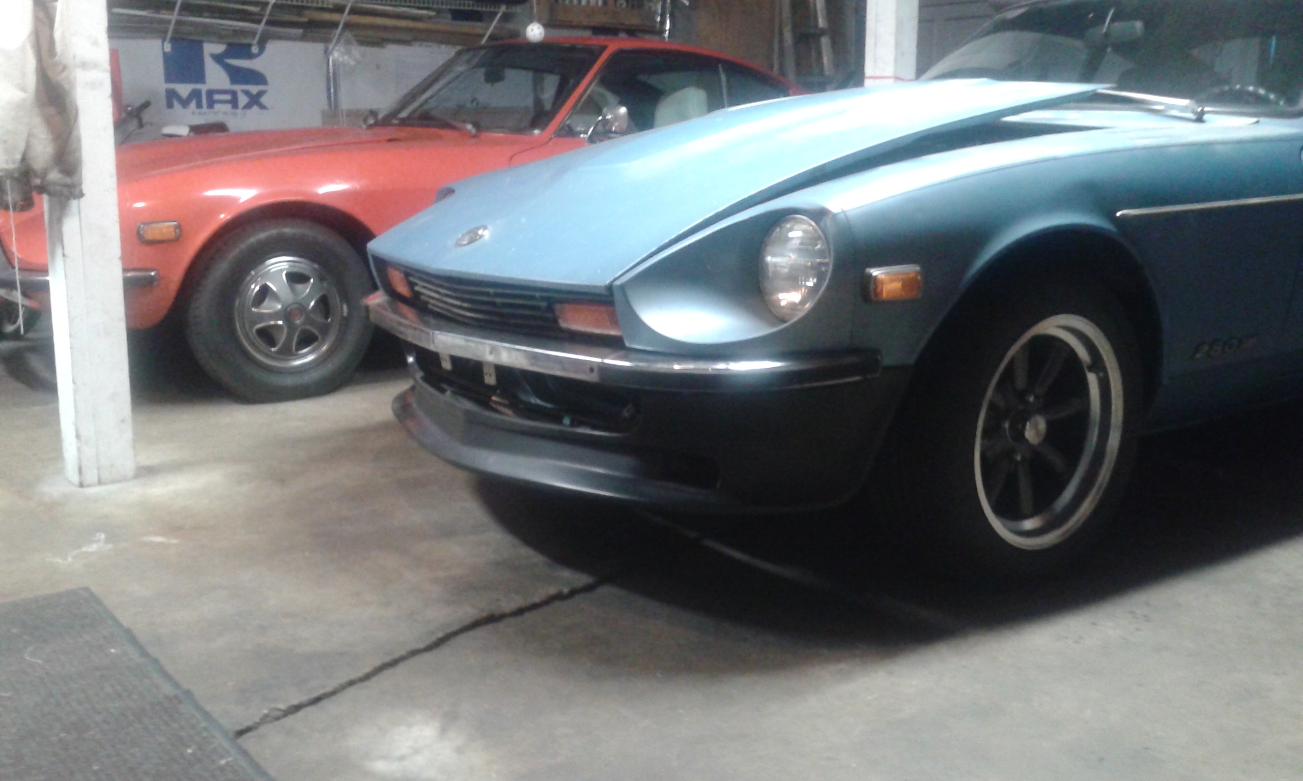

Looks like he's already got an airdam. What he really needs is a proper splitter and a rear spoiler. Something like this is what I'm referring to if you're not familiar: http://skillard.com/products/240z-260z-280z-front-lip-splitter
Beyond that, it would help if he closed up the radiator/grill opening to direct air to only the radiator, and to allow in only as much air as is needed. There is information on this in the Aero section of HybridZ that I think would be worth a read if you'd like to know more.

What about the Xenon front air damn? It sucks my 280 down.
I'm kinda disappointed with that Xenon airdam, without addtional support it doesn't do much but bend. I would like to get one of these, S30-240z-260z-front-spoiler.jpgThey are in Australia and so far I can't get them to respond to an email, shipping would be a killer which is probably why they are not responding.
Skillard has done a very nice job on that splitter but because my steering rack has been lowered I would have to modify it to fit so I will have a go at building my own if I don't hear back from Topstage.
@rturbo 930, yes I have been through that aero section on Hybridz, fascinating stuff, I would like to correct the problem by conventional means first if I can, that gaping maw at the front might not be very aerodynamic but it does look great and I don't want to mess with the beautiful lines of the car too much. But I will have to get a rear spoiler not only for the down force but the exhaust fumes are killing me. During the resto I sealed every possible opening at the back of the car and I have the muffler tips extending way beyond the bumper and I'm still getting gassed with exhaust with the windows open.

Grannyknot I left that bottom  factory lip behind my Xenon and it gives it support against flexing. I do agree and like that one you posted better though. But for $150 ish I went with that xenon from jegs.com. it doesn't vibrate that I can feel at 120mph. Hadn't been over that though, my wipers started lifting off the windshield around there so I let up.
