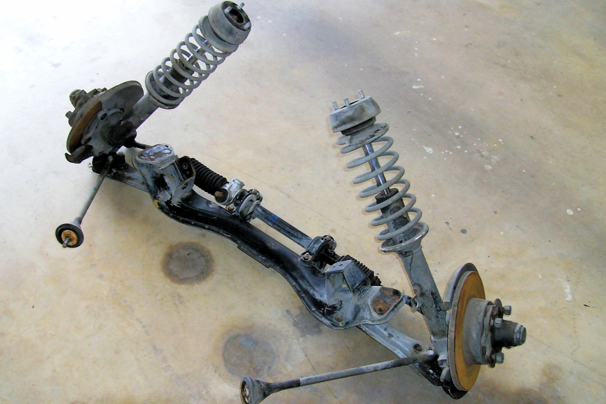

jfa.series1 Posted December 4, 2013 Share #8 Posted December 4, 2013 Here's my front suspension just as it was dropped from the car. Look closely just to the right of the left rack bushing clamp and you can find this little clamp and see it touching the cross member. Link to comment Share on other sites More sharing options...

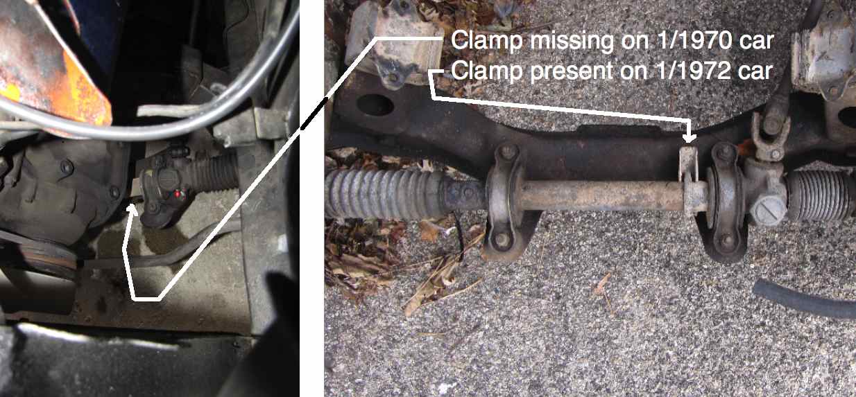

Mikes Z car Posted December 4, 2013 Share #11 Posted December 4, 2013 (edited) Interesting. I just took pictures of my car and a par ts car. The 1/70 model is missing the clamp and the 1/72 model has it: I know the 1/70 car was raced, don't know if they had any problems with it though even if they did they might not have known the corrective action. Edited December 4, 2013 by Mikes Z car Link to comment Share on other sites More sharing options...
