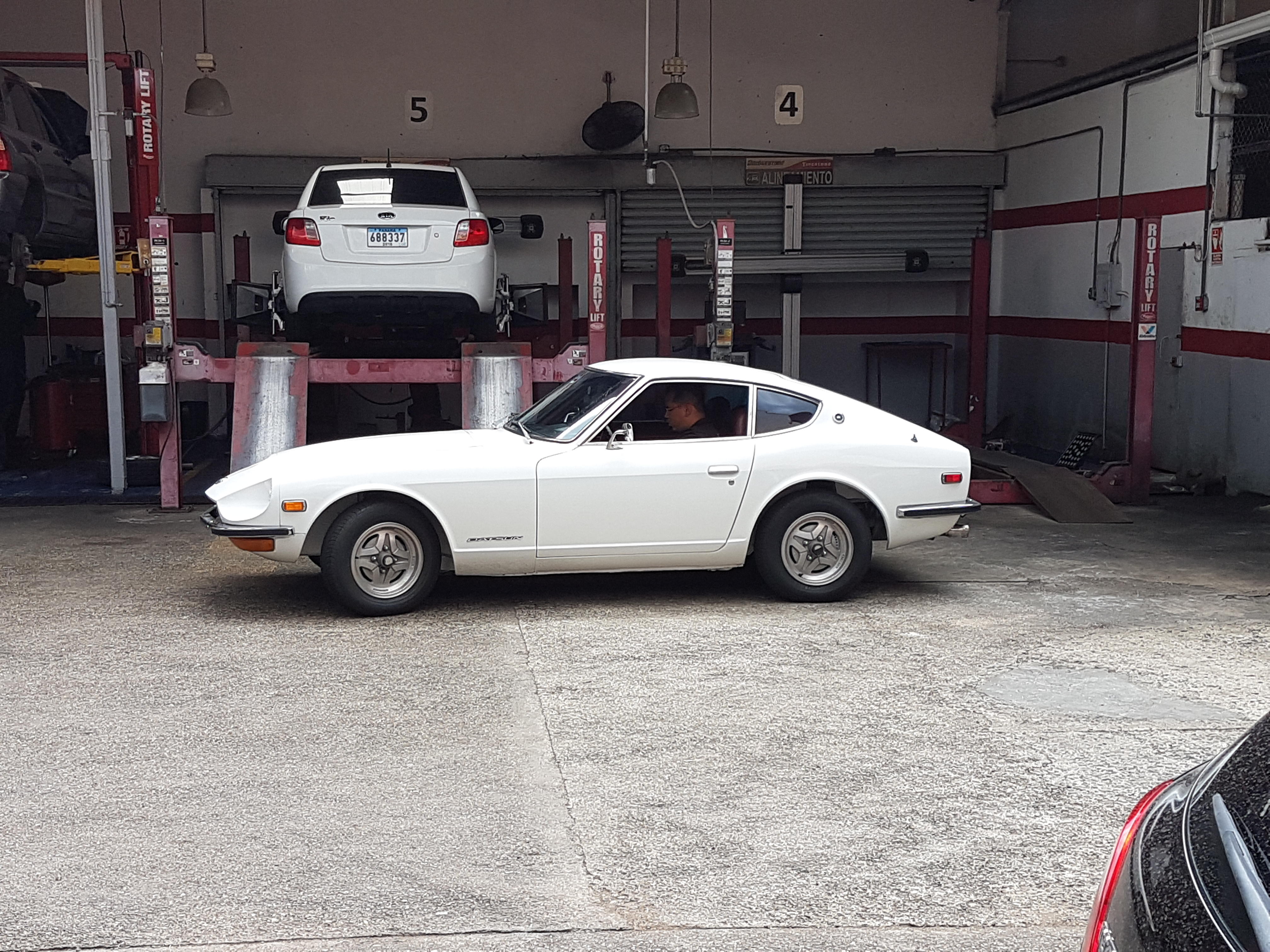

siteunseen Posted May 28, 2018 Share #592 Posted May 28, 2018 (edited) Nice looking car! All I've seen is the spark plugs and the carbs. 13 hours ago, jalexquijano said: I use atf but my can try 3 in one motor oil to see if it gets better at low speed. 30 wt for hotter climates, according to 240260280 or Blue or Phillip. Edited May 28, 2018 by siteunseen Link to comment Share on other sites More sharing options...
