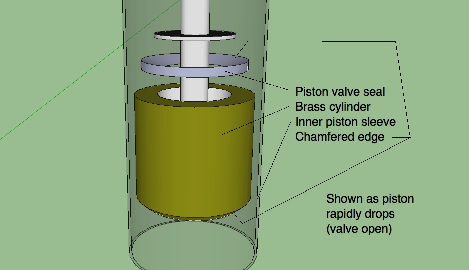

Attached is a drawing of the valve as I was seeing the one I have.

BTW - I like your drawing of the valve bits. Missing a sealing chamfer on the underside of the top (fixed position) washer, but other than that, looks good. :)

If the valve sticks open again I will take Blue's advice and replace it. I did have some backfiring through the carb as they were running lean until this last weekend but it didn't happen a lot. Your noticing the missing chamfer on the bump stop washer is a good observation! I realized that chamfer was missing shortly after I posted the drawing.
