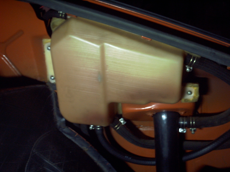

I agree that is should have the plastic tank, but I was just trying to confirm that is what he is trying to reinstall, not the later metal tank. I believe the metal tanks are a little larger, which is why the bump out in the right side plastic interior panel is also larger.
Here is a picture of a stock plastic tank installed I found in an old thread, if that helps.
-Mike

Yup,plastic tank is smaller.

Sounds like you need the plastic one then. I don't think they used the metal tanks until sometime in 1971, maybe when the series II came out. I think I have a couple of the plastic tanks around here some where.
