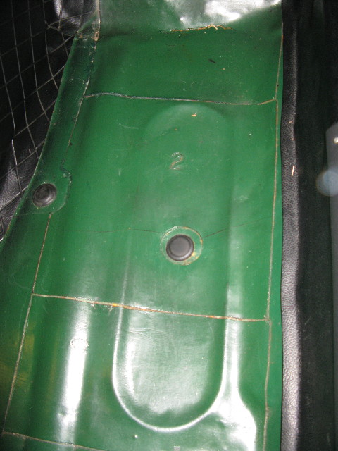

Sorry you ran into a problem, but what you've described so far isn't a big deal. In fact, it may not be a problem at all. Z's had a couple of quarter size hole in the floor board that had a rubber/plastic plugs in them. Your post doesn't say if this was rusted through, etc. If it was pretty much round, it could have been just one of these holes. See the picture attached.
The "weird rubber thing" may actually be what we call the "tar mat" which is a thick layer of material glued to the floorpans. In Bob's picture you can clearly see the rectangular outlines of these mat sections.

Did you look at the picture in post #4? That "quarter sized hole" may just be the NORMAL and OEM Rubber Plug for the floor. There are two plainly visible in the picture.
