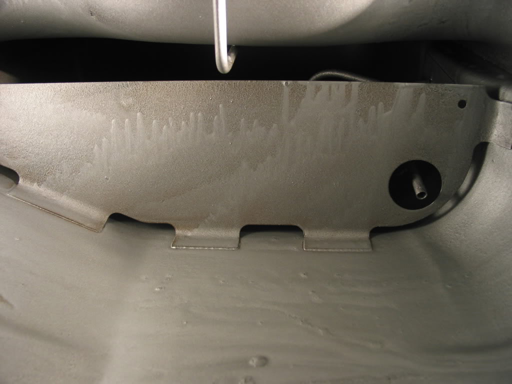

Gas tank cleaning isn't a simple procedure. I've done a few tanks and they each took about 20 man hours to do them right. There is nothing wrong with the POR-15 kit, but it can't do miracles. The tank must be 90% cleaned with other methods before using the kit.

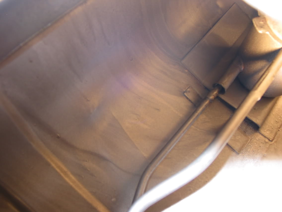

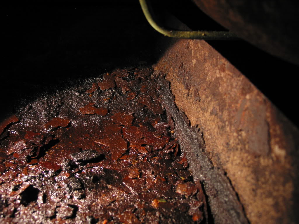

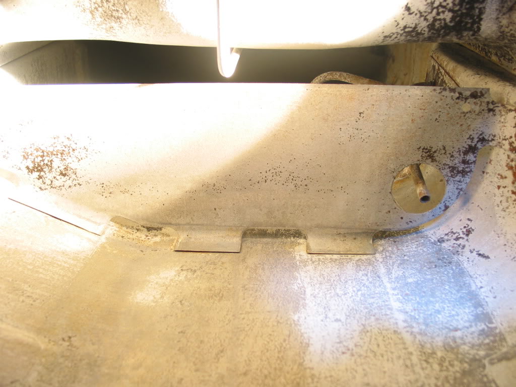

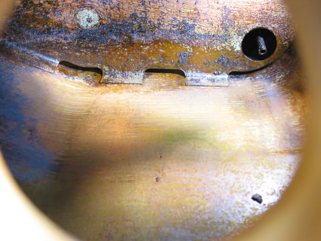

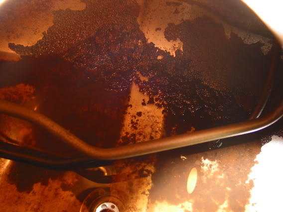

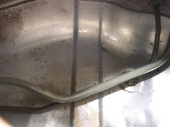

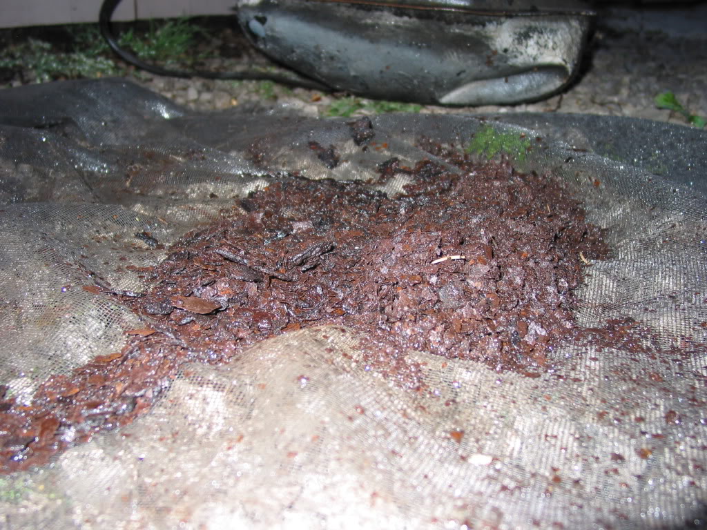

I start with water. Rinse the tank out many, many times to flush the big stuff out. I then switch to a 1/2 gallon muriatic acid and 1/2 gallon water solution with a few lengths of chain and roll, shake, flip, and roll the tank. After 20 - 30 minutes of shaking, fill the tank with water to weaken the solution and pour the contents out. Rinse with water for another 15 minutes and start the acid wash process over again. It takes at least two gallons of acid (4 washes) to get the tank clean. This is a two man job and takes many hours of back breaking work to complete. Only after this cleaning is finished and the tank looks clean should you start the POR cleaning. The POR 15 directions MUST be followed to the letter. If you are not willing to take the time, don't start the job at all. You will waste time and money and ruin your tank. The POR process takes another few days to complete. I can't stress enough that the tank must be 100% free of moisture before you apply the sealer. Drying time varies by temperature and humidity, but figure 24 hours on average with hot air. I used compressed air followed by a heat gun and then switched to a fan blowing air into the tank overnight. The tank must be turned and rolled during the drying process too or moisture will be trapped. For areas that are hard to dry, you can use a 500W halogen lamp aimed at the area on the outside of the tank placed about 10" from the tank. The heat from the light will help dry the tank.
The first tank I cleaned was more typical of most tanks, but the second tank was probably worse than most people would ever attempt to clean. Both tanks came out like new and are still in use 10 and 5 years respectively after cleaning and sealing. The hardest part of the process is getting the sealer off the pickup screen. Use dry compressed air to blow through the fuel supply and return lines after the sealer is applied. There should be very little back pressure. If there is, the screen is likely clogged with sealer and will cause problems with fuel delivery.
280 tank before cleaning
280 tank after cleaning
280 tank after sealing
260 tank before cleaning
260 tank gunk that came out after water rinse
260 tank after muriatic acid cleaning
260 tank after POR cleaning
260 tank after POR sealing
