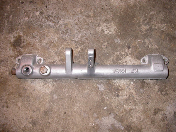

The older series one S30's had a balance tube with the brake vacumn line out the back. It can be relocated to the top if you desire, but the brake vacumn hose is different for that location.
This is a balance tube for non-emissions, but the connection is the same. See how it could be fit on top?
Oh - My - God ! Where can I find a balance tube like that!?!
I've been wasting my time grinding off the bosses and looking for a mig welder to fill the holes on a "Project" balance tube, just so it can look like one that's already out there!?!
Unbelievable!
Ya gotta be lucky Victor, I've yet to find one.....
Gotta buy either a whole early car or be lucky enough to find one for sale.... my 11/70 has the later style, so can see how early a car you'd have to find...:ermm:
I think they went out about the same time as the early style 2400 valve covers.. early in the 70 model year.

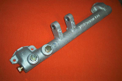

Regarding the balance tube...Mine is the original assembly from my 1970 with the brake-vac fitting out the back however, it did have all the extra bosses for the smog stuff. So, I went though the exercise of grinding, filing, welding, more filing, and then polishing. Lots of effort but great results.

When I first joined this merry group, I posted a wanted for the tube. Chloe, at MidwestZ wrote back and sold me this tube. I understand, but have not seen, there is an earlier tube with no top fittings. Further research is required. This tube was listed on Courtesy's site, and no bitching about the price! This stuff isn't cheap, it's unique...and correct. Have fun!
