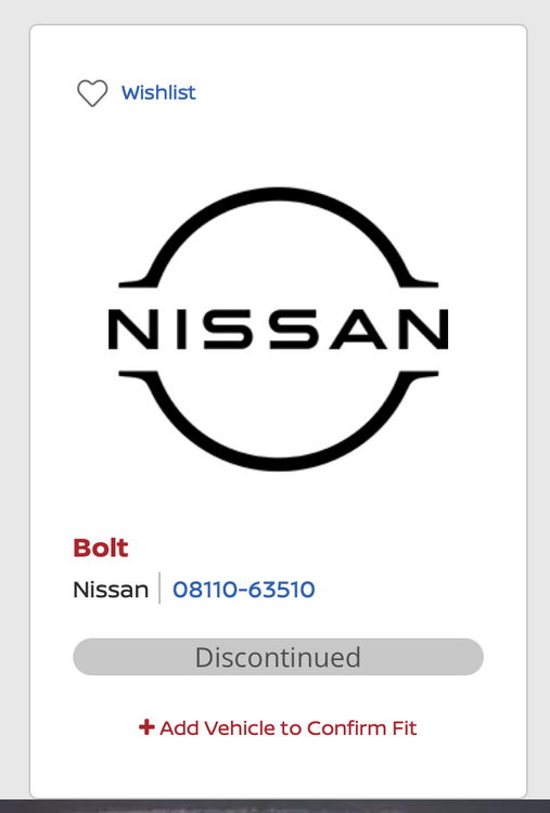

I wasn't able to find this exact part number anywhere online. Similarly numbered, but totally different. Nissan lists it as discontinued FWIW.

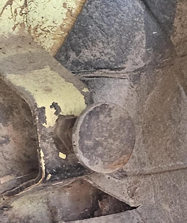

Thanks everyone for info so far. I wanted to post this photo, from Junkyard Jenn, who was nice enough to snap this in her car #1286. Provides a data point on the style used to that point.
