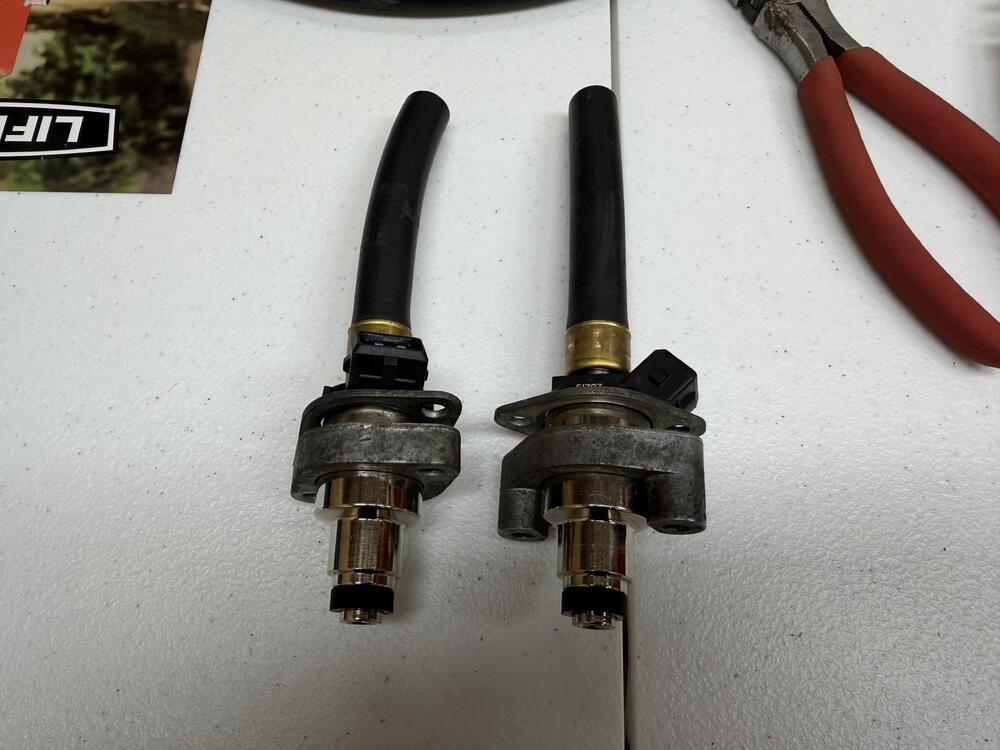

On a side note, Why do half my injectors have the plastic spacer piece and the other half is one piece aluminum?
Over on another ZCar site we have seen the "no injectors firing after replacing all injectors with new" issue with some of the aftermarket injectors that are on the market today. One interesting this is that the injectors would fire if one or two of the injectors were disconnected. Even some of the Z CAR DEPOT injectors were doing it. Never could narrow down exactly what the issue was/is.

When you say "wont fire" do you mean that you had fuel connected and they don't squirt, or the engine won't start? Or are you just going by feel in your hand?
Injectors don't really "fire" so it's not clear what you're describing. But, if the original problem was the electrical connections you should be able to reinstall the old injectors. They might be better than the new ones anyway if they're Nissan originals.
