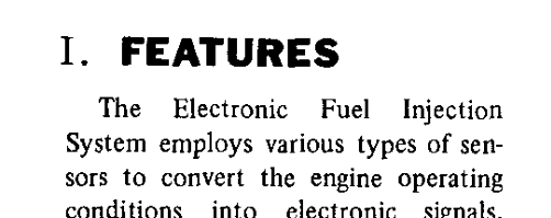

Actually, the the ECCS was introduced with the 280ZX's. The ECU is used in both but started with the 280Z's. Generally, ECU stands for Electronic Control Unit or EFI contol unit. Edit - not sure what ECCS stands for.
Of course, it's all translated from Japanese, so the words might not make the most sense in English. But that's how ECU and ECCS are used in the FSM.
From the 1982 FSM, below. Might be the the ECCS "computer" should actually be called the ECCSU. There have been some discussions about what should be called a computer. I don't think that either of these actually do any number crunching.
