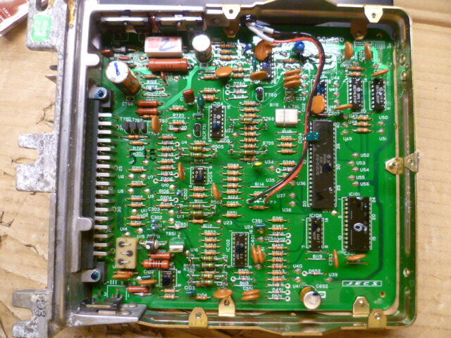

2 hours ago, Zed Head said:
They do call it a "micro-computer" in their description. I'm still not sure though that it does computing, in today's sense of computing. Besides the fact that it's not digital.
I've been inside a non-turbo 83 ECU, and it was, in fact, computer controlled. They were running a Hitachi 6801 embedded controller. And even though I've never personally been inside the turbo ECU, I am nearly 100 % confident that it would also contain a microcontroller as the turbo required much more control than the NA version.
So yes, the later years were digital, and computer controlled. Don't know when they made the switch though.
But what do you mean by "computer"? Does the controller contain a program? Does it perform computations? Or does it just convert one electrical input in to another?
I don't know. I found some interesting things about it. It looks like it does contain programming, I wonder how complex it is. It would be interesting to see some of the code with comments. I assume that the code/program would be considered digital but the inputs and outputs not.

So, going backward from 1983, do you know when the Hitachi controller was introduced in to the ECU's? I know that the FSM's say that the 1979 and later ECU's cannot be plugged in to 1978 and earlier systems, even though they use the same connector. The pinouts are different, maybe because 1979 and up contain the controller. Does 1979 contain the controller and 1978 does not?
Referring to what HS30-H said above, maybe the controller was introduced in to the ECU's also in 1979, along with being used in the ECCS.

Hi, quite a stir i made hihi... A 1979 eccs is without any microprocessor, i can tell you as a electronics engineer.
Those round tin boxes (with cooling crown) are early integrated circuits, nice to see! Later on the plastic black boxes came. (Some are already on the printed circuit) The 6801 is a microprocessor and works with 0 and 1 signals of 0 and 5Volt.
As far i know the switch was made between 1982 and 1983. Then analog "computing" became Digital computing where real microprocessors took over the work.
I don't know for the USA But overhere in europe the 1983 280zx turbo was the first z with real processor in the managementsystem. (Europe never had a 280zx turbo before 1983!)
All those boxes in 280z and 280zx were called ECCS until the 1983 turbo came out. (I belief..)
(Don't hold me to it, i'm not a wizard, just remembering this stuff..) ;-)
