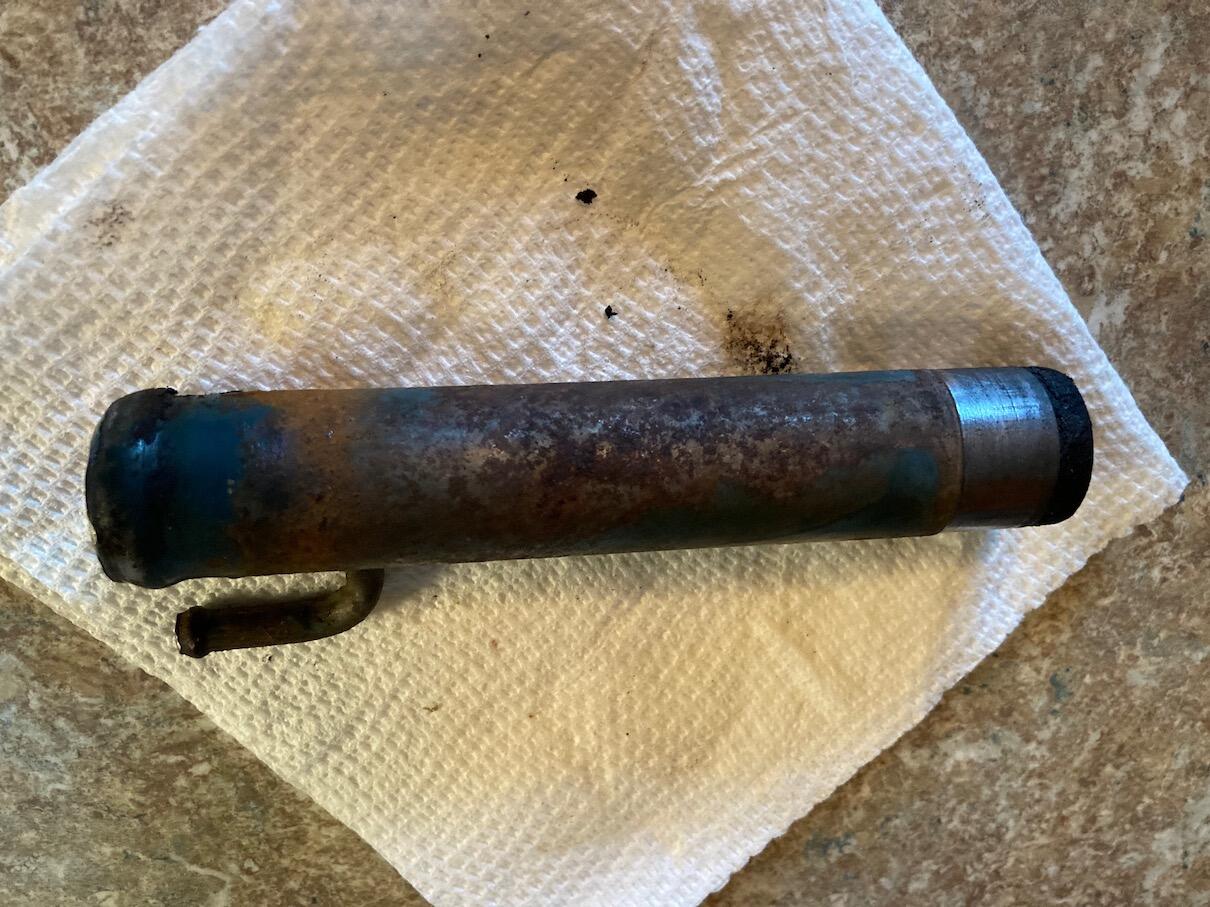

11 hours ago, Terrapin Z said:
@texasz A break in the rain, a ratchet strap and some persistence.
Fantastic!  Can you put calipers to the silver area that gets press fit into the block and measure it?
