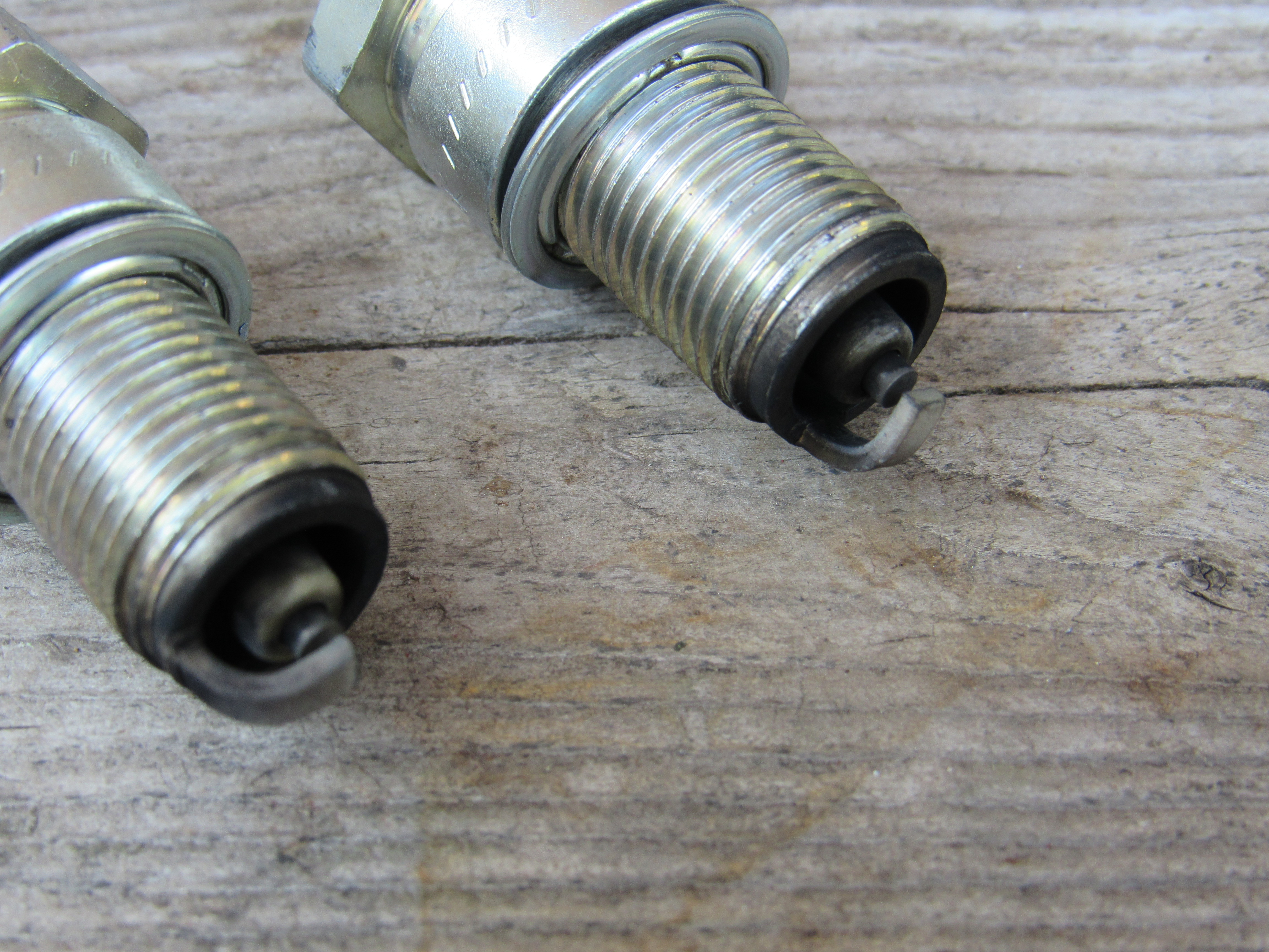

So, engine is running, revs are at 1200-1400rpm, the synchrometer is read about 7kg/hr on all horns, the distributor is turned all the way to retard and the timing light is reading 40 degrees! So something still needs tweaking in the timing. All the spark plugs are looking a little lean.

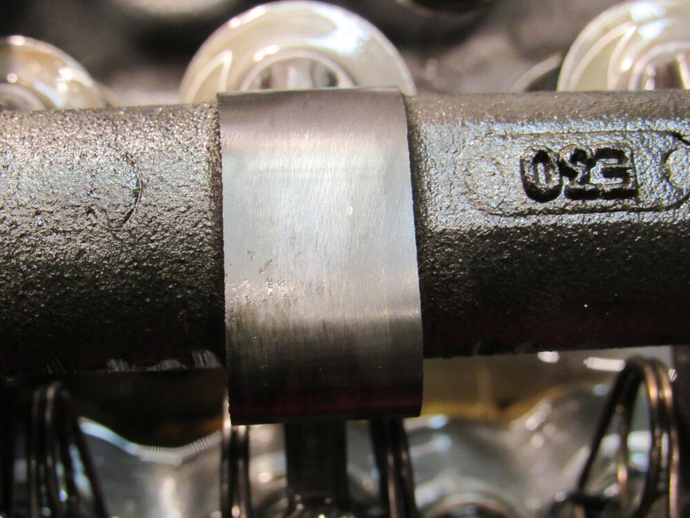

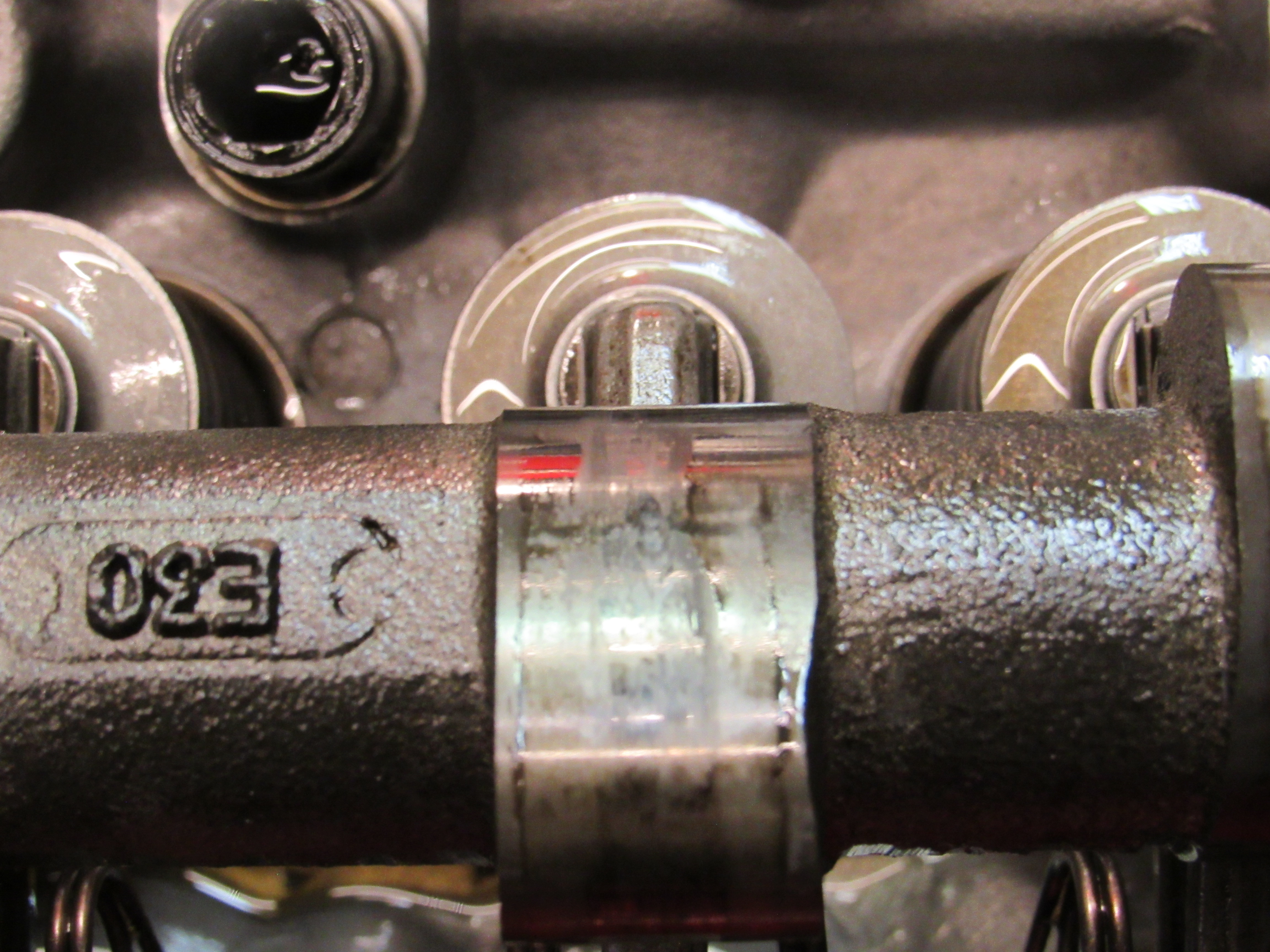

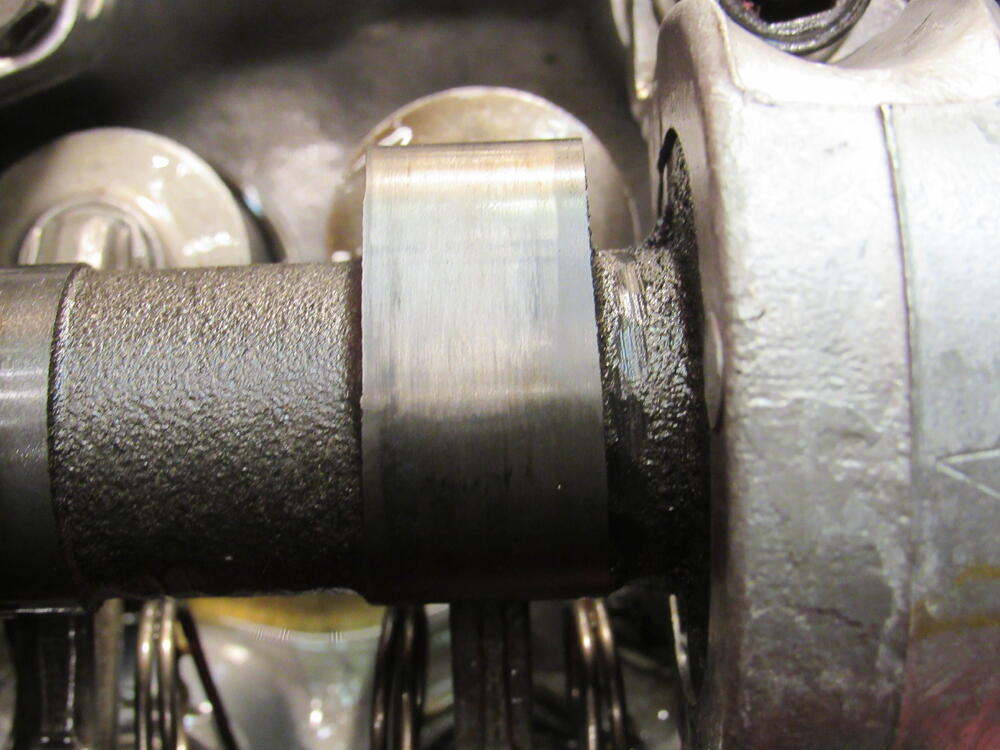

What has me concerned ATM is the stock oil gauge is reading 0, the oil filter is hot though, I opened the oil cap and everything wet with oil but no oil is flinging about. So I turned off the engine and removed the valve cover and the cam is showing signs of minimum lubrication, the black marks on the cams cleans off with a piece of fine Scotch pad. @Patcon and the valve lash had tightened up so re set that.

 Are the holes in the spray bar partially blocked with crud? I started poking at mine with a torch tip cleaner and was amazed at how encrusted they had become. There was minimal oil to the cam before, steady streams of oil to the cam after the cleaning. I also soaked the bar in lacquer thinner for 24 hrs to loosen everything up after I saw the build-up in the holes.

If the valve train got hot due to low lubrication, you would probably lose all the lash. Double check it stone cold
Good point, I might pull the cam just to have a look at the rockers, make sure they weren't damaged, I think I was seconds away from wiping those cam lobes.
