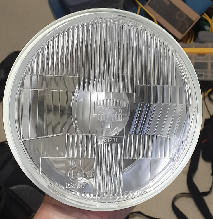

A while back I found that there was an H4 headlight kit for the Toyota Land Cruiser that used Koito H4 housings. This got my attention since Koito supplied many bulbs to Nissan, including sealed beam headlights. The website I found with the best price said they were sold out, so I put myself on the waiting list.
Earlier this week I saw a post on Facebook where someone said he bought this kit from Toyota for his Z cars and supplied a part number. Using that part number, I searched dealerships online that said they had the part. One of the dealerships is on the other side of town, so I pulled the trigger and ordered a set. The kit arrived today. It has a nice relay harness that I won't need. I am just after the H4 housings. I'll put H4 LED bulbs in them and install them in the 260Z.
If you're interested in a set of Koito H4 housings, the Toyota part number for the kit is 81110-60P70.

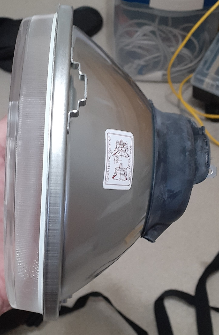

very nice.  Does the surface flat or has the contour like the original headlight?  do you have a side image to show it?
It's relatively flat. That's not unusual for H4 housings.

I think these are the same bulbs?  Stern sells the wiring kit as well.  How much was the Toyota kit?
CW-
They look to be the same housings, and the Toyota kit was...
$63.80 with tax and shipping, so it's just a little less than what Mr. Stern is asking (if you think $100+ is a little less).
And as I mentioned before, the relay kit is included with the Toyota part number, but it would have to be worked on some to work with the Z.
