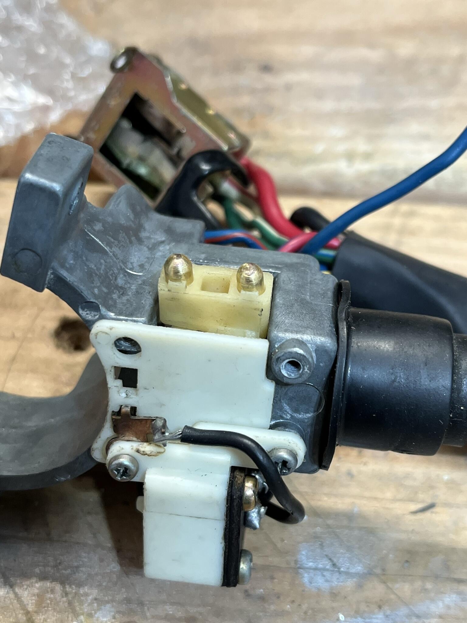

Yep, that's a problem. It melts down/wears down because of the heat from all of the current flowing through the switch. Don't try to get a 3D printed version. It will only melt down faster than the original piece.

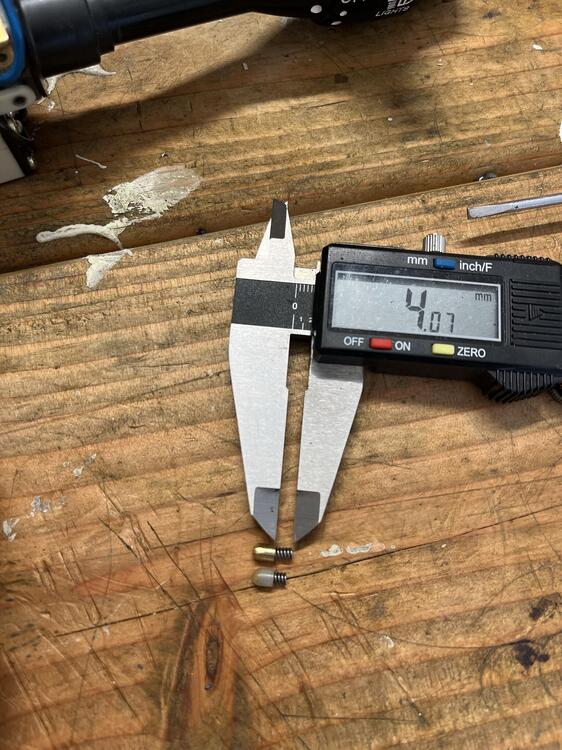

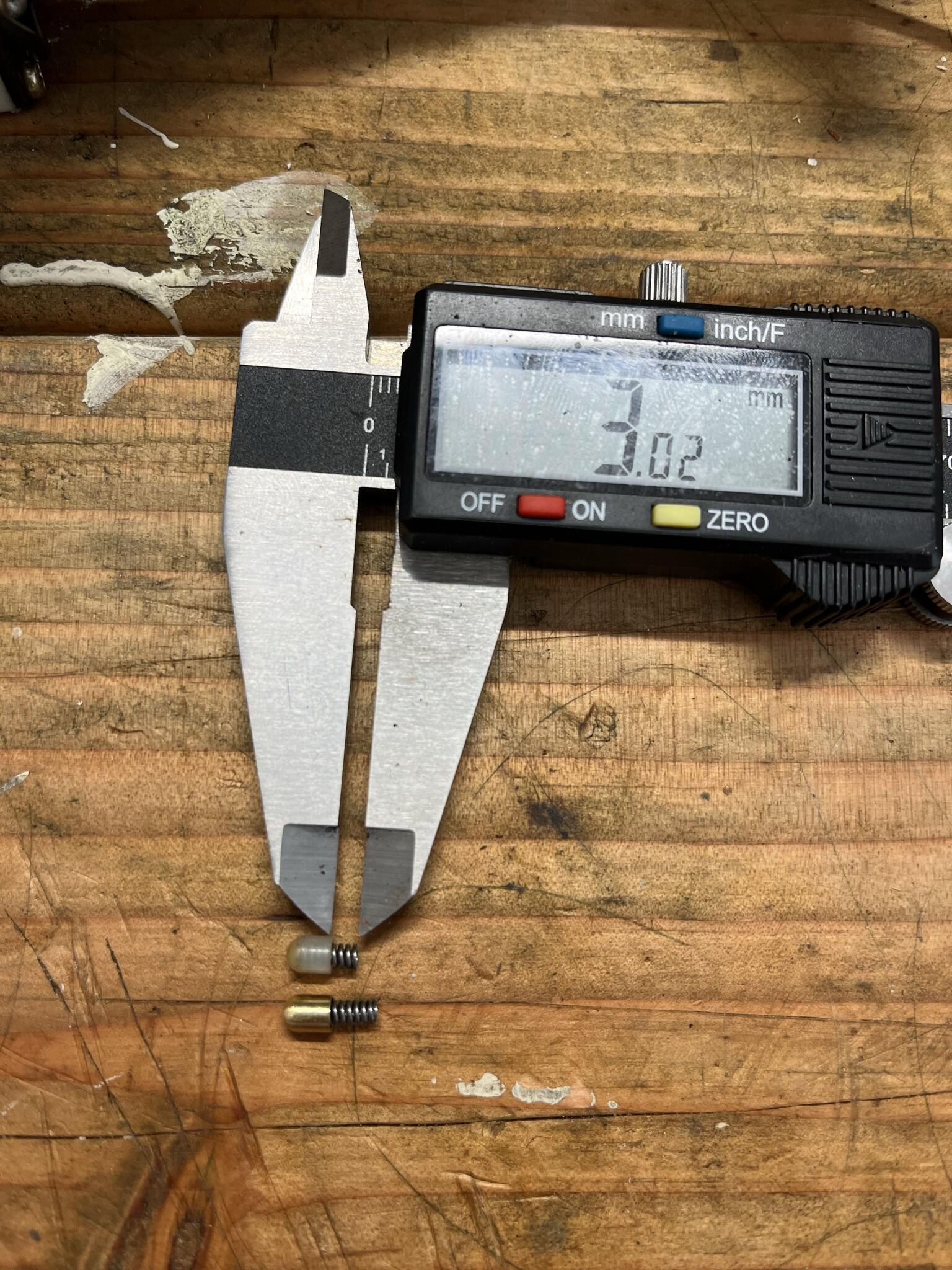

Did you get a depth of the nub? I'm trying to make a 3d printable modle with some good filiment. I have the OD, ID And H,  I'm trying to get the depth inside and I'm also trying to find some springs

@aland The depth is 4mm.
I found springs at Lee Spring
Part LCM050AA 02 M LCM050AA 02 M
To help anyone else who is curious: https://www.leespring.com/compression-springs?search=LCM050AA02M

Well everyone. I modled a nubbin. Only problem is, if the part that the nubbin goes into is broken (the little ears that hold it inline) then you will have the same issues. I'm in the works to modle that part and make it. Here is the nubbin file for anyone that wants to try and make it. I'm all about helping everyone out. I did mine out of high stress PLA+, id recommend resin or somthing more dense.  Let me know if a anyone has any questions.
