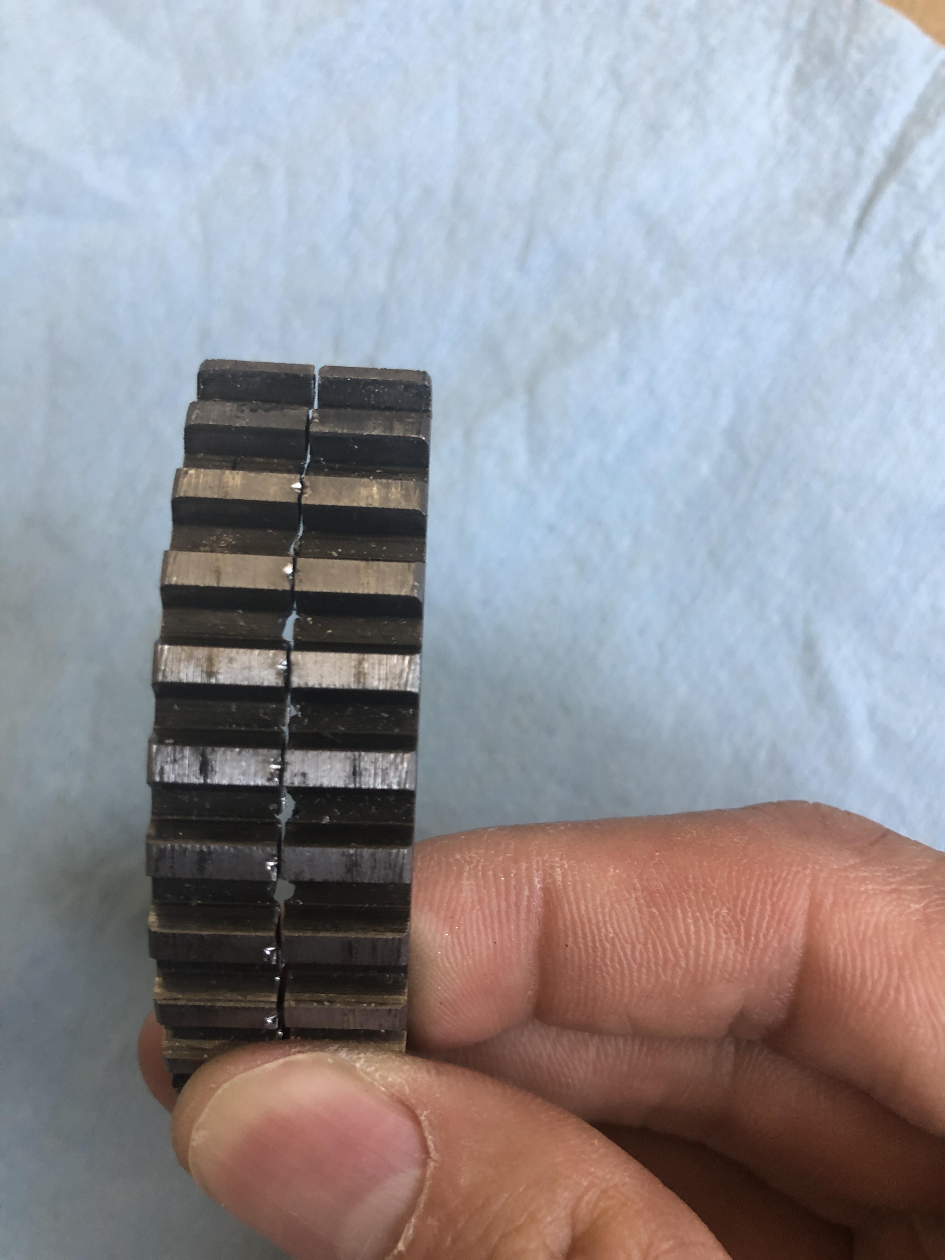

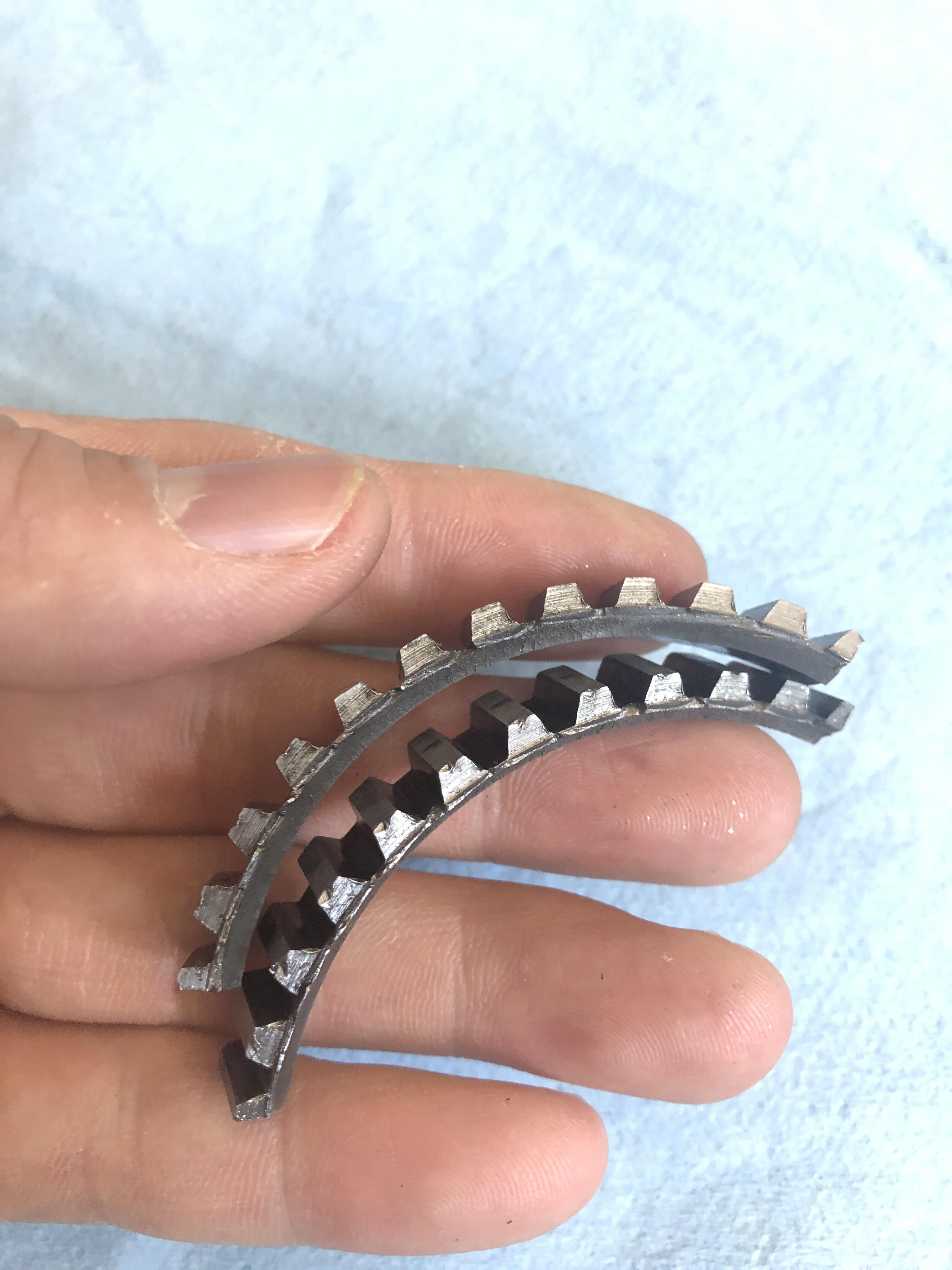

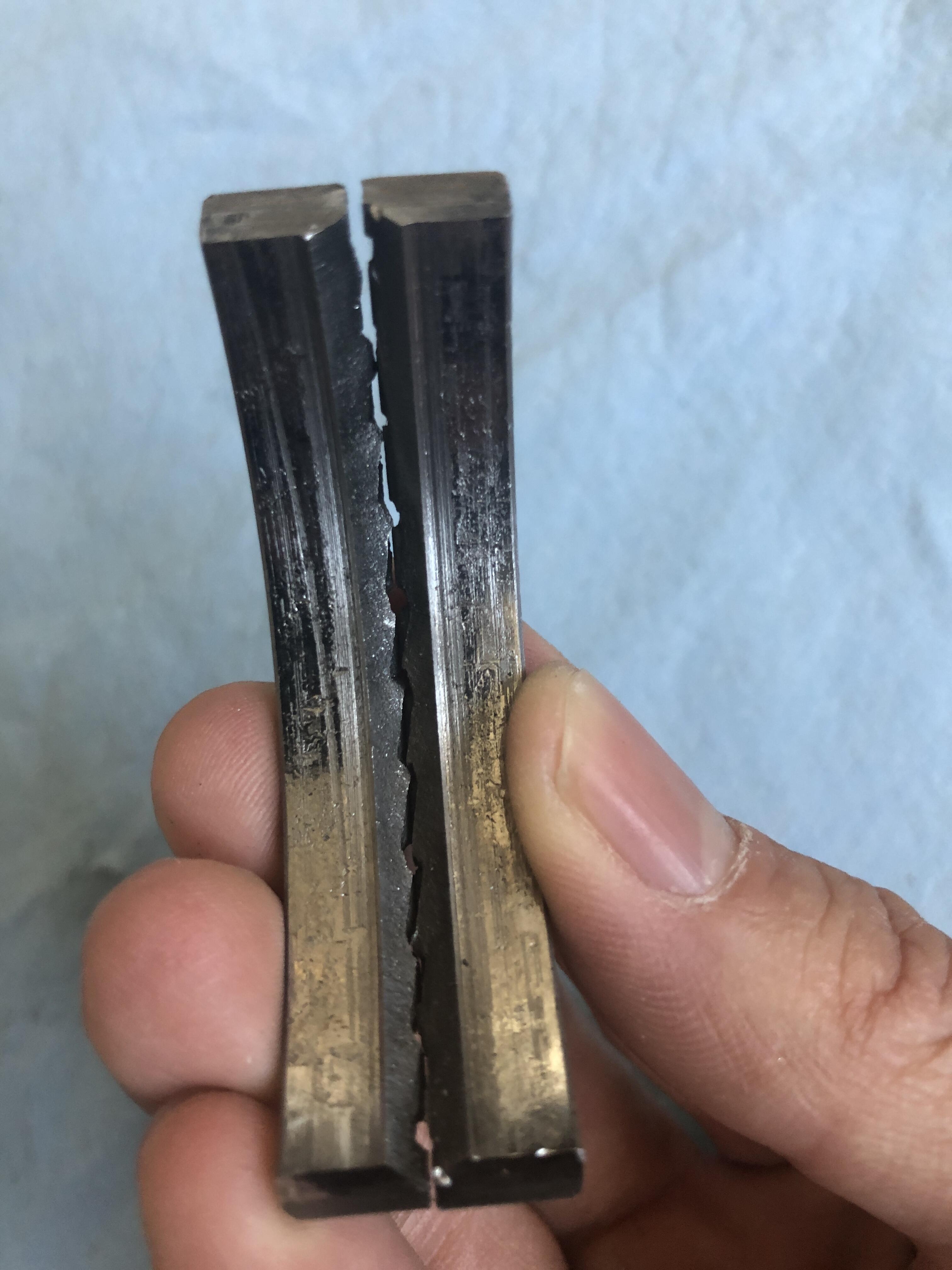

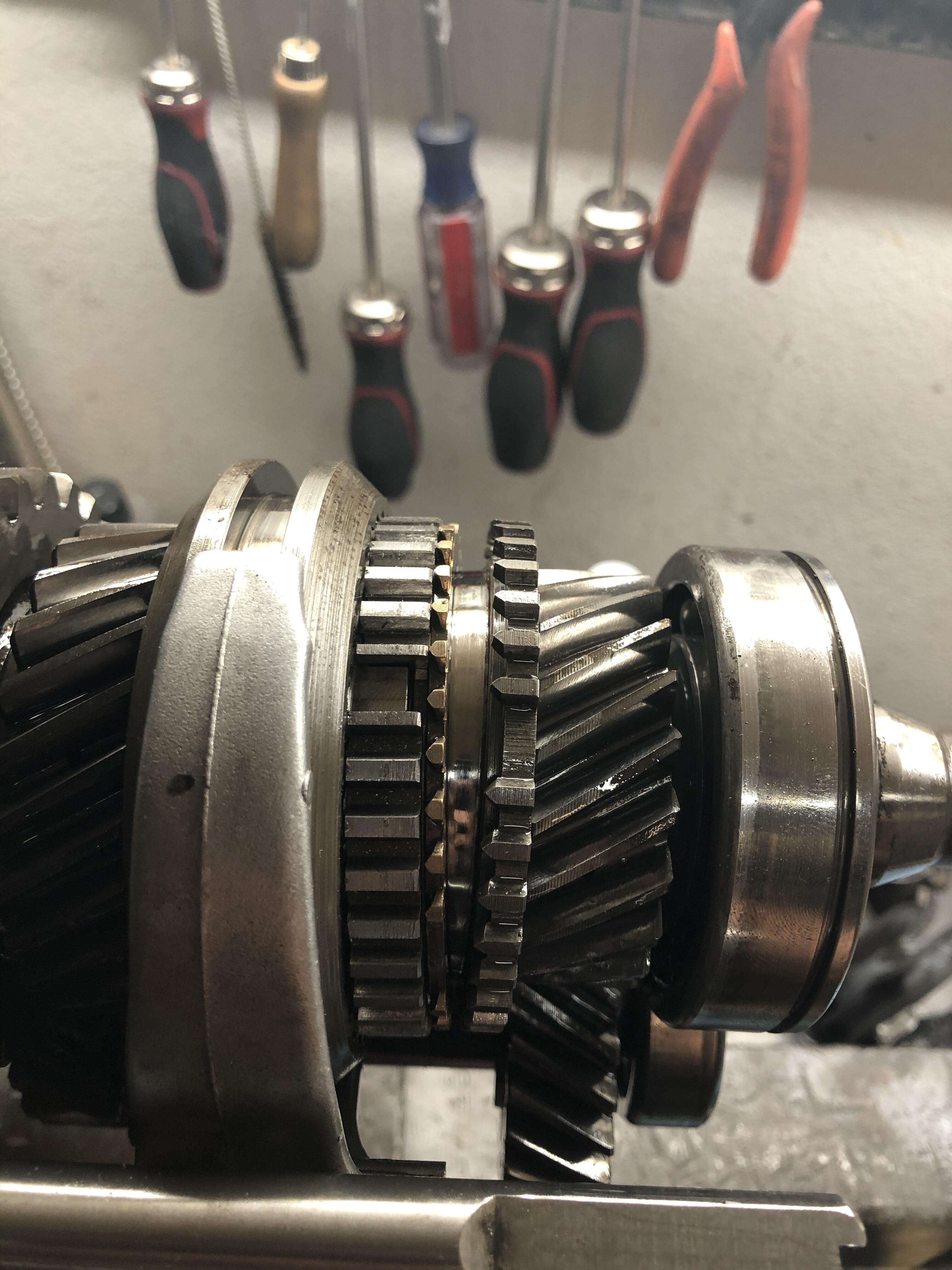

April 7, 20223 yr comment_639078 It might be that the 3rd piece is doing all of the work. Be careful. Do those two pieces have jagged edges like they broke off of something? I recognize the tooth pattern but can't tell where it would have come from. Link to comment https://www.classiczcars.com/forums/topic/67383-1977-280z-with-fs5w71b-transmission/?&page=2#findComment-639078 Share on other sites More sharing options...

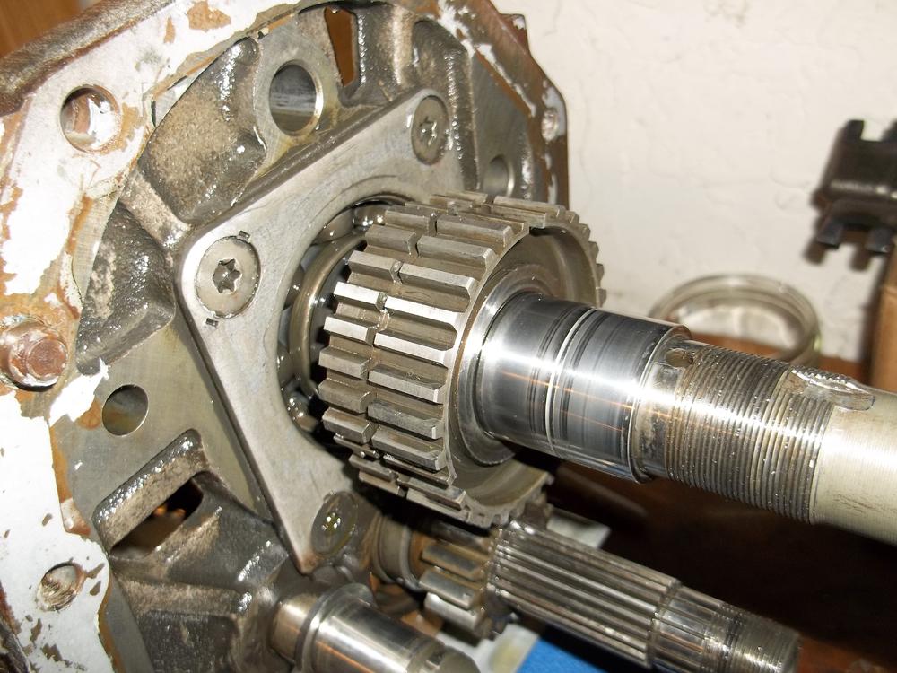

April 7, 20223 yr Author comment_639079 Examine a bit closer, the 2 pieces might me just 1 of the 3 pieces. Â It should look like this. Â Â Link to comment https://www.classiczcars.com/forums/topic/67383-1977-280z-with-fs5w71b-transmission/?&page=2#findComment-639079 Share on other sites More sharing options...
April 7, 20223 yr Author comment_639080 I've been scouting the internet and seem like this part is no longer available. Need a donor. Link to comment https://www.classiczcars.com/forums/topic/67383-1977-280z-with-fs5w71b-transmission/?&page=2#findComment-639080 Share on other sites More sharing options...

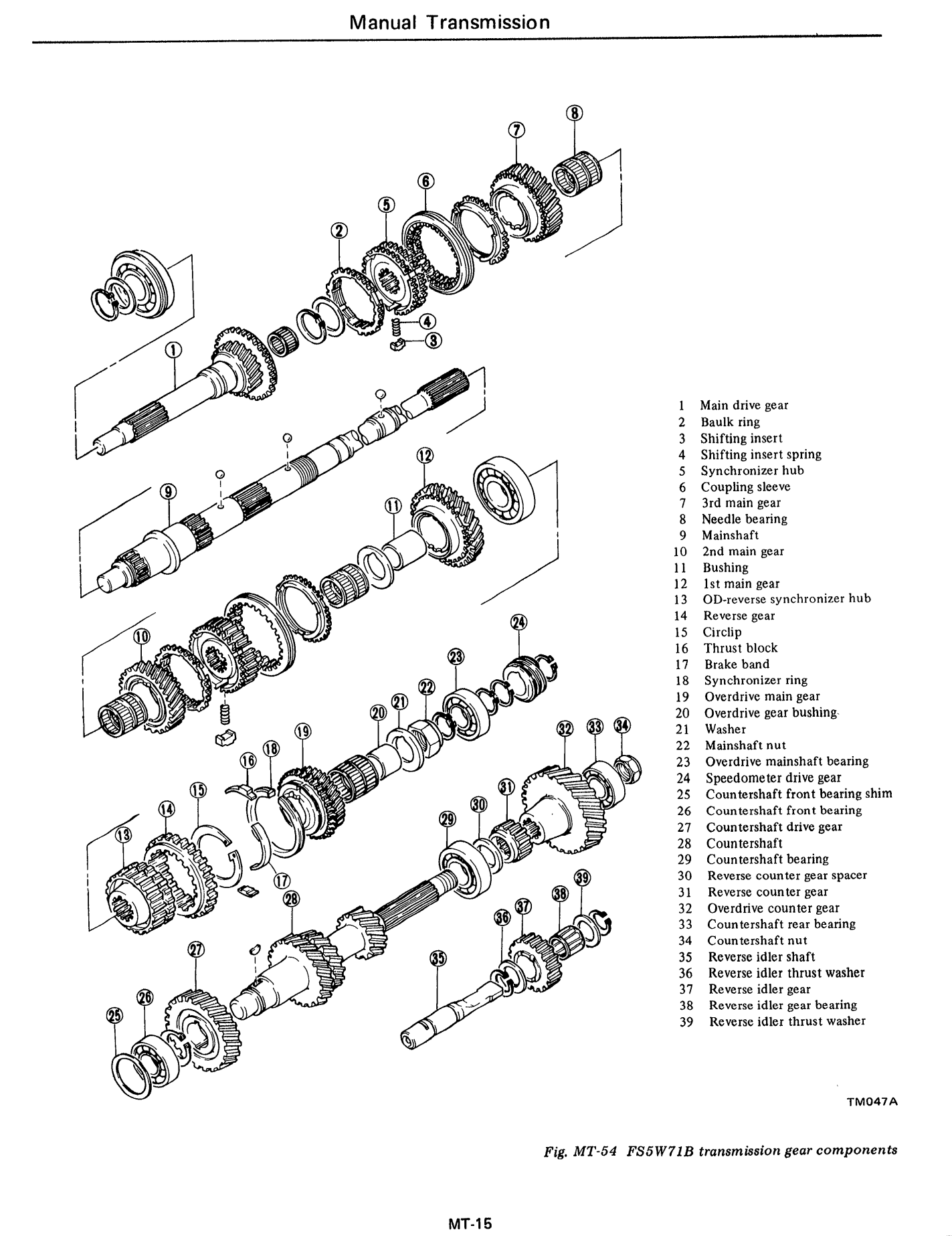

April 7, 20223 yr Author comment_639083 The broken part look like #5. Synchronizer hub From Dave WM. Second post  Edited April 7, 20223 yr by 240zadmire Link to comment https://www.classiczcars.com/forums/topic/67383-1977-280z-with-fs5w71b-transmission/?&page=2#findComment-639083 Share on other sites More sharing options...

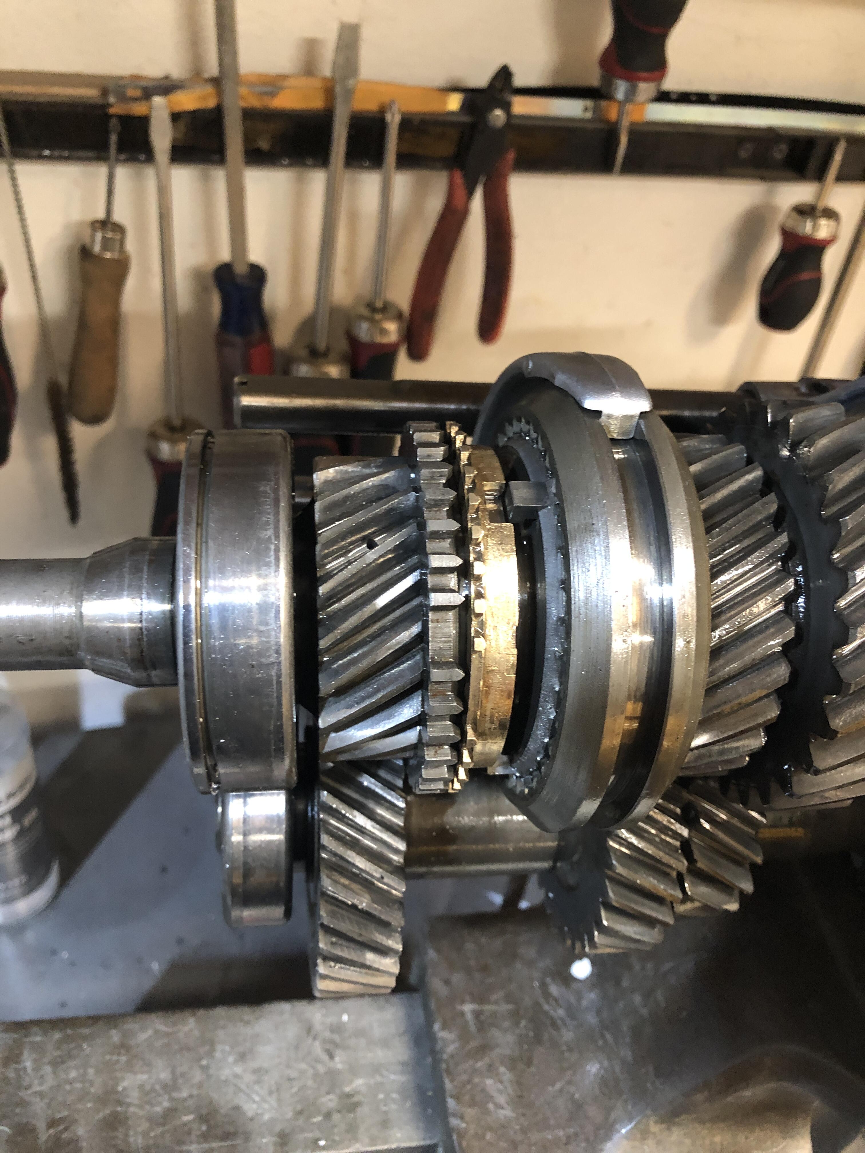

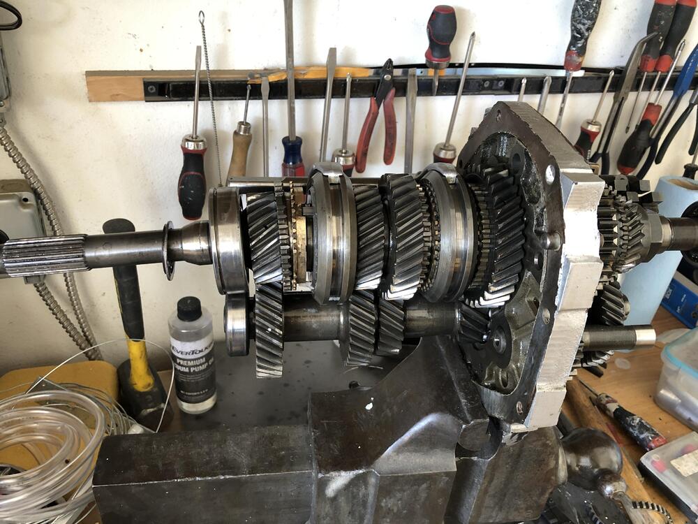

April 8, 20223 yr Author comment_639126 Well, I pull it off last night… all the gears seem to be in good condition.  No chip or damage to the gears.  As suspected , the synchronizer hub is destroyed.  More debris found in the casing  been searching for replacement part but seem like if any available, it will be from a donor.  Any one has spare and is selling, please let me know.  Also, will the 4 speed work ? Link to comment https://www.classiczcars.com/forums/topic/67383-1977-280z-with-fs5w71b-transmission/?&page=2#findComment-639126 Share on other sites More sharing options...
April 8, 20223 yr comment_639131 The 5 speed is basically the 4 speed with an extra gear engineered on. The parts should be interchangeable. You can tell by finding the part number on the carpartsmanual site and comparing diagrams. @Terrapin Z has a large collection of parts. You might want to disassemble further though to see what all you need.  Looks like the 4 speed uses the same part. http://www.carpartsmanual.com/datsun/Z-1969-1978/power-train/transmission-gears/5-speed/44 http://www.carpartsmanual.com/datsun/Z-1969-1978/power-train/transmission-gears/4-speed/from-sep-71/27 Link to comment https://www.classiczcars.com/forums/topic/67383-1977-280z-with-fs5w71b-transmission/?&page=2#findComment-639131 Share on other sites More sharing options...

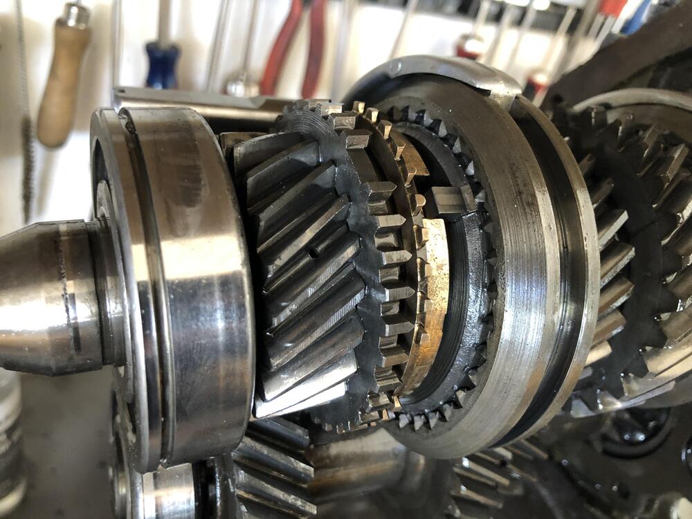

April 8, 20223 yr comment_639136 Ouch. Main shaft hub exploded in the 4th gear section of the hub. Don't see that happen much. The main shaft in front of the adapter plate in the 4 speed and 5 speed use the same parts. You should be able to find a hub easy enough. I'm very sure the early FS5W71C uses the same hubs on 1&2 en 3&4 positions. Early meaning the FS5W71C with the 16mm gears. Are those chips in the front counter shaft gear/input shaft? The photo blurs a lot when I zoom in. Link to comment https://www.classiczcars.com/forums/topic/67383-1977-280z-with-fs5w71b-transmission/?&page=2#findComment-639136 Share on other sites More sharing options...
April 8, 20223 yr Author comment_639141 Yep, ouch is understatement 😉  it cleanly exploded toward the front engine.  The giant bearing has some play as well as the bottom bearing.  look like I’ll have to create a gear puller as those gears  are quite deep. finding a replacement parts are the pain as well.  Have anyone use jp-car parts.com?  Seem like they have some used ones for sale  Link to comment https://www.classiczcars.com/forums/topic/67383-1977-280z-with-fs5w71b-transmission/?&page=2#findComment-639141 Share on other sites More sharing options...

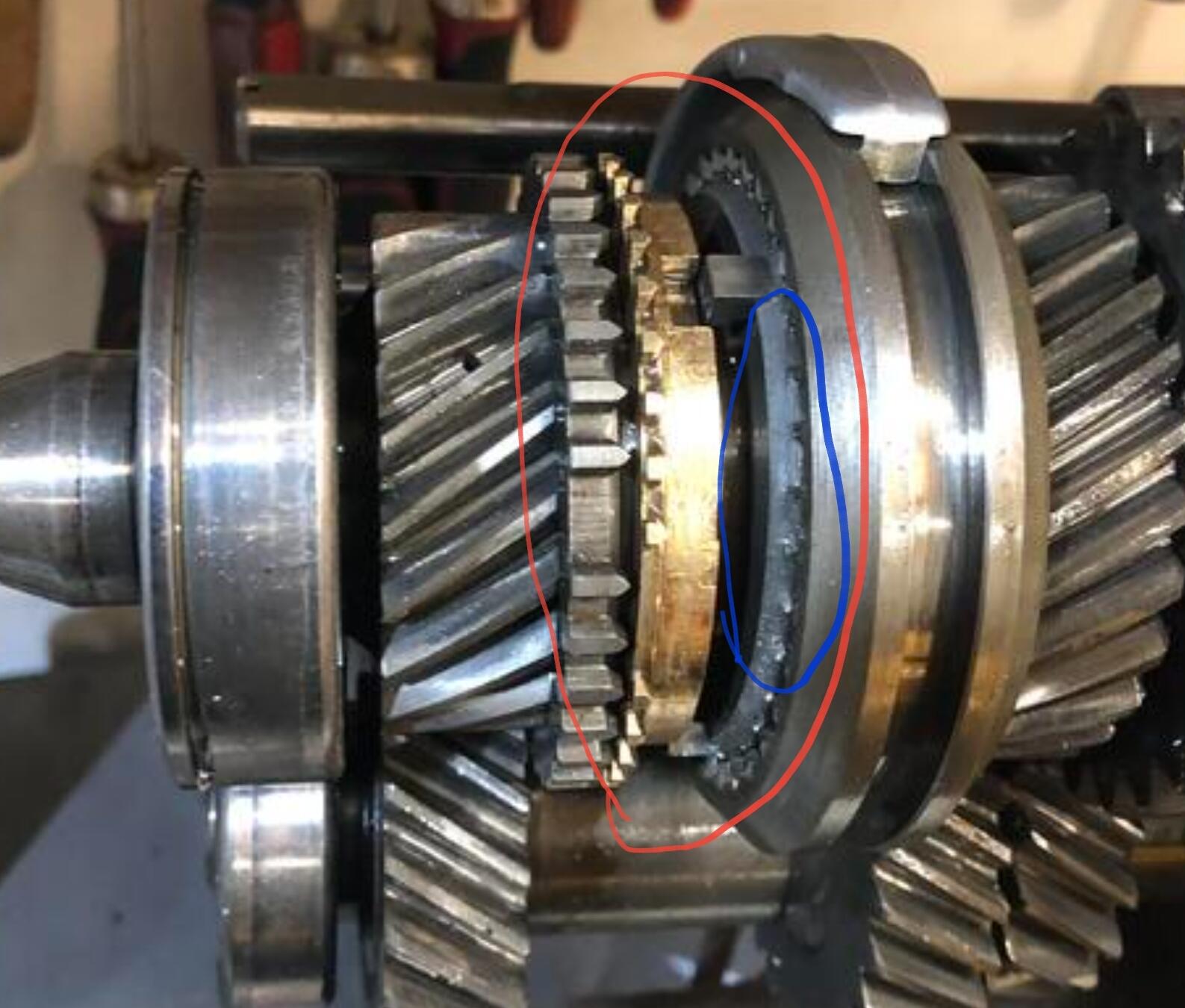

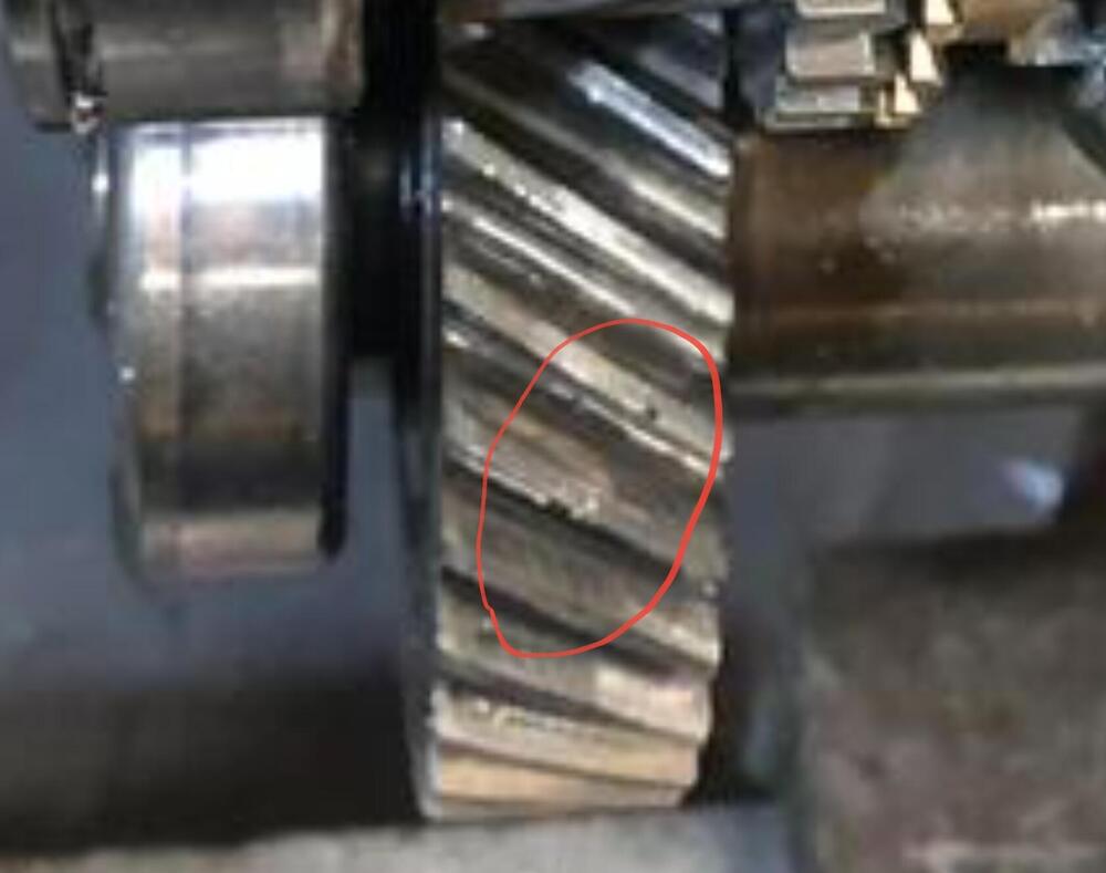

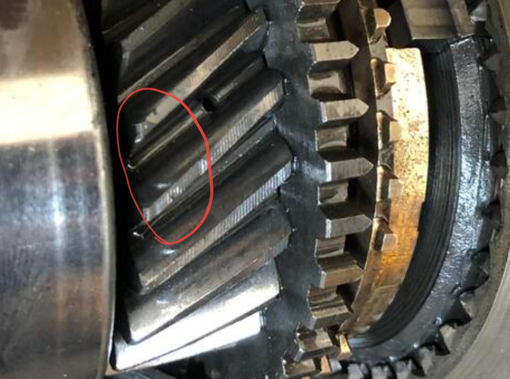

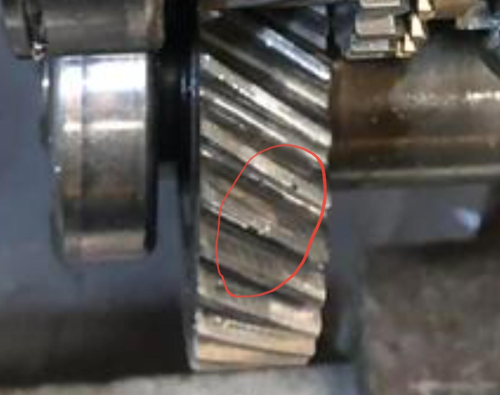

April 9, 20223 yr comment_639176 Before you start hunting parts, can you tell what the marks on the front gears are? I can't get a clear view in the two photos marked in red circle. if the input shaft and front counter shaft gear are damaged, it might be cheaper to source a 5 speed and fit a bearing kit. And I'm saying "Might be!!!" These transmision and parts are getting harder to find so you will need to know what you ned first and then check your options.  The hub broke very clean. My best geuss is it happened when you went from forth back to third. The damage was done when you was in forth, but the pieces stayed in place until the gear sleeve slid over to third. It's an interesting failure, one I have not yet seen in person. And now why did the hub go through so much stress? It could be a worn neddle bearing between the input and main shafts causing mis-alignment between the shafts. It would be interesting to see how much wear on the needle bearing and surfaces. Edited April 9, 20223 yr by EuroDat Link to comment https://www.classiczcars.com/forums/topic/67383-1977-280z-with-fs5w71b-transmission/?&page=2#findComment-639176 Share on other sites More sharing options...
