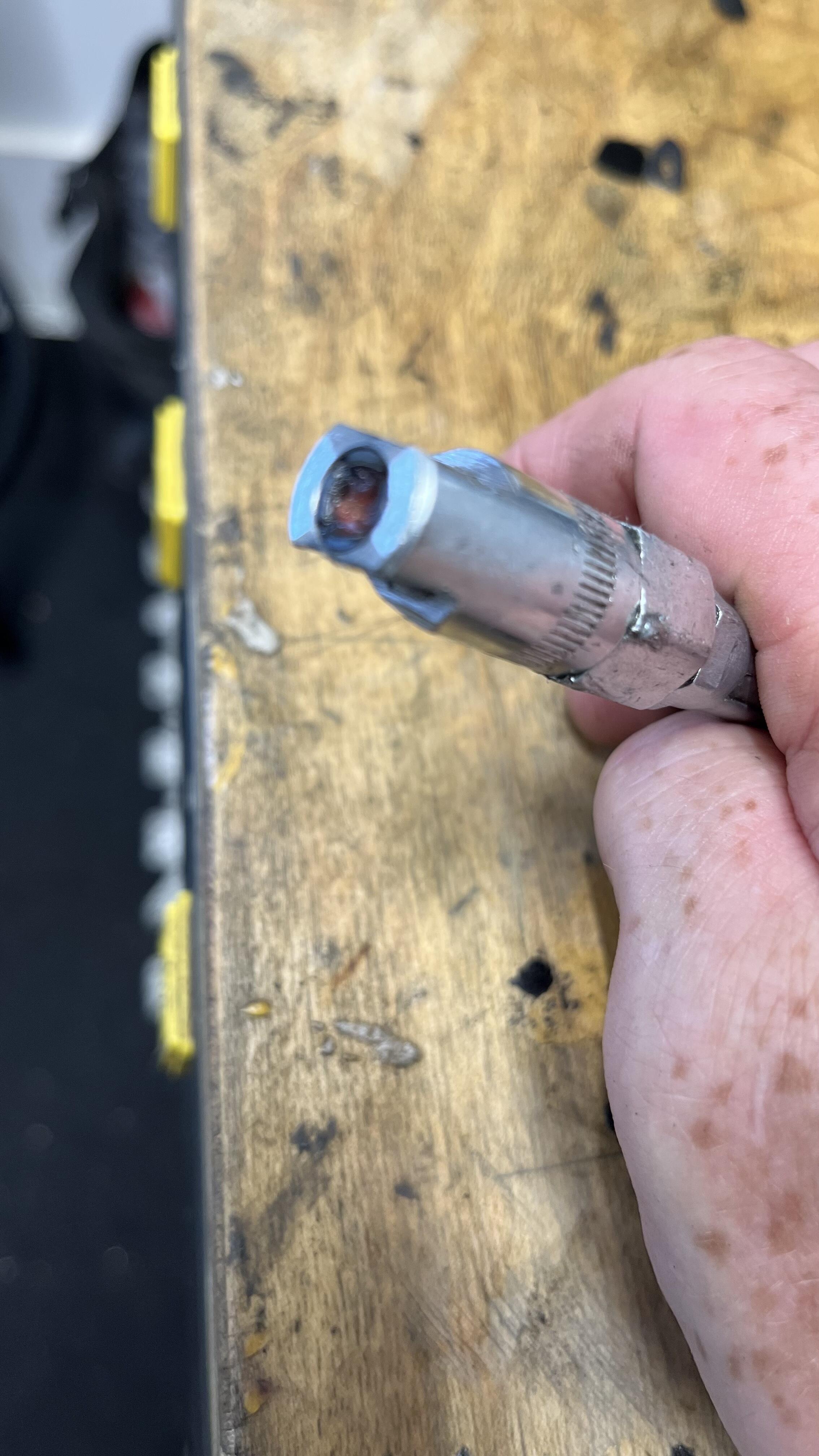

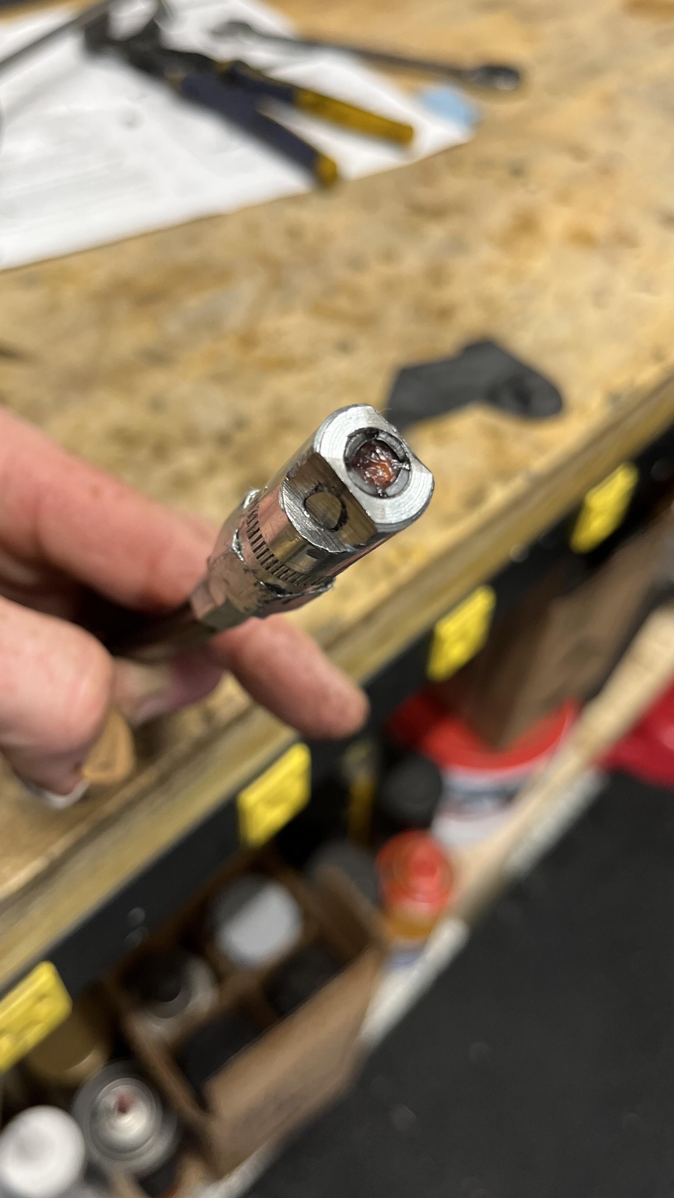

I have a question about half shaft lubrication.    I bought a standard hand pump grease gun to lubricate the half shaft joints.  The grease gun fitting it too big to fit into the space where the zerk fittings are.  I looked at three parts stores nearby and all the gun fittings are the same size (Clerk said its the industry standard) as the one I bought.  Not sure if anyone else has run into this.  I wanted to grease this joints up before I install the half shafts.   Anyone ideas.
I have old faded brain cells with a mental picture of a ground down tip on a grease gun in order to be able to fit into the small opening on the half shafts.
In other words... Many moons ago I think I modified a grease gun to be able to get in there. I don't think I have that gun anymore though to confirm.
Some u-joints have a little screw (that you can replace temporary by a nipple) others have a nipple already in them.. I had once the same problem and... you can solve that by buying some extra long nipples!  😉
Thanks Bruce. I have a table grinder and googles [emoji41]….I’ll give it a go and report back. Hoping to get the new springs in today, we shall see. I have an old flight helmet to protect me if the spring compressor fails [emoji23]. Safety first !
Some u-joints have a little screw (that you can replace temporary by a nipple) others have a nipple already in them.. I had once the same problem and... you can solve that by buying some extra long nipples!  [emoji6]

This will be my second solution if grinding the fitting doesn’t work.

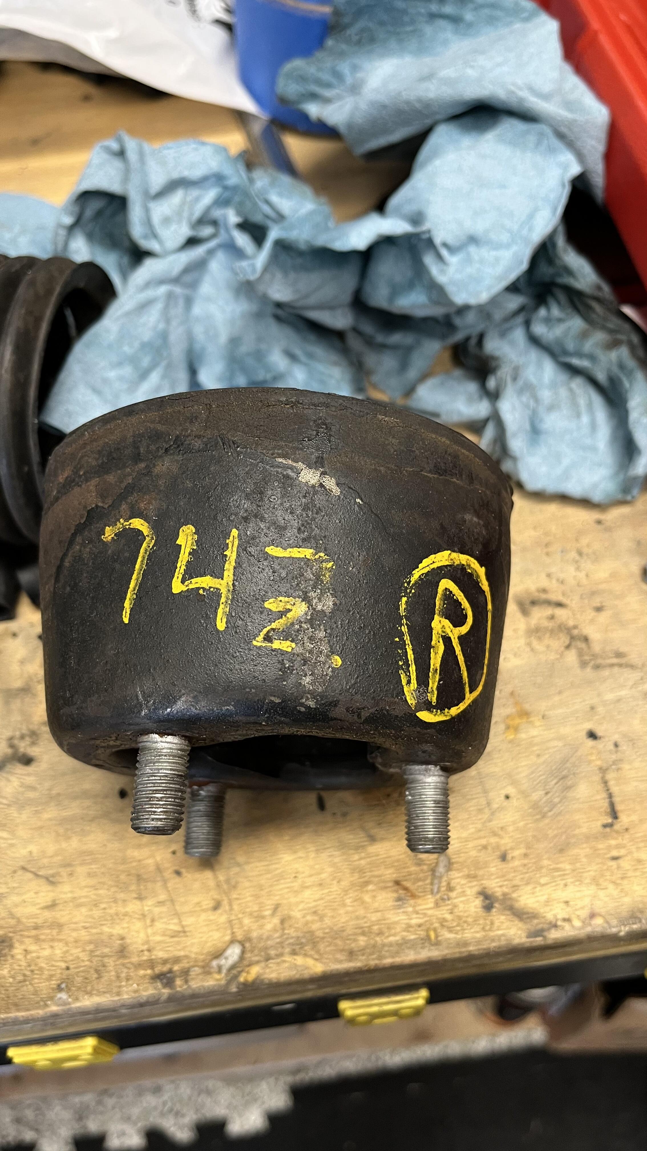

So removing the rear spring was uneventful. No helmet required. I got one side compete today. When I pulled the old spring and shock off I found an insulator from 260z. The only reason I know that it is because it has yellow writing on from what would be a salvage yard and said “74z. R” see pic.

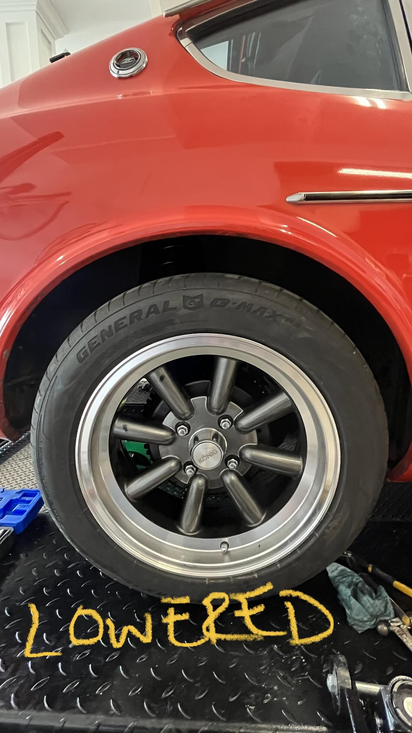

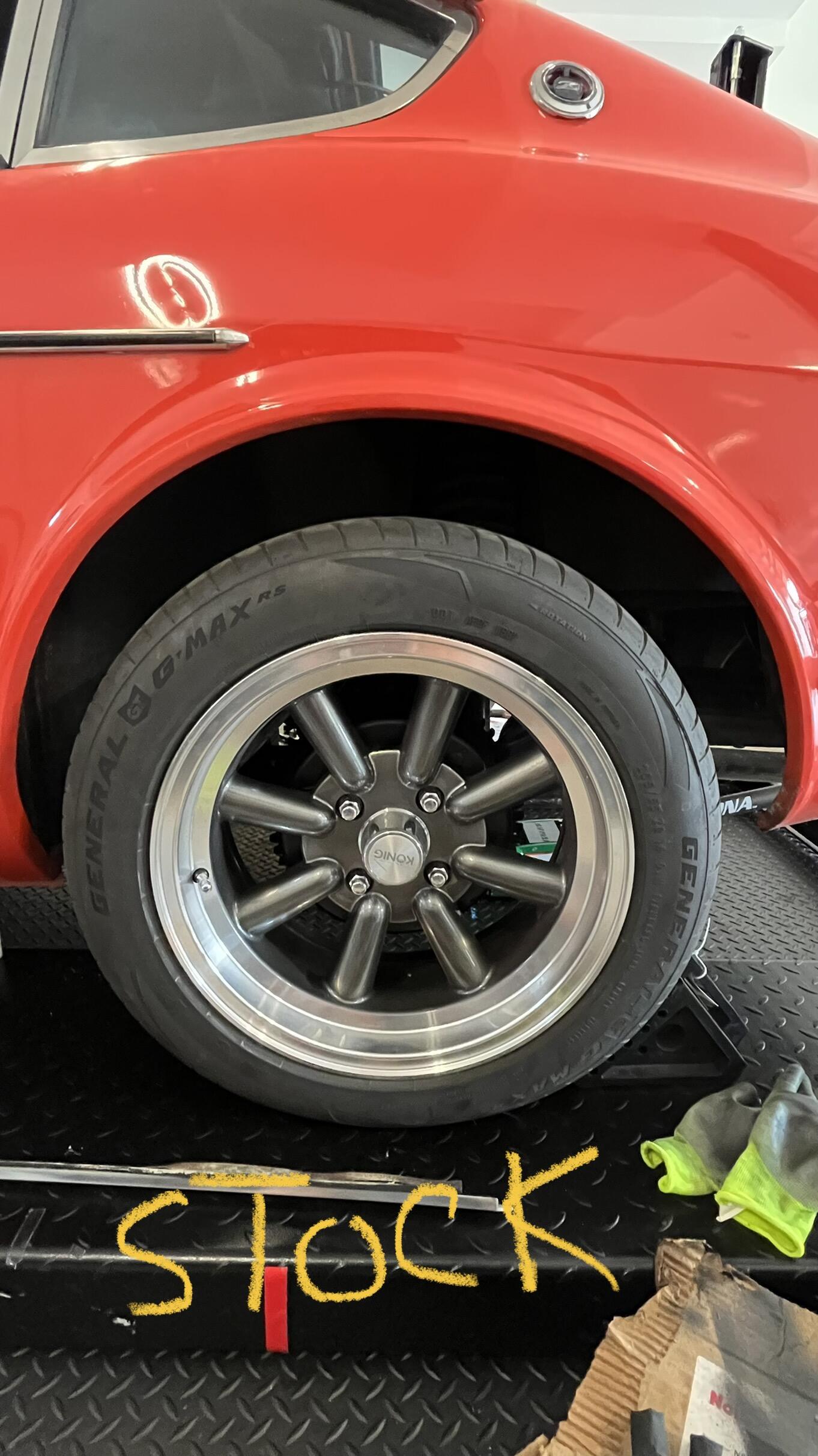

Height difference seems to be about 1 1/4” lower. Looks better, another 1/2” would have been perfect. I have Eibach springs, and a 240z insulator. See pics below. I think once the car rolls a bit it will sit lower. It just came off a jack so the wheels are still canted inwards.
Also got the half shafts greased up used the Captain Obvious “grind” method. Thanks CO!
