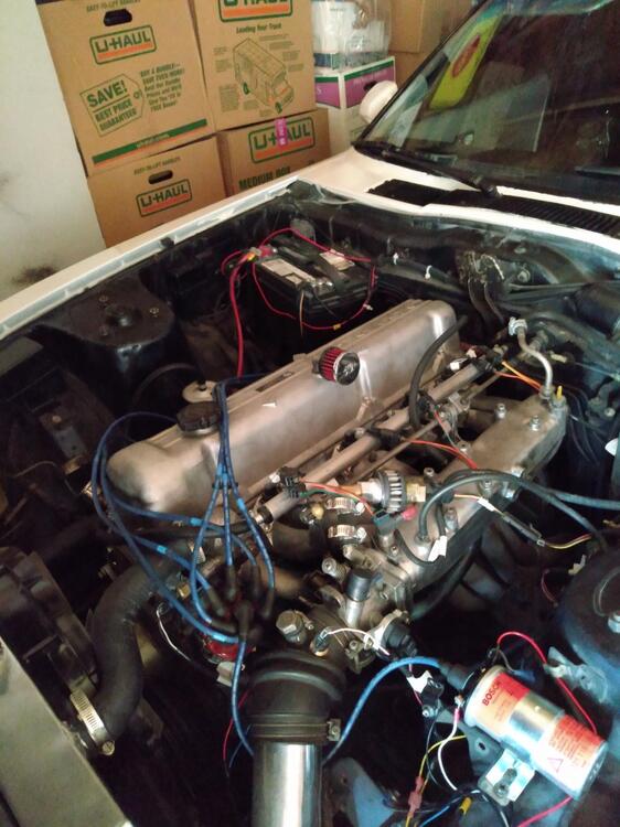

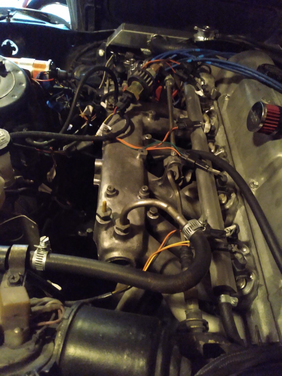

This is the best picture my cheap-o phone can produce.  But It's Z Car Depo's Fuel Injection Rail Kit with Regulator:
https://zcardepot.com/collections/fuel-injection/products/fuel-injection-rail-kit-with-regulator-efi-280z-280zx#
My car is a 1980 ZX like dutchzcarguy's car, which means I had to install the fuel pressure regulator remotely in the engine bay.
The S30 can have the fuel pressure regulator installed in tandem to the rear of the fuel rail as pictured in the link above.
The fuel rail will accommodate stock injectors or 14.5mm "o-ring" type injectors from newer Ford or Chevrolet vehicles, but as far as I have read, the stock ECM/ECU will not run the 14.5mm injectors properly.
https://zcardepot.com/collections/fuel-injection/products/fuel-injector-14mm-o-ring-19-new-efi#
I am running their FAST EFI kit on a mildly built higher compression flat top L28, with the 14.5mm injectors and it works perfectly fine for what I want out of it.  It's pretty much plug and play.
https://zcardepot.com/collections/fuel-injection/products/fuel-injection-retrofit-kit-fast-efi-280z-280zx#

In 1978 Nissan went to a one piece rail.  Not the three piece with the hose connections that your 75 has.  That's worth it, for an easy switch, if you can find one.  A ZX rail is also one piece but the cold start valve will need some work to get connected.
Many people get an aluminum rail because it seems to help with the hot start problem.
That's absolutely true. My fuel rail is cool to the touch. I consider it an open system. I used a '78 fpr with one in and one out. It constantly flows fuel.
