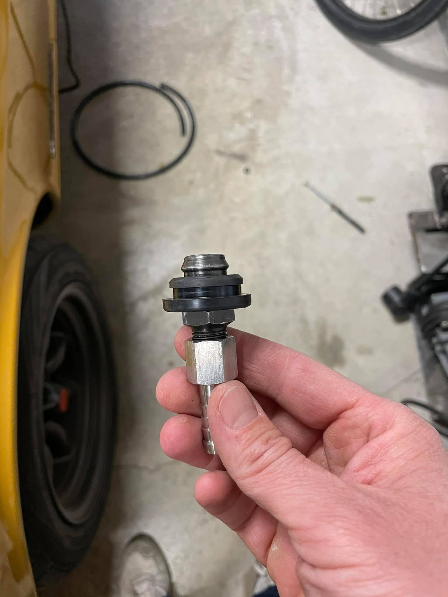

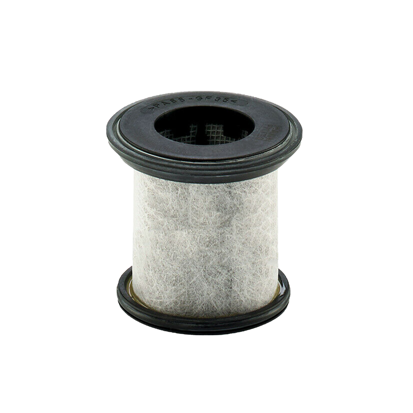

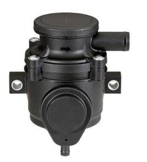

July 29, 20214 yr comment_625923 4 hours ago, duffymahoney said: Ok, here is my plan. It's a bit complex.   Some pcv grommet from a multi pack, fits the stock check valve and block perfectly. I might end up moving this upstream, I am a little afraid of it getting oil trapped in it. Then BSPT adapter to hose barb. Hose barb to a true air filtering catch can. Catch can will be a billet version of the mann provent 100 or 150. Filter media gets 93% of particles prior to hitting my intake. I plan to change the filter every 1-2 oil changes. It will mount to existing 240z holes on the fender. Then from the filtering catch can, to the intake. This is all just for the lower block PCV. I haven't decided what to do about the valve cover one.  As much as I commend the creativity of this solution, something in the back of my head is nagging me that the PCV valve is going to clog up over time! *Scratches head, removes even more vitally needed follicles* Link to comment https://www.classiczcars.com/forums/topic/65647-how-do-you-properly-run-an-oil-catch-can/?&page=3#findComment-625923 Share on other sites More sharing options...
July 29, 20214 yr comment_625925 So here’s a question. Duffy has the PCV valve coming directly off the block. Are you going into a catch can inlet from there? Would the line off the valve cover go not the other inlet of the catch can? Outlet to a filter mount on the top of the catch can? Sent from my iPhone using Tapatalk Link to comment https://www.classiczcars.com/forums/topic/65647-how-do-you-properly-run-an-oil-catch-can/?&page=3#findComment-625925 Share on other sites More sharing options...
July 29, 20214 yr comment_625928 I’m sure someone on the forum will chime in that knows how to refit this.  I can’t be the only one that has this problem.  I imagine you can put a sleeve in there and re-press it in.  Maybe an epoxy weld like JB weld might work too.  I’d rather have a better solution that that.  Any thoughts on the PVC delete for EFI catch can.  Captain Obvious might have an answer for us.  I used Toyota black FIPG(form in place gasket) on mine. It's holding fine after 1,000 miles at least, and the PCV system seems to be functioning fine. I'll bet that if I went and pulled on it with a bit of force it would break the seal though. Link to comment https://www.classiczcars.com/forums/topic/65647-how-do-you-properly-run-an-oil-catch-can/?&page=3#findComment-625928 Share on other sites More sharing options...

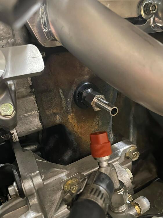

July 30, 20214 yr comment_625964 When you say he provides engines without them (the block breather tube) in place... Are you saying that his engines (as delivered) just have the breather hole hanging open with no tube installed, or are you saying that he actually blocks off the hole with a plug of some sort?So here’s a recent DSI engine pic below.- he doesn’t block them.I’m not convinced by the suggestion that if you block it, the fumes would just come out of the top. Why would Nissan and other manufacturers have gone through the trouble of putting vents at the top and off the block? But I don’t know enough about how sealed the bottom is from the top to have an informed opinion.And here’s a novel approach by [mention=32065]jonbill[/mention] - I love the no nonsense mindset! But maybe he can shed light on how he fixed it to the block. Link to comment https://www.classiczcars.com/forums/topic/65647-how-do-you-properly-run-an-oil-catch-can/?&page=3#findComment-625964 Share on other sites More sharing options...
July 30, 20214 yr comment_625972 2 hours ago, AK260 said: I’m not convinced by the suggestion that if you block it, the fumes would just come out of the top. Why would Nissan and other manufacturers have gone through the trouble of putting vents at the top and off the block? But I don’t know enough about how sealed the bottom is from the top to have an informed opinion. I agree, at times air is drawn in through the valve cover vent and that would be difficult if there is always the positive pressure from blow by from the bottom end. Link to comment https://www.classiczcars.com/forums/topic/65647-how-do-you-properly-run-an-oil-catch-can/?&page=3#findComment-625972 Share on other sites More sharing options...
July 30, 20214 yr comment_625976 4 hours ago, AK260 said: So here’s a recent DSI engine pic below.- he doesn’t block them. Gotcha. So he's assuming you (the purchaser) will do something appropriate with that crankcase vent and NOT leave the vapors in the block. @duffymahoney Link to comment https://www.classiczcars.com/forums/topic/65647-how-do-you-properly-run-an-oil-catch-can/?&page=3#findComment-625976 Share on other sites More sharing options...
