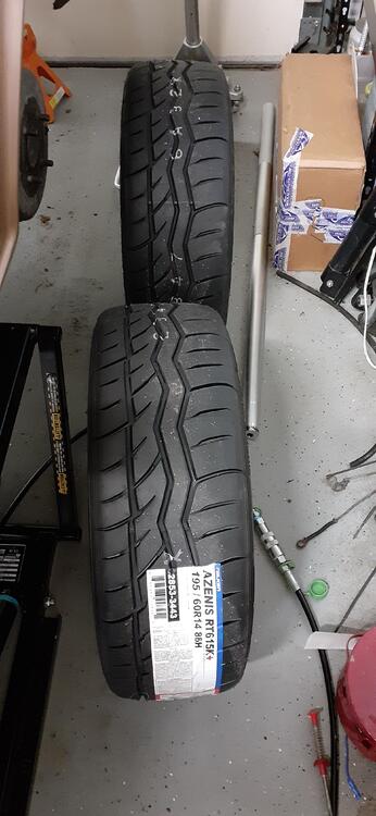

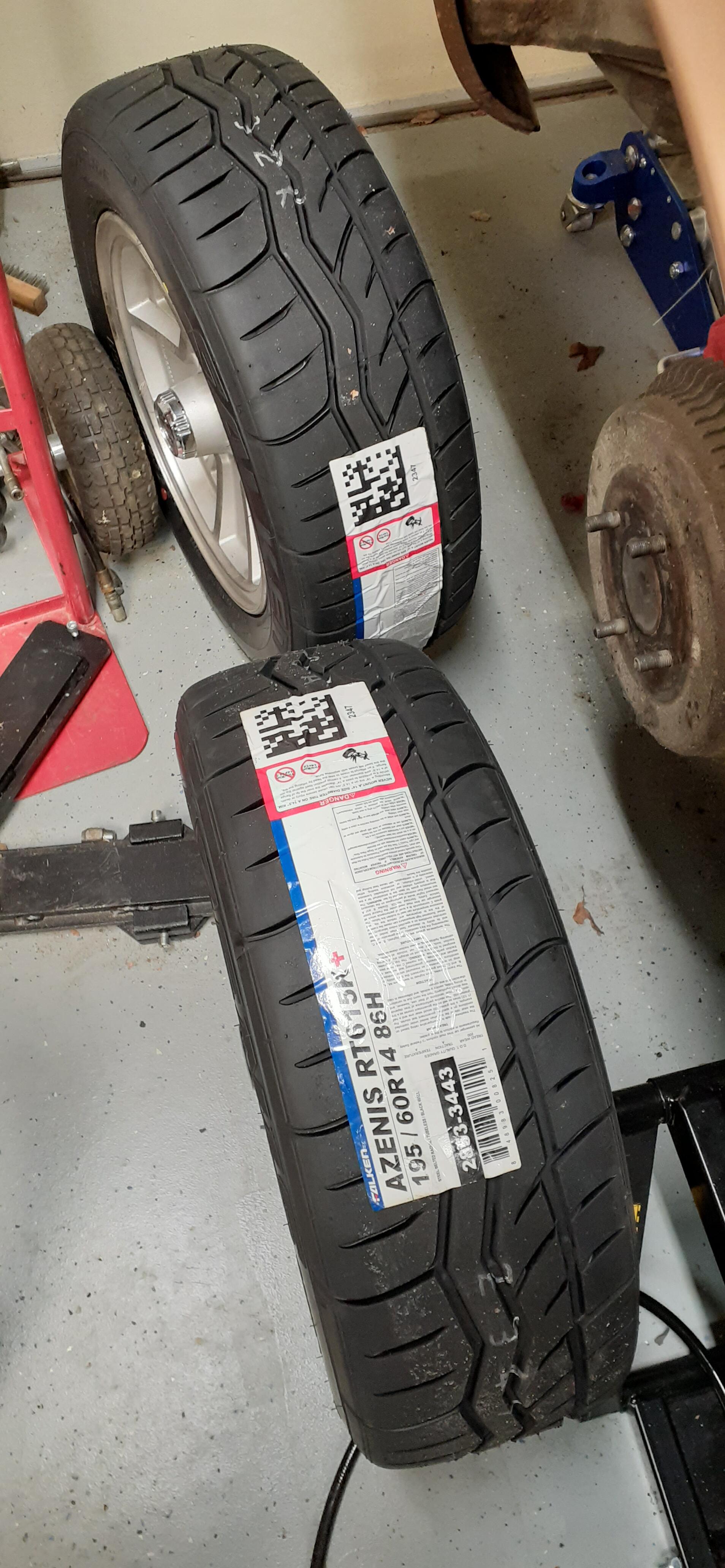

With the horn in working order, I took off the lug nuts and loaded the tires into the station wagon. Tomorrow the wife will take the tires to the tire store where they will be replaced with some Falken Azenis RT615K+ tires, 195/60R14. Yes, I found a performance type tire that will fit on the old Iron Cross wheel. So the old girl rests quietly waiting for the night.
I have those on the 510 atm, very happy with them.
The tires are mounted on the wheels, and the wheels are on the car with the lugs torqued. I got the cooling system back together, filled, and burped. (Yes, I remembered to run the heater to get the air out.)

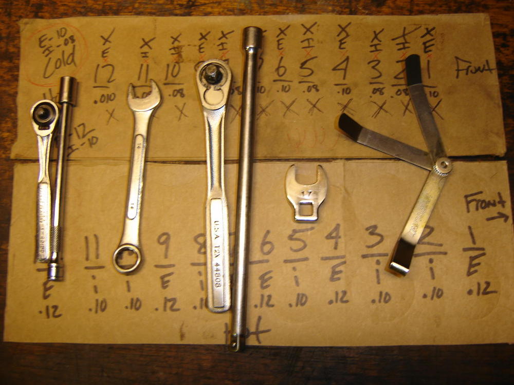

I'm glad you asked. 😉 I checked the valve lash. By the way here's a chart I like to make before starting in order to keep track of what I have checked/adjusted. I just put an "X" for each one as I knock them out.
So I adjusted the valves. I finally have done it enough that I can do it quickly. LOL

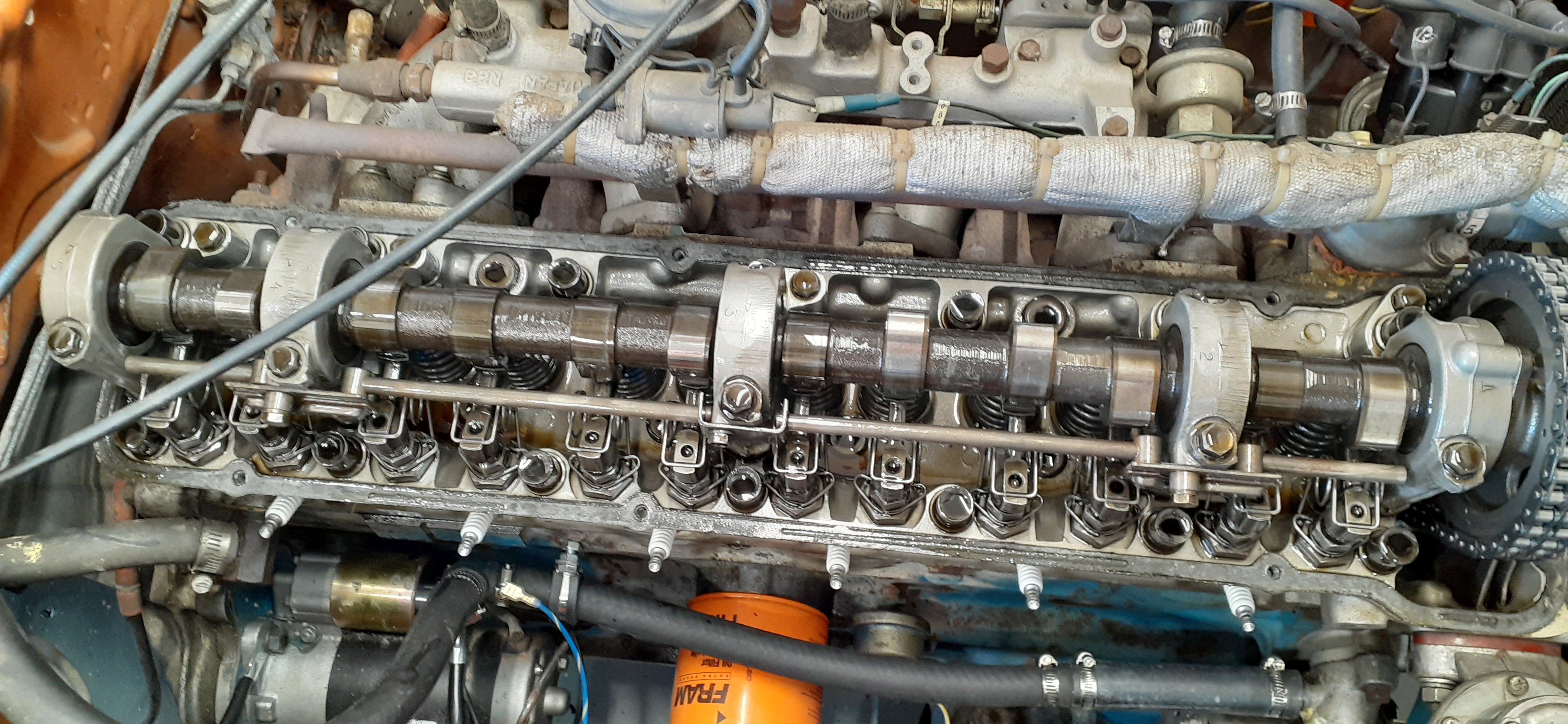

After that I went to adjust the timing, and I could still hear the tick. I used a mechanic's stethoscope on the valve cover, and all of the sounds were nice. I took a short video and sent it to a very good friend who taught me a lot about wrenching on Zs. He confirmed one of my possible causes. He believes it's an exhaust leak. At least I can check that, and I probably have at least one intake/exhaust gasket lying about.

I hear ya' on the chart. What got me doing it was 2 at a time come up so the chart cuts my time in half. Great when it's hot.
