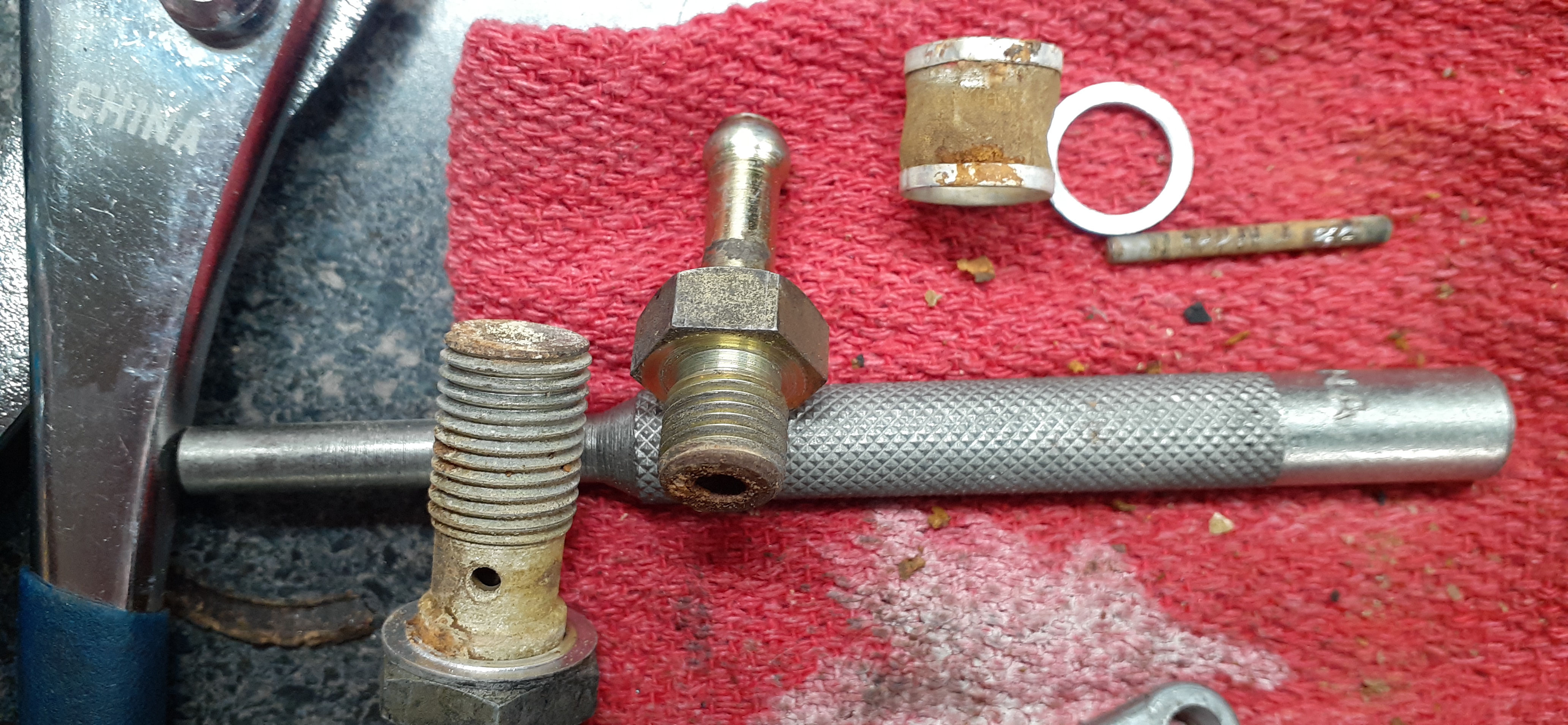

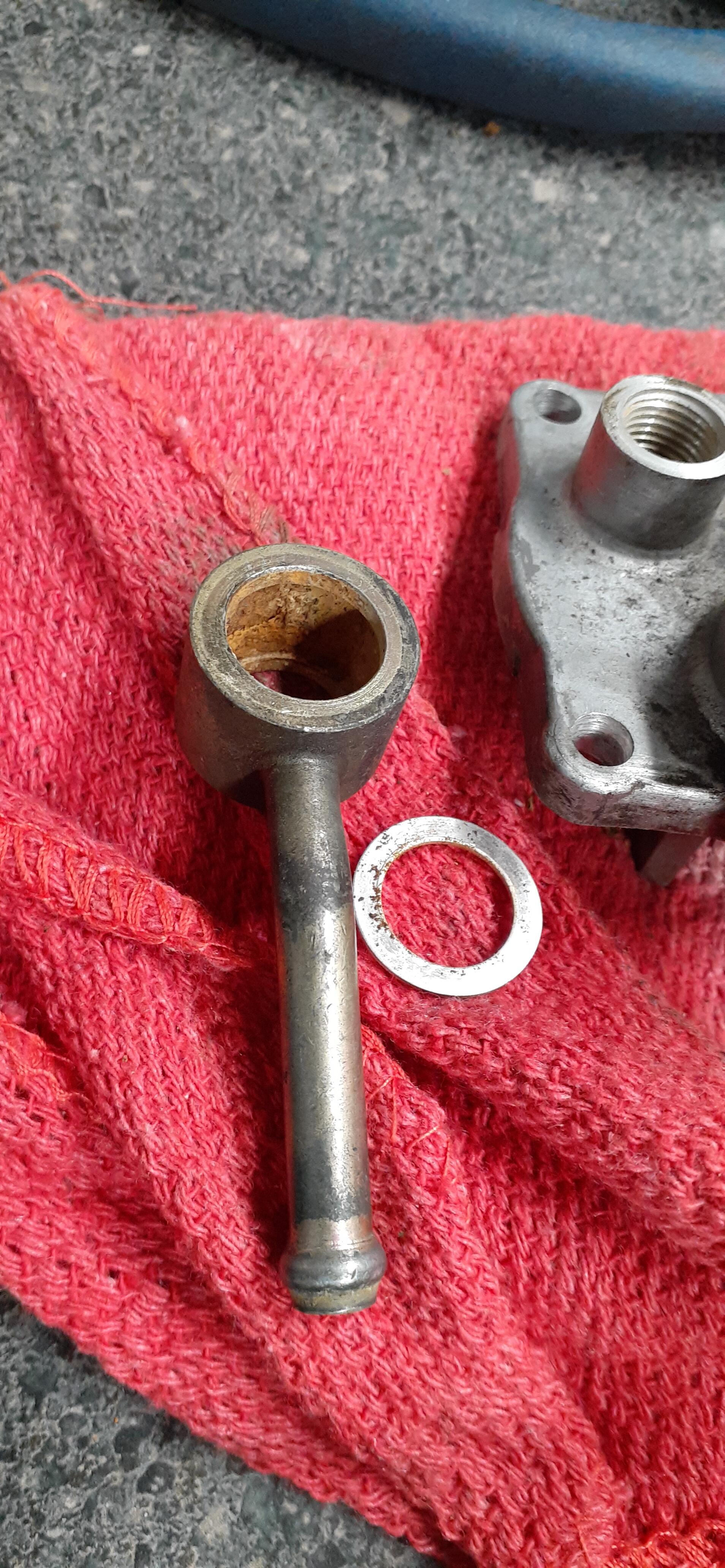

This weekend I decided to go after the carburetors. The car had not run in 9 years, and I was worried about what I might find. As I pulled apart the float bowls, my worries were confirmed. The bowl in the rear carburetor was lined with a rusty-colored dust. The bowl in the front had some black ooze in that clogged the line going to the nozzle.
If you are ever thinking about just adding some fresh gas to a Z that has been sitting for a few years, I suggest that you don't do it until after you clean out the carbs and fuel system.
Many components in the float bowl were rusted. I presume it was in part related to the ethanol fuel that was in the bowls when the car was last running.
I cleaned out the float bowls with carb cleaner and blasted out the last of the ooze with some compressed air. The rusty parts got tossed into a container and immersed in EvapoRust. After they have sat in the container long enough, they will be rinsed with denatured alcohol, dried, and coated with oil to keep the rust from coming back. (Update: I just looked at them. They look a WHOLE lot better after a couple of hours of soaking.) I also ordered new filter screens for the banjo bolts as I do not deem the old ones as being reusable.

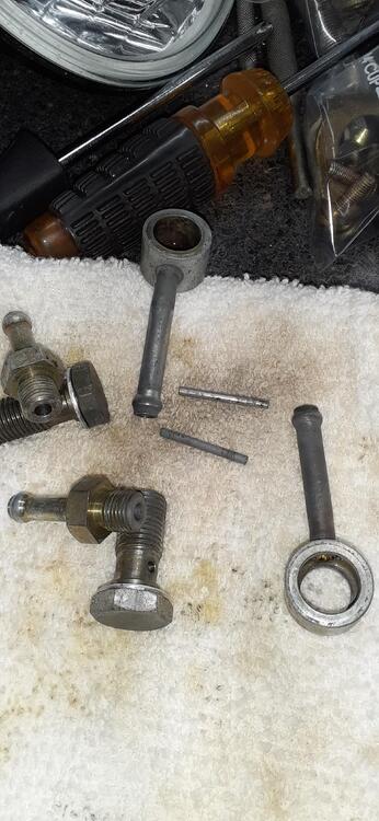

I put the new valves in the float bowls and installed the floats and the vents. The lids are secured with new gaskets. I ordered the banjo bolt filters from ZCarDepot yesterday, so I hope to have them in time for the weekend.

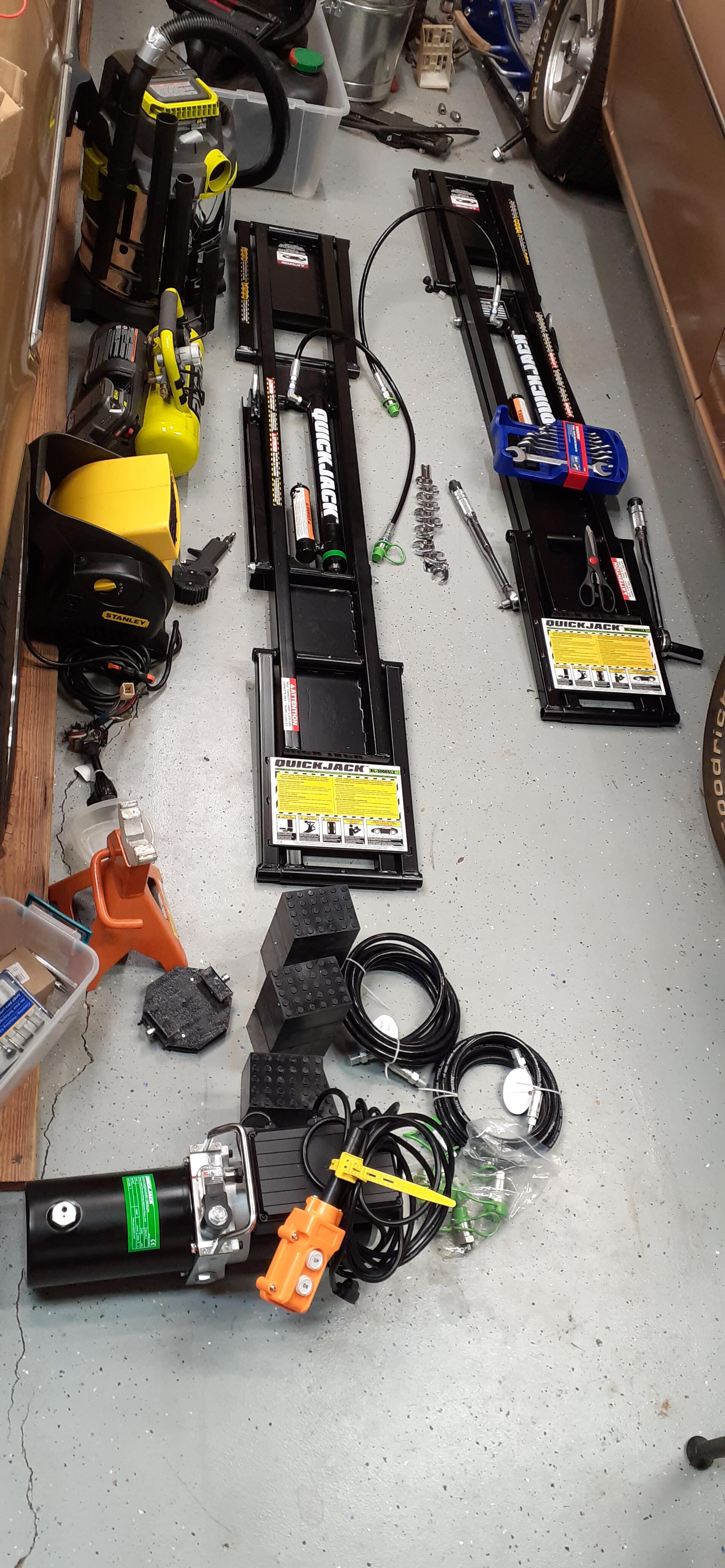

Z Car Depot has my latest parts order in the mail, so I expect to see the package on Thursday or Friday. A guy needs a good distraction to reduce the leftover stress from work. That meant spending yesterday evening in the garage to clear out room for the Quickjacks, and moving them into the garage this evening. I did the grand unboxing, performed the required RTFM, watched a few YouTube videos on Quickjacks, and set about the execution.
Since I'm not in a rush, I only worked on the ramps this evening. The hoses are connected, and the cylinders have been pressurized. No air leaks detected. Tomorrow I hope to finish putting the quick disconnects on the long hoses and pump. Maybe I'll even get to bleeding the system. We'll see.

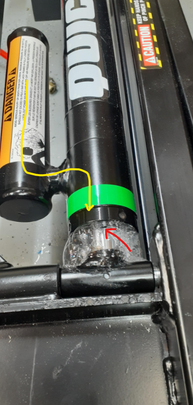

I finished the assembly of the Quickjacks today. Unfortunately, one of the air cylinders will not hold pressure. I even swapped the valves between the two ramps to see if it followed the valve. Nope. It was the cylinder. Bendpak has acknowledged the help ticket.

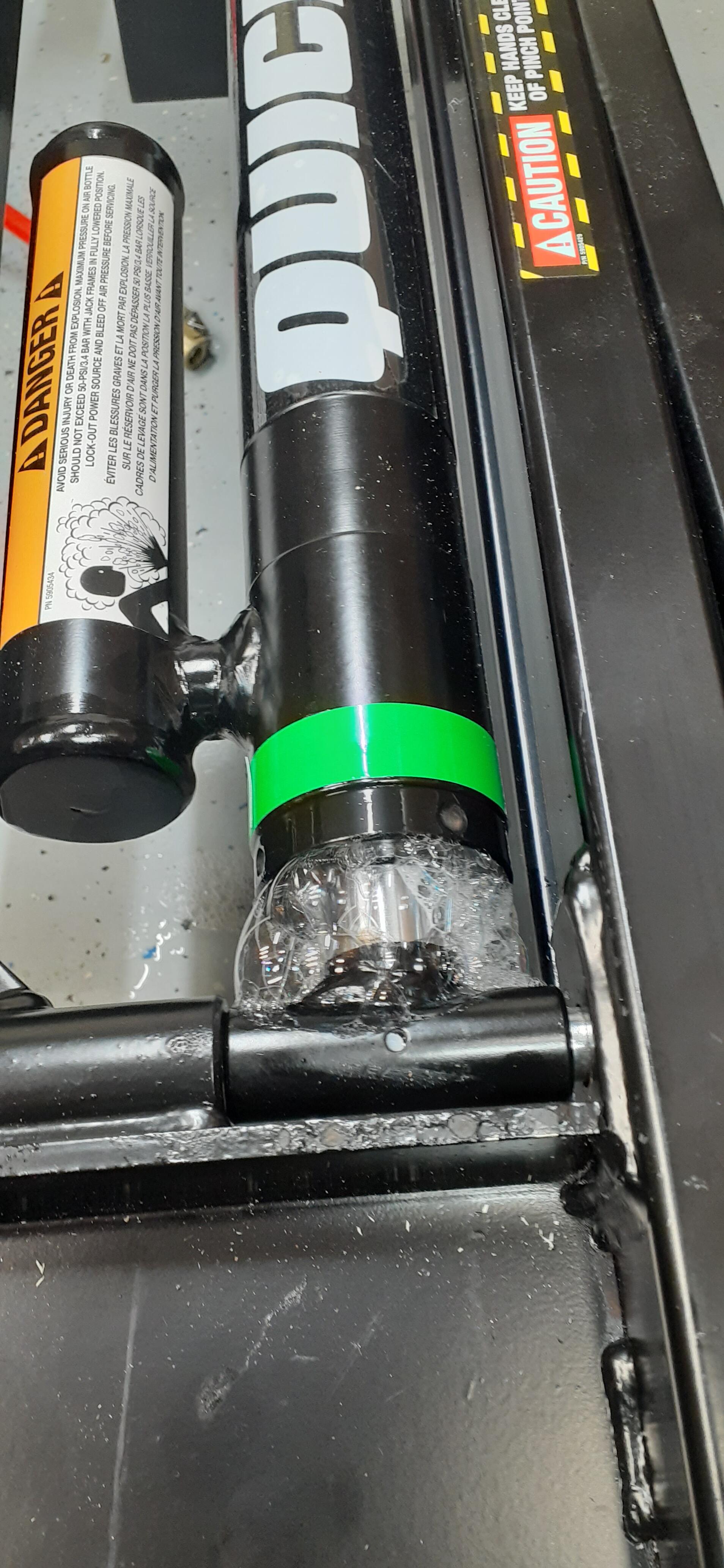

Well, the QuickJack support team is quick to respond. With a couple of emails back and forth, they were able to help me find the air leak. Now I am waiting on the remedy. Once the QuickJacks are operational, I can drain the gas and replace the tires. I might leave the car up in the air with the new tires until I finish so I don't flat-spot them.
What is it?  I can only see bubbles in your picture.  Is that a welded seam or a pipe fitting?
Seems like Quickjack is overly confident in their manufacturing process.  A leak in a pneumatic system is a pretty significant miss.
The leak is at the seal of the piston where the silver shaft goes in. Only air can leak out. The hydraulic seal is functional.
Apparently it is still safe to use like that, but the new part should be sent out. I don't mind having to replace it myself. It's a pretty straightforward procedure from what I can tell by looking at it (and from the email the support person sent). I have to undo a couple of bolts, remove the bad cylinder, slide in the new cylinder, put the bolts back, put air in the air cylinder, and bleed the hydraulic cylinder. I don't envision taking too long.
