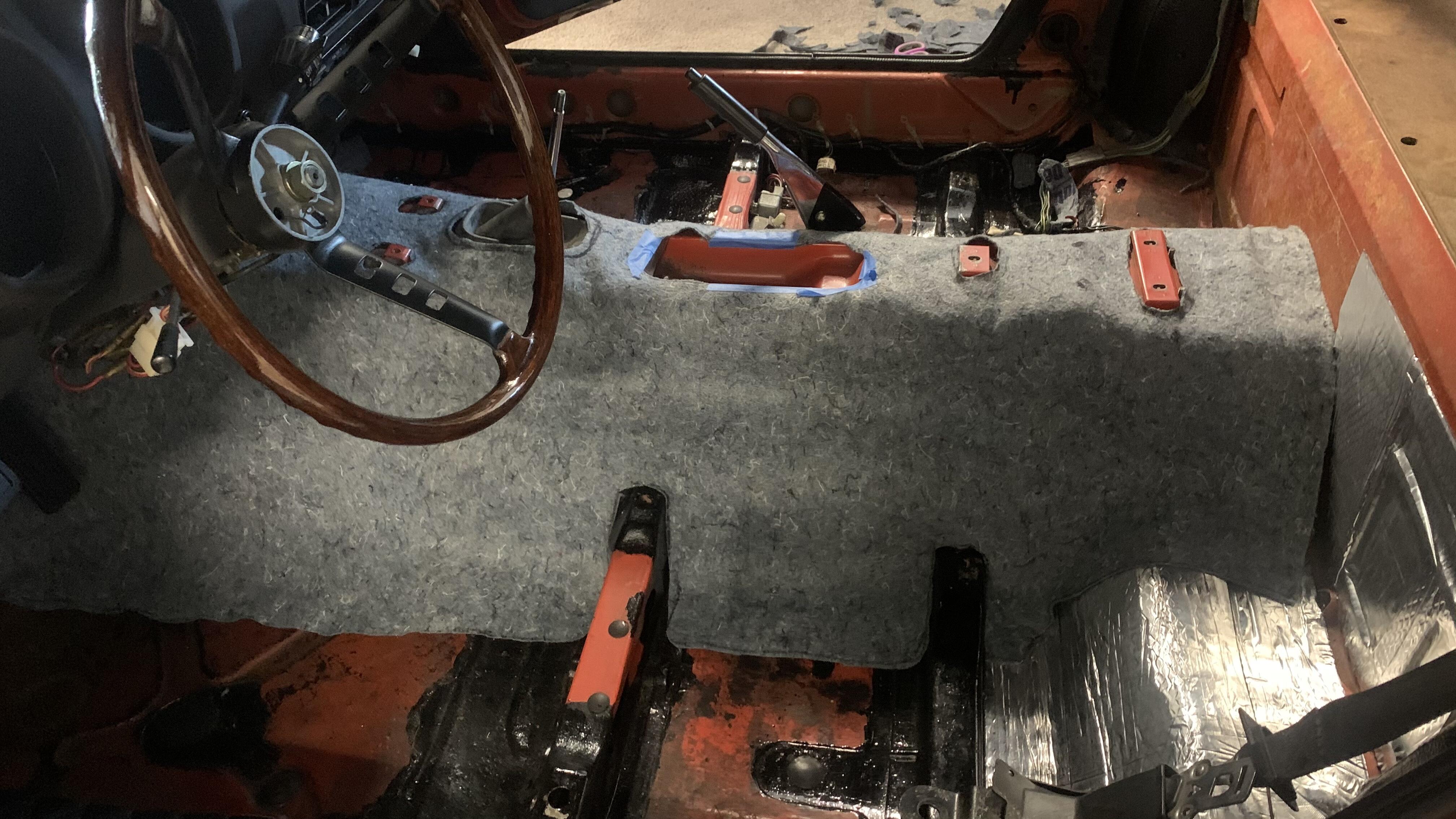

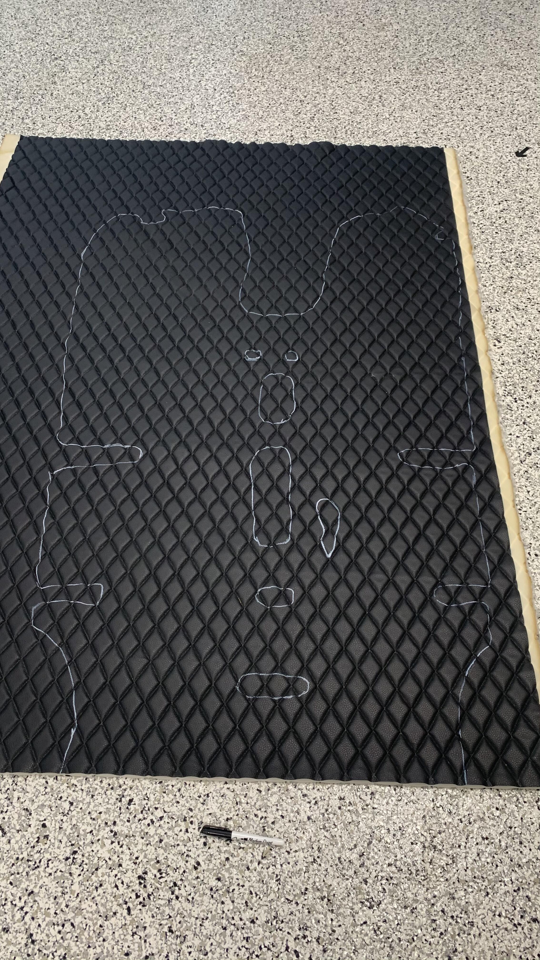

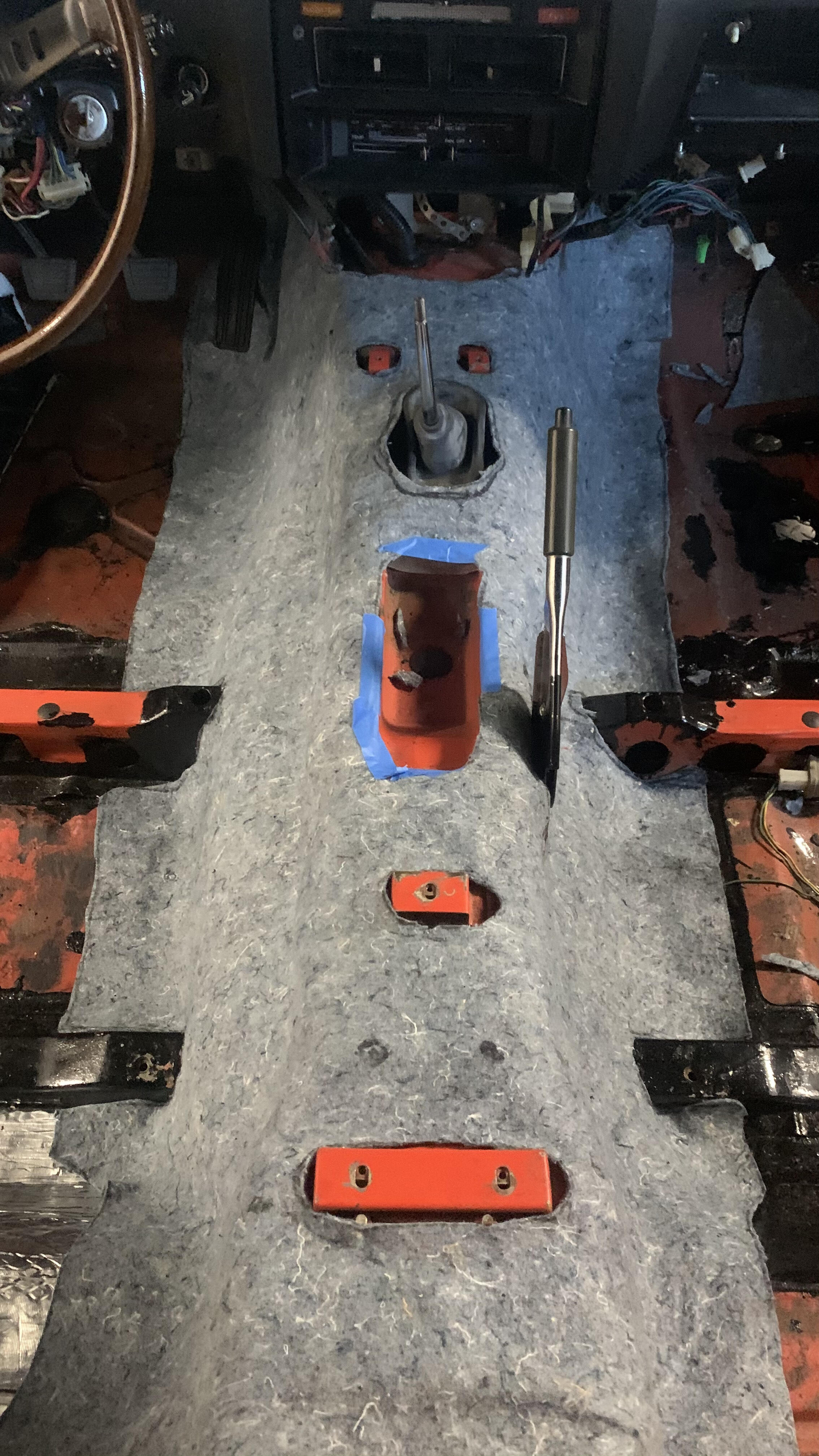

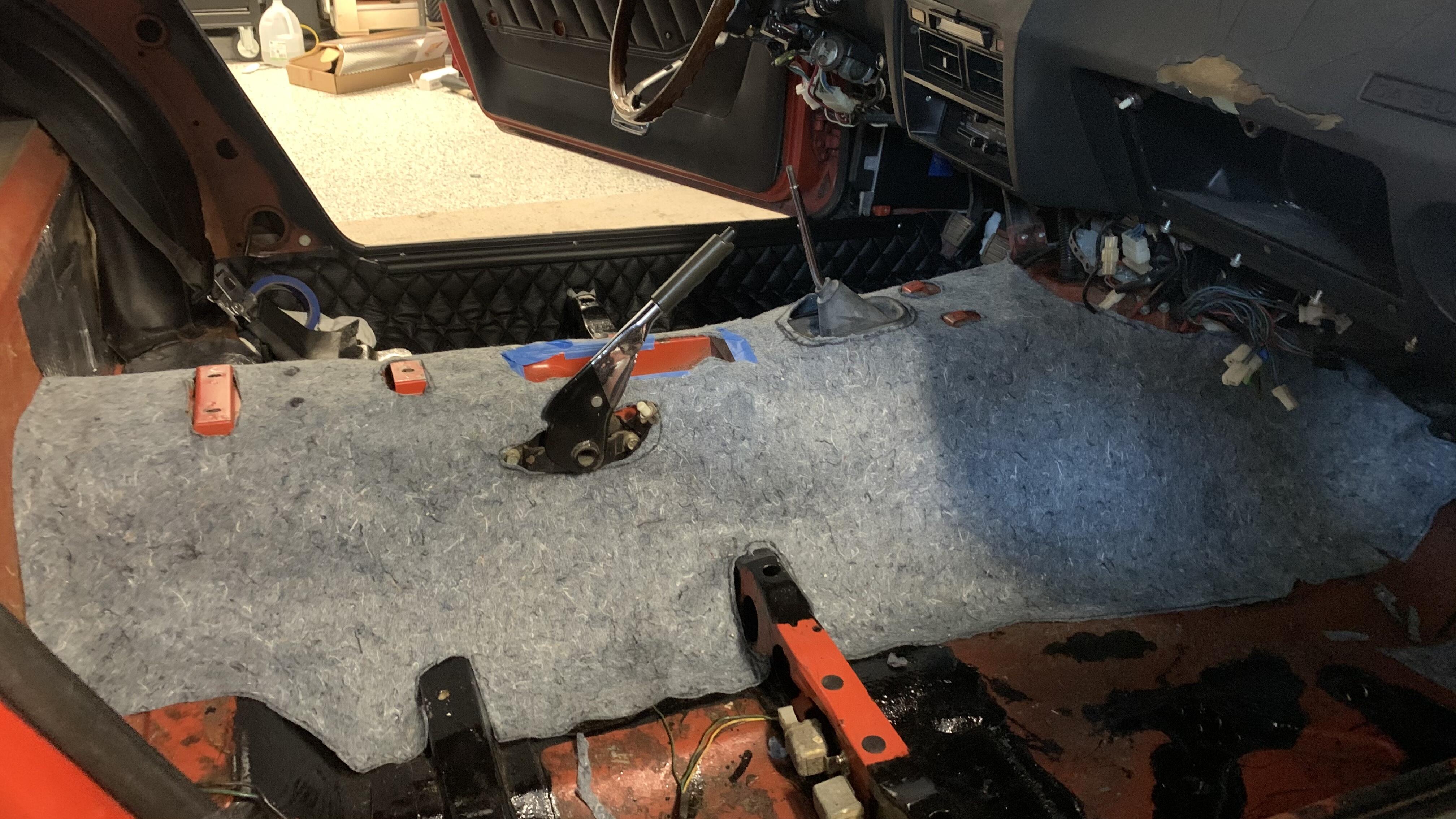

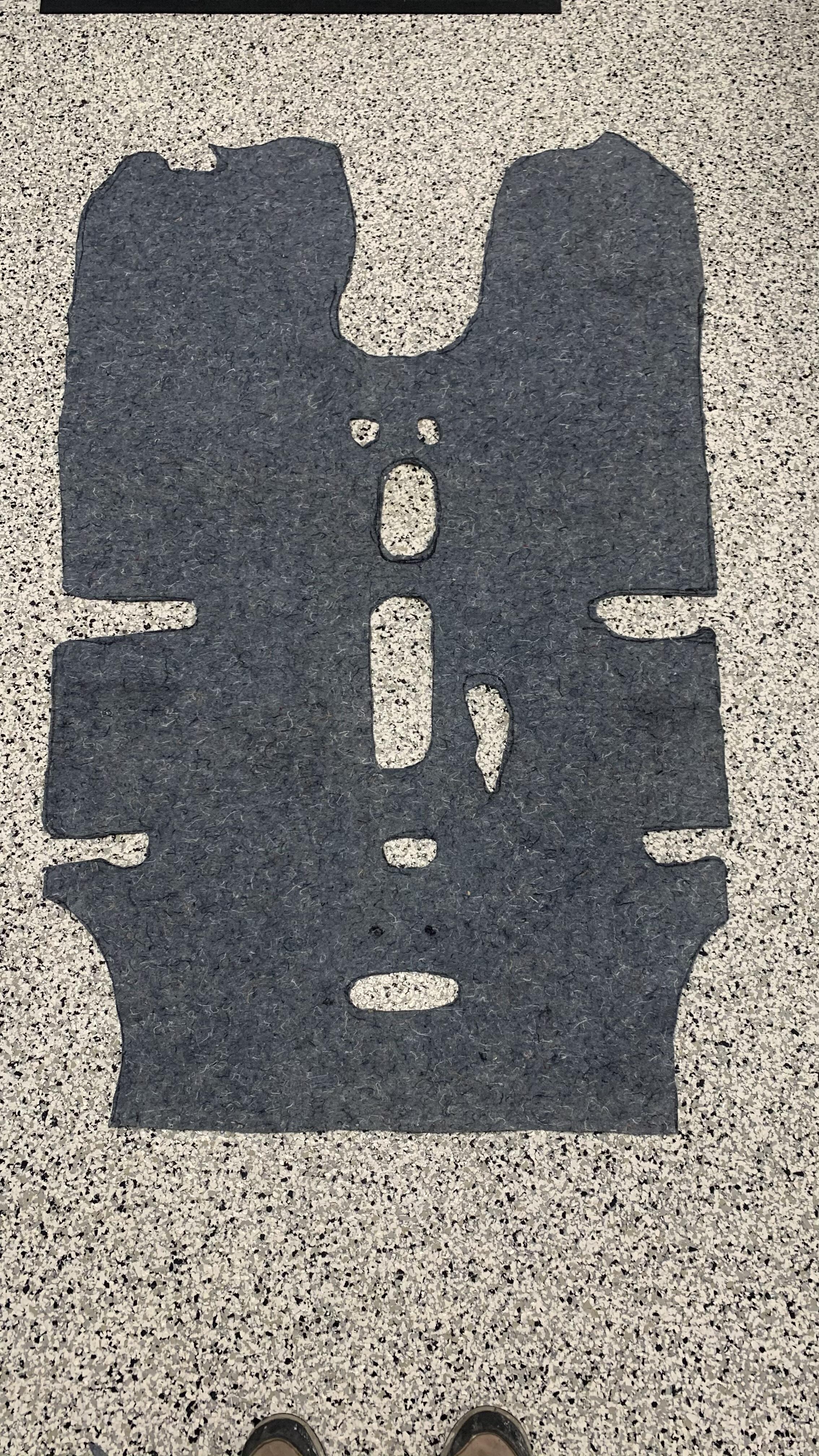

Gents,
My trans tunnel template is complete.

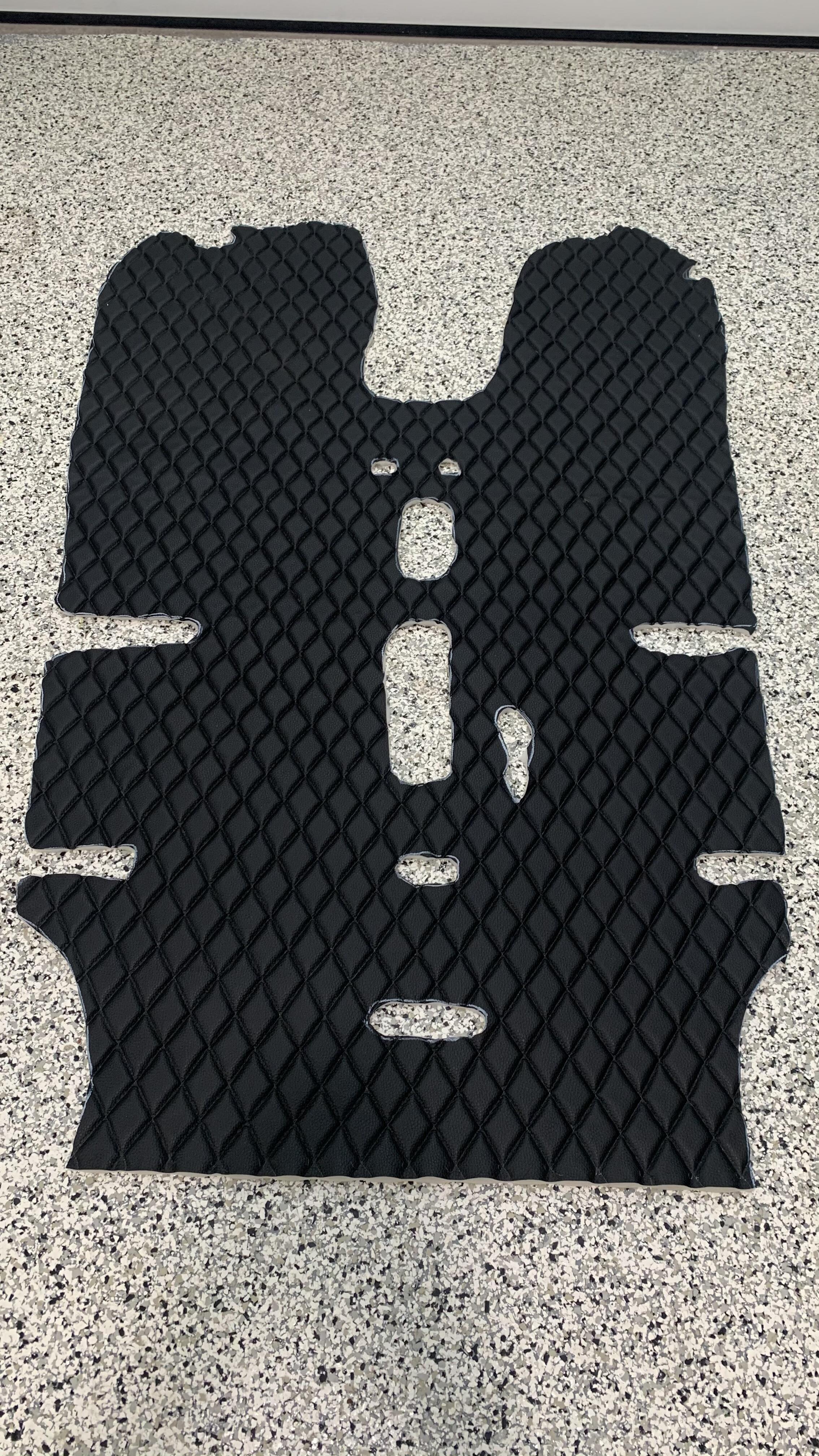

check it out.  Going to transfer this the the diamond stitch.
Anyone who wants this template let me know and I’ll ship it to you for free as long as you send it back or send it to another member and pay it forward!
That looks awesome! I'm way jealous of how well this is turning out 🙂
I've seen alot of different methods for interiors on the Z's. Is vinyl (whether that be diamond stitch or just plain vinyl) the OEM method on the center console area and door sills? I need to order my carpet kit soon so just curious! I am loving the look of the diamond stitching so far and how affordable it is.
Thanks, only the 240s had the vinyl on the transmission tunnel and rockers to my knowledge.
This vinyl I bought was only about $50 total. Spray glue is about $20 and I also bought some sound deadening material which was $60. That stuff is optional but didn’t want hear the tranny and extra noises.

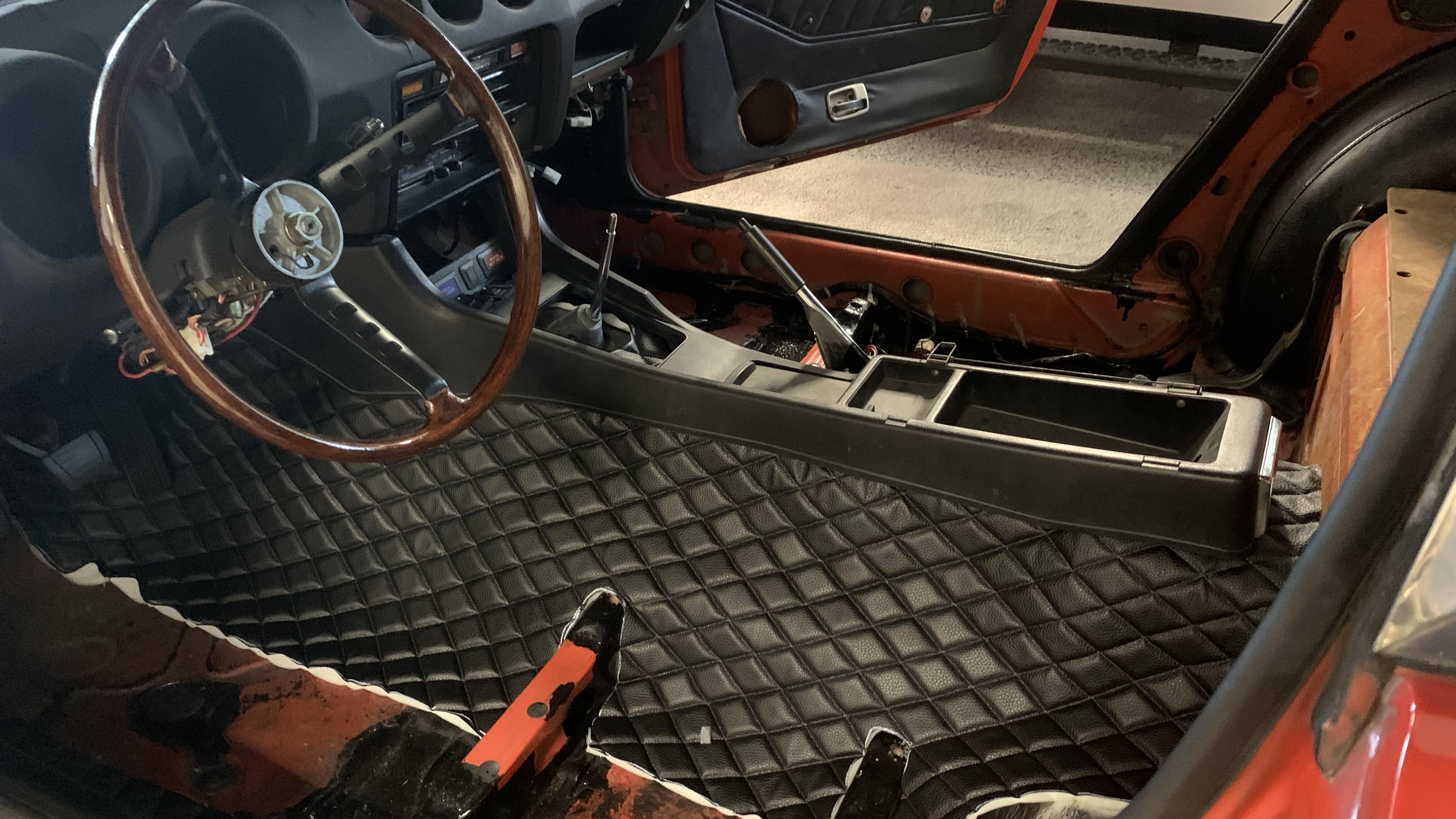

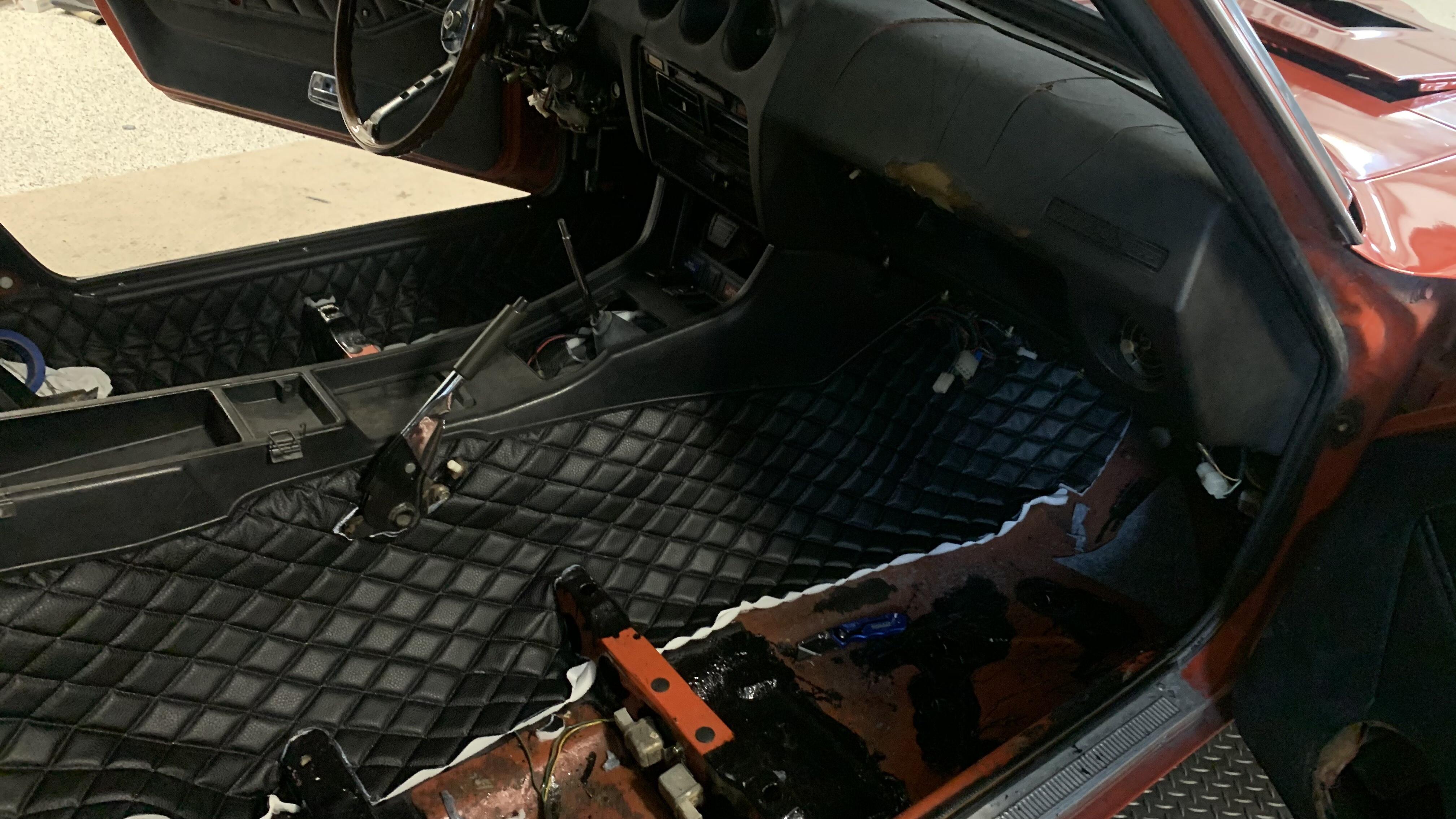

Okay, I’m finished for the day.  Got other stuff a to do around the house (Christmas decorations to keep mama happy)  and go for a run.  Here’s the test fit.  Needs some minor tweaks.  It’s not sitting  perfectly flat because it’s not glued down but just resting there.
