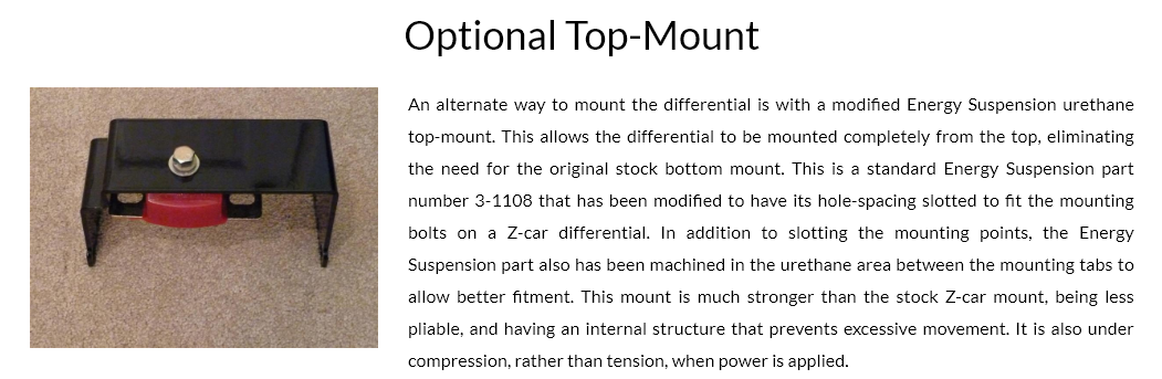

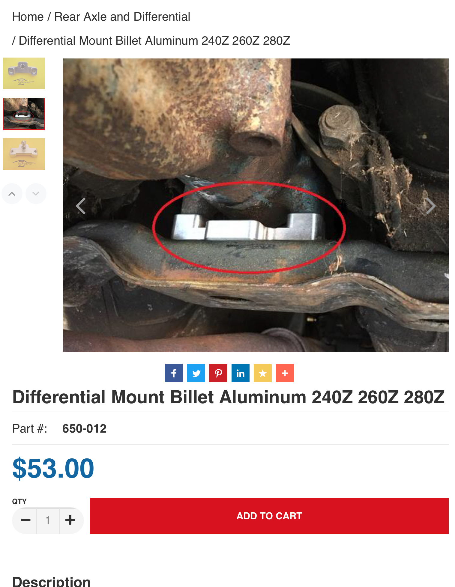

I have come across a few different options for diff mounts but I hadn’t seen this one discussed. Has anybody tried this mount?  Seems like it would transfer a lot of vibration throughout the car. I’m out of luck with the typical OEM type mount due to my car’s setup.

I would never put a solid diff mount on a street car. It would help if you told us why you can't use the OEM mount and what your car's setup is. A popular option is the Ron Tyler diff mount, a version of which can be found for sale here: https://www.technoversions.com/DiffMount.html
Somebody on CZCC posted about their using a solid mount not too long ago.  It probably transmits diff howl to the cabin, especially if you also have polyurethane crossmember mounts.  The race car guys have pictures of the bolt holes tearing out to to metal fatigue, but that's probably just a high-torque/abuse problem.
MSA sells them also.
https://www.thezstore.com/page/TZS/PROD/10-2296
The Technoversion mount is always worth considering.
My youngest son installed a solid diff mount on his '76 280Z several years ago and had to remove it after a few years of use as it had torn the sheet metal of his "differential case mounting front member" (to use the FSM term) - didn't damage the bolt holes in the chassis but tore the cross member up around the bolt holes. We had to find him a new cross member and an RT style mount. And YES! The solid mount transferred a LOT of noise and vibration into the cabin.

The RT mount really replaces the strap across the top more so than the diff mount itself. A nice upgrade from the old strap set up.
I might have a used "A" style diff mount if you don't mind a used part. They are hard to find new.

It depends on how you use it.  If you use the GM transmission mount on the top you can leave the Nisan bottom mount out completely.
@Zed Head I know a lot of people just run that upper mount with good success but I have a dumb question; what happens if that poly material fails? Does the diff just drop, and the driveshaft holds it up?
It would probably just drop down onto the stock diff mount crossmember since you still have to bolt that in since it's also part of the forward control arm mounts.
I just have the stopper on mine. I expect this would also transfer noise through the car more so than a stock rubber piece, just not as bad as the solid one ^^
I am sure it would make quite a racket if that poly piece broke / tore while you were driving with the drive shaft bouncing around. Like when the rubber part goes and you get the "clunk" but worse. IMO
