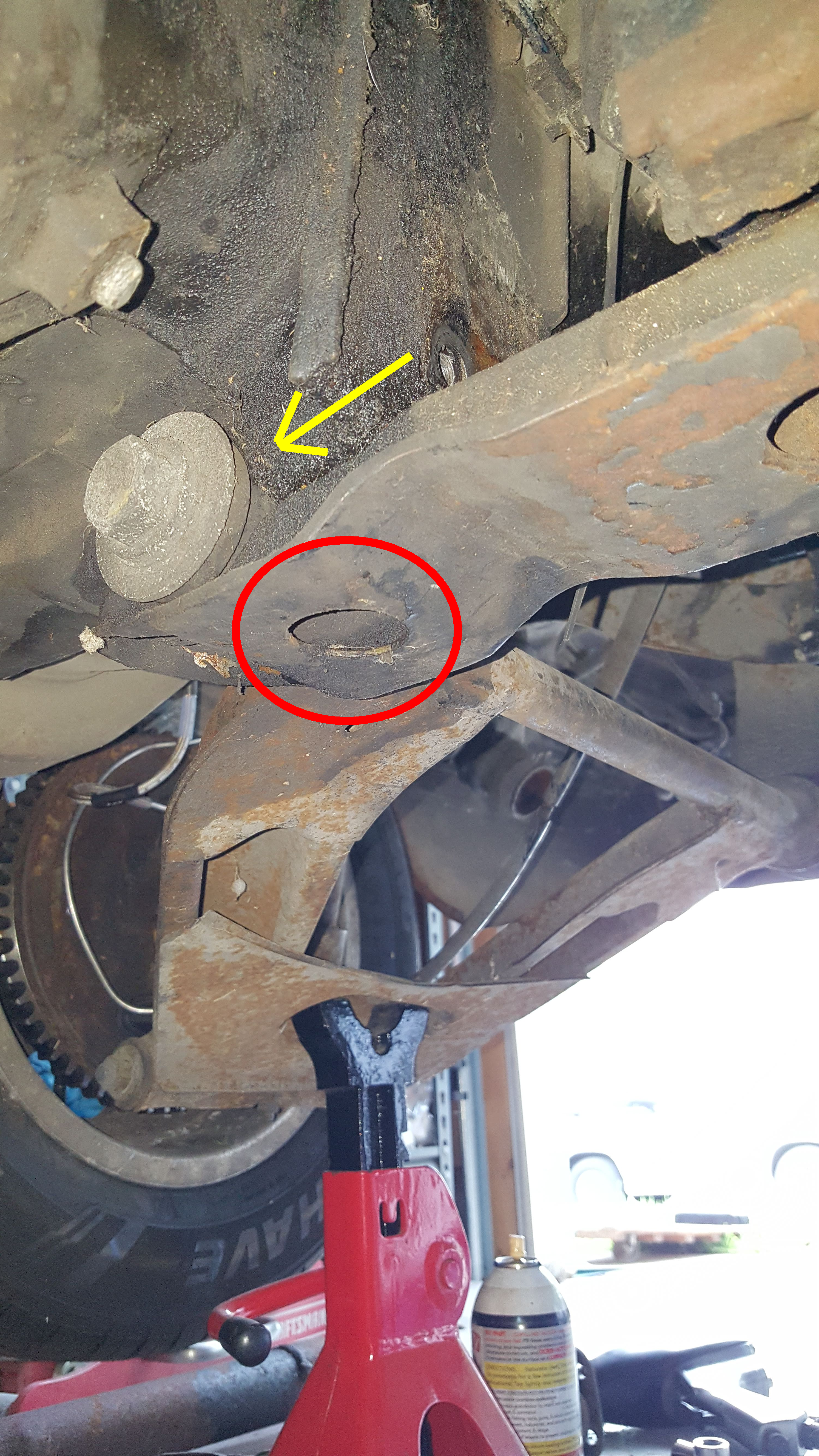

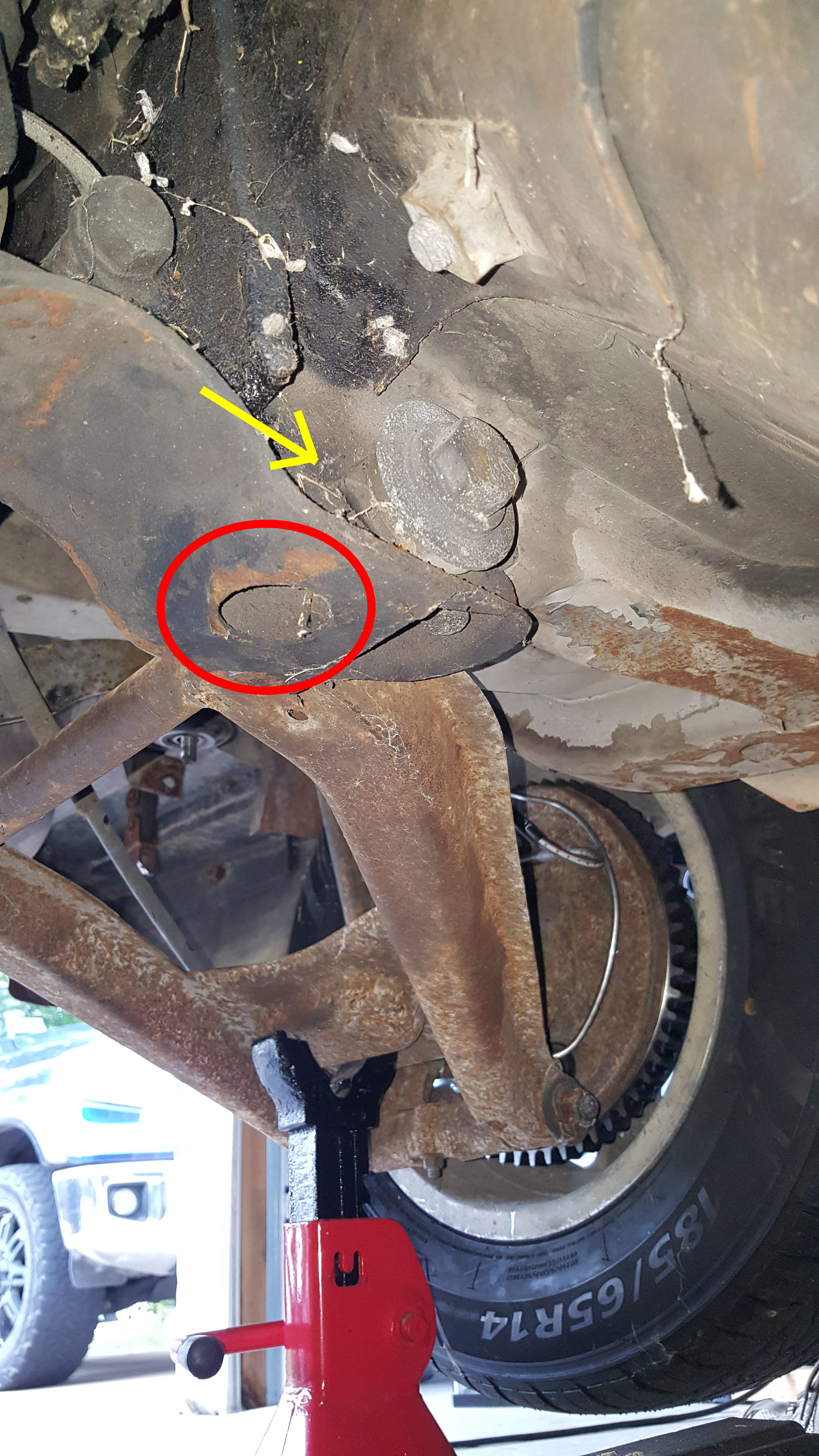

Posted May 15, 20214 yr comment_621661 I thought I could wiggle the diff out of the Z without removing the front diff cross member...looks like I am wrong. I have the car up on jack stands as you can see in the pictures and I can easily remove the front diff cross member by removing the two bolts in the red circles. My question is.....is this safe or will the car fall on me and kill me? My concern is that the jack stands are under the control/a-arms as shown in the pix and removing the diff front cross member appears to them leave the front mounting point (yellow arrows) of the control/a-arms loose...this makes me quite nervous as I don't care to die doing this project. 😉 Can anyone please help with some info/advice? . Link to comment https://www.classiczcars.com/forums/topic/65387-diff-removal-question/ Share on other sites More sharing options...
May 15, 20214 yr comment_621662 I don’t think that is a safe location to lift the car up, the control arms can bend with too much force on them. Place the jack stands in accordance to the service manual. I personally place them below the doglegs there is a spot there that feels secure. a wise friend once told me; “we are going to have to remove it for access anyway, so just remove it.” Don’t try to skip steps here, you’re only making it harder. Link to comment https://www.classiczcars.com/forums/topic/65387-diff-removal-question/#findComment-621662 Share on other sites More sharing options...
May 16, 20214 yr comment_621665 33 minutes ago, texasz said: I thought I could wiggle the diff out of the Z without removing the front diff cross member. I went through that thought process myself and even managed to pry the mustache bar around and loosen a bolt here and there to get it out. But the procedure shown in the FSM is best. You can go one step easier and just remove the mustache bar also. I don't know why they don't recommend that way, since then everything is straight up and down. Load comes straight down, goes straight back up. The front cross member and mustache bar are good handles for stabilizing the load too. It's in the RA chapter. Link to comment https://www.classiczcars.com/forums/topic/65387-diff-removal-question/#findComment-621665 Share on other sites More sharing options...
May 16, 20214 yr Author comment_621684 A little tricky of a job though we got it done! Moved the jack stands as we suggested (and I was suspecting I may need to) and using two floor jacks (one in the back and one under the front cross member I loosened the the front cross member, dropped the front a little bit (maybe an inch), then wiggled the entire thing on both jacks forward until the two rear bolts cleared the mustache bar and lowed both jacks at the same time. After sliding everything out, removing the cross member from the diff and sliding back up under the Z to put the cross member back in place I noticed how the arms had moved a little bit and was VERY glad I moved the jack stands. 😄 Next is to figure out what must be done to get the 3.9 ratio diff to work in the Z. Looks like replacing the output flanges/output shafts as well as the input are all that is needed so that the drive shaft and half axles of the Z will bolt up. Edited May 16, 20214 yr by texasz Link to comment https://www.classiczcars.com/forums/topic/65387-diff-removal-question/#findComment-621684 Share on other sites More sharing options...
