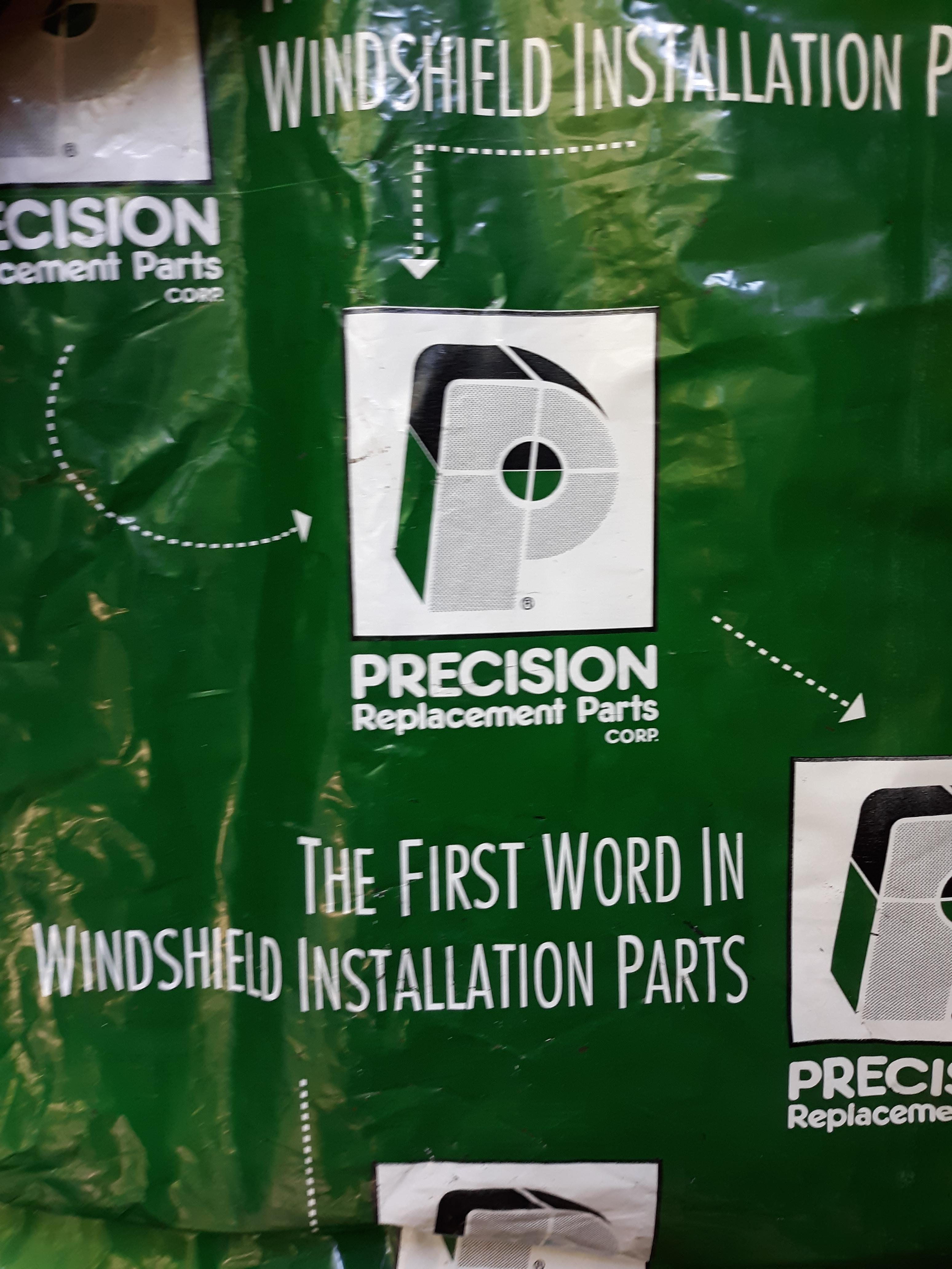

It was many years ago that I used a Precision weatherstrip kit on my Z . I remember how the door seals just didn"t work. You had to slam the doors and they didn't want to break in . I eventually went with Kia door seals , but they discontinued them.  I thought that I had read more recently that their design had changed and folks were having good luck with them. Well I just received a full kit and the door seals still suck. Same deal-doors have to be slammed against the hard rubber . I just ordered the spendy Vintage rubber set -hope I'm not disappointed again.
You talking about these I'm sure because I bought the complete set about 10 years ago. Got them from a guy after he sold his Z. Glad I haven't yanked the OE yet.
Edited by siteunseen
