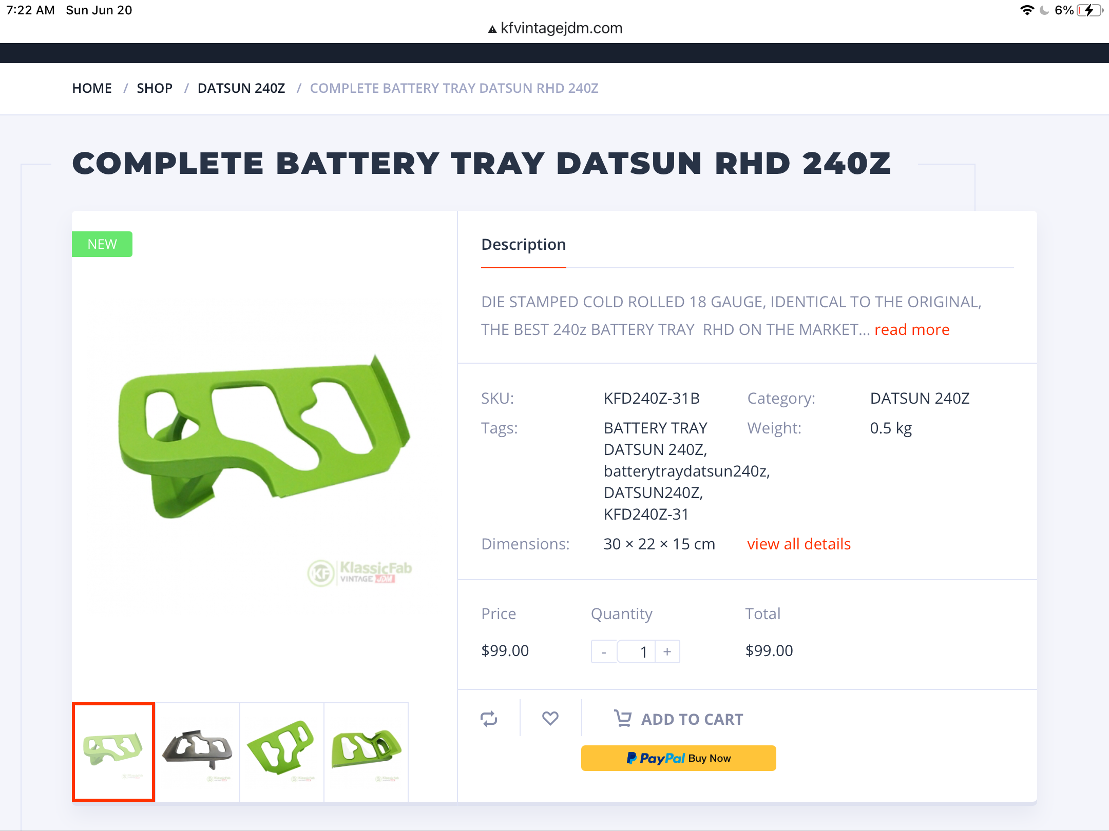

Just to help everyone down the line, don’t forget our friends at KFVintage now have a new battery tray at a very reasonable price.
That tray looks very nice, and at $100, it's a deal.  So my time was worth $8.50/hr.  😪.  It's a good thing I have plenty of time.
