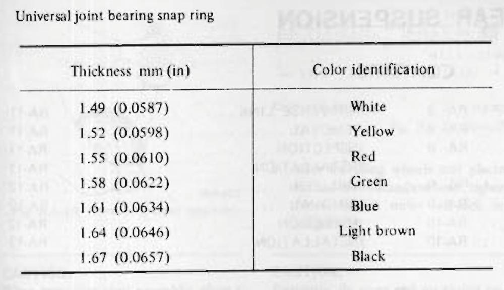

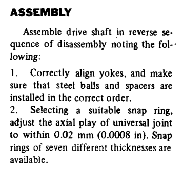

April 27, 20214 yr comment_620572 I'm not sure what you mean by phasing the the propeller shaft or halfshafts. The half shafts yokes should be in line, but that is very visable if they are not. The main source of vibrations after changing uni-joints is the tolerance in the uni-joint. The uni-joint should have 0,02mm endplay. This is important to keep the shaft centered and balanced. Nissan make 7 different sizes (1.49 to 1.67mm) to calbrate the tolerance to the correct specifications. This could be your source of the vibration. Link to comment https://www.classiczcars.com/forums/topic/65321-prop-shaft-and-half-shaft-phasing/#findComment-620572 Share on other sites More sharing options...
April 27, 20214 yr Popular Post comment_620587 I agree with Chas. The Nissan joints come with the 7 sets of snap rings and are expensive, around $90 a pop as I remember.... As a alternative, you could get @Captain Obviousto calculate the mathematical number of variations of switching the yokes and joints around one at a time. Link to comment https://www.classiczcars.com/forums/topic/65321-prop-shaft-and-half-shaft-phasing/#findComment-620587 Share on other sites More sharing options...

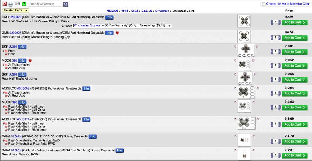

April 27, 20214 yr Author comment_620607 I wonder if i installed the wrong type of ujoint on the driveshaft, it looks like some are specified for the rear axels and NOT the drive shaft. From my records I had 2x Beck / Arnley 1020361 and 4x GMB 2200029 When I opened the B/A 1020361 box the u joints were stamped GMB. Per this thread, it looks like 1020361 are for the driveshafts, hopefully no mixups on the install... Edited April 27, 20214 yr by heyitsrama Link to comment https://www.classiczcars.com/forums/topic/65321-prop-shaft-and-half-shaft-phasing/#findComment-620607 Share on other sites More sharing options...

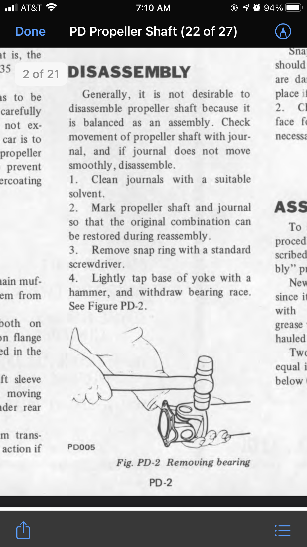

April 27, 20214 yr Popular Post comment_620613 Link to comment https://www.classiczcars.com/forums/topic/65321-prop-shaft-and-half-shaft-phasing/#findComment-620613 Share on other sites More sharing options...
April 27, 20214 yr comment_620614 2 hours ago, heyitsrama said: the endplay inspection seems straight forward, is it “ok” to have less endplay or none? Or is that not really a possibility? The tolerance is 0 to 0.02mm If you can get the circlips in without forcing the circlips in willbe OK. A little tap with a screwdriver to send them home is normal. To measure the tolerance, tap the yoke with a hammer like in figure PD-2 in your post nr.7 to pusn ghe caps ouf against the circlip. The 240Z used the same uni-joint in the half shafts and propeller shaft. The 280Z used a different staked non replacable uni-joint in the propeller shaft. That might be while some manufacturers are quoting only the half shafts or propeller shaft. Link to comment https://www.classiczcars.com/forums/topic/65321-prop-shaft-and-half-shaft-phasing/#findComment-620614 Share on other sites More sharing options...
April 27, 20214 yr comment_620658 The variety of thicknesses for the Nissan u-joints are probably for variation in the yokes, not the u-joint spiders. So, an aftermarket joint that only comes in one thickness doesn't have any way to address that variation. Might be interesting to measure that end play after a u-joint replacement. I spent $90 at OReilly for a full set of Precision u-joints then took them out and returned them when I realized that they were looser than the factory joints I had replaced. I really only needed one but I thought that doing all would be better. Luckily I had another pair of old Nissan half-shafts that could be greased up and were good to go. After that I started collecting them at the wrecking yards. There are six separate u-joints in the drivetrain so any looseness adds up. I assume that Nissan is talking about measuring spider movement in the bearing cups. Look at that tiny number. Link to comment https://www.classiczcars.com/forums/topic/65321-prop-shaft-and-half-shaft-phasing/#findComment-620658 Share on other sites More sharing options...

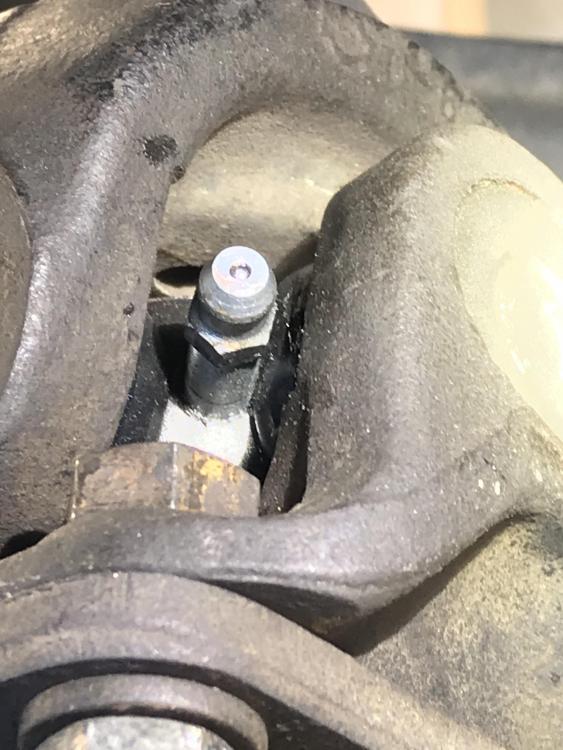

April 28, 20214 yr Author comment_620679 I decided that I did not want to pull out the drive shaft today, because I did not want to drop the exhaust from the header. Really hate that the OEM exhaust does not have a flange at the end of the down pipe. I feel like I should add one... I found multiple things, one the driver side half shaft needed to be tapped slightly to get looser along one of its axis. I also found that grease fitting that was in the body on the GMB half-shafts has a slight interference with the rubber on the end cap. I went to the hardware store and got some of those Allen key end caps that fit into the threads to block it off. I used 1/4x28 - 1/4” long end inserts so that there is less chance for contaminates to enter the joint. I can spin the brake drum and I’m not able to feel the bind spot anymore. there is still a vibration at 60mph+ so I think ill have to drop the exhaust on Saturday morning and inspect the drive shaft u joint on the yoke that goes into the gearbox. The one that is on the differential did not seem to bind at all. At least it’s getting better..... @Zed Head smart to have some backups laying around, I can’t find any Zs at the junkyards around here. Pickings are super slim, and usually there is competition for parts. Link to comment https://www.classiczcars.com/forums/topic/65321-prop-shaft-and-half-shaft-phasing/#findComment-620679 Share on other sites More sharing options...
