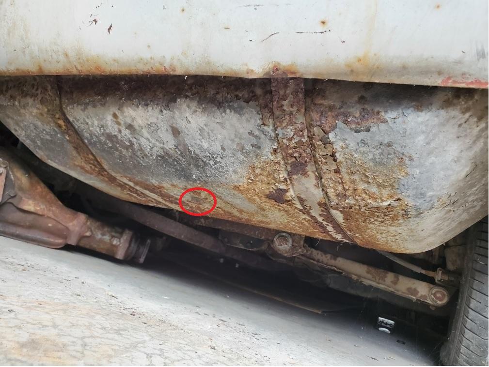

I have seen mixed reviews of a drain screw on the bottom and there is NOT one shown on tank scematic... is there a drain screw on the 71 240 tank??
Did you look closely when you took that photo of your gas tank?
I don't know where you saw someone say there isn't a drain plug.
I would pull that tank and check it before I put fuel in it! 50/50 it holds fuel, maybe less
