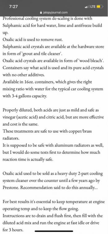

Here’s a couple of screenshots from when I was looking into this. Haven’t tried it. Guess the engine would have to be in a running state also

If the engine is still running or even if it is not I've used full strength CLR and leave it over night then flush it out with a garden hose, if the freeze plugs have already been knocked out then as Patcon says a power washer does a good job.

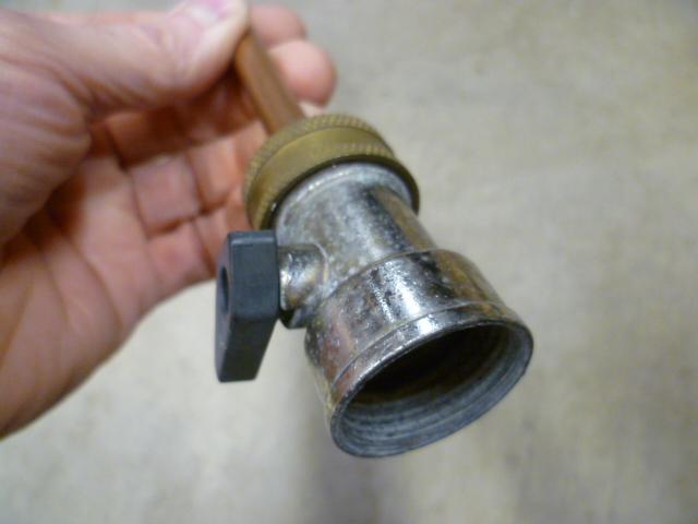

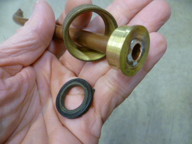

I didn't have a pressure washer, so I made a little garden hose blaster instead. Of course, a real pressure washer would have been more powerful and presumably more effective, but it's what I had access to at the time. With "standard" household garden hose pressure, my contraption will shoot about thirty feet, so it's not bad.
Cobbled together from stuff I had laying around. Looks like this:
Here's the business end. I just crimped down the sides in a bench vice. Very scientific like:
Soldered a piece on the end to adapt to a hose:
And put on an in-line hose valve:
It's small enough that (with the freeze plugs removed) I could reach up inside the block and around the piston jackets into the dark recesses.
