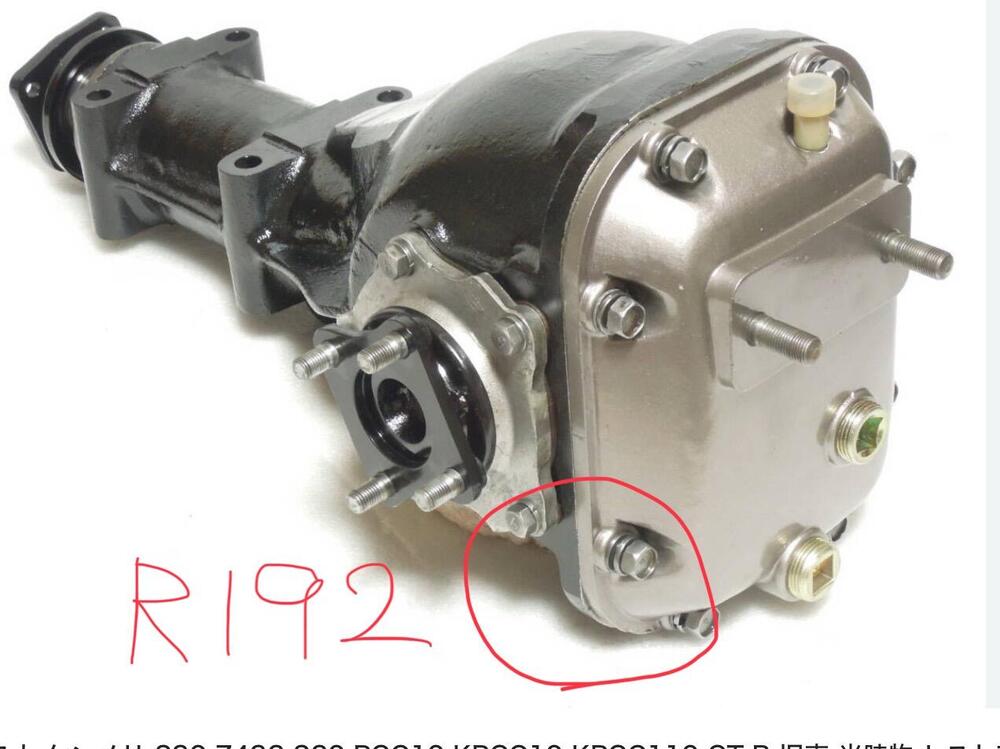

I am also curious about the car in question might have an R160, not an R180 neither an R192. The easiest way to distinguish them is the bottom corner, R192 doesn’t have a protrusion while others have.

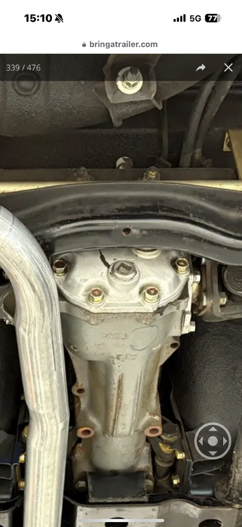

Thank you Alan! Also thank you for asking about the rear differential, looks like the car in question has an R160, that is why I felt the portion of the exposed spline something bigger than 35mm. Now I feel better.
