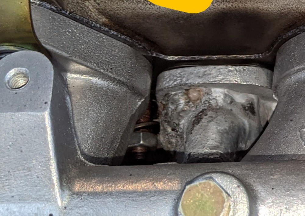

I'm going to disagree, even from my novice position here, that a new header is required.  This header is original and has worked with no leaks, I'm assuming, for years.  The only things that changed since I bought it were:
1. I removed it and got it ceramic coated at Jet-Hot.  If anything, this smoothed the mounting surfaces that meet up with the head.
2. Someone noted the pitted holes in one of the header pipes. I took that pic to send to a welder friend. Had him braze weld the holes.

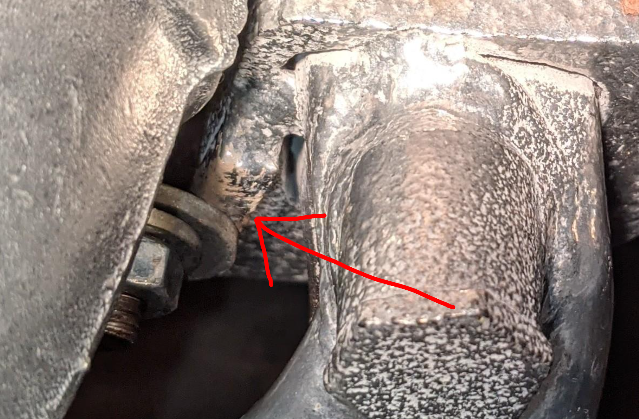

3. He went a little overboard around those holes and messed up the pre-made mount point for the washers that clamp down on exhaust manifold at the same time it clamps down on the intake maniful.  Note: Those thick flange side plates are made to be the same thickness as the intake manifold flange -- meaning that where you saw one of the nut/washers clamping down it was a mismatch because of the weld work. (I.e., the OEM flanges of the exhaust manifold weren't designed to be same thickness of the intake manifold flanges.)  Instead of taking off the header at that point and grinding it down to the appropriate, I used a smaller washer and tried to make due.  Obviously, that needs fixing. Here is the spot I'm talking about:
And here is what a normal one looks like:
4. I did not try to tighten the bolts/studs a ton because I did not want to break off a stud -- which I'd just done when removing the thermostat housing.  This is also why I'd opted not to replace the whole set of studs/washers/bolts with a kit from MSA.  I did not want to deal with another drill-out into the head.  But, alas, I may have to take that chance.
For now I'm going to take off the intake manifold, take off exhaust manifold and grind down that spot to receive the washer, triple check that I've got the new manifold gasket facing the right way, and try to tighten down.  In the meantime, I'll look into the h/w kit.

Sounds like a good plan. Be sure and check the flanges for straightness, and check the head surface too.
