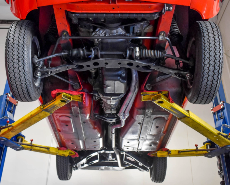

October 16, 20204 yr comment_608103 I would say NO to original paint. The texture/orange peel is wrong. ...unless Nissan changed there paint process for later series 1s.  In contrast, I could tell in just a few pics that the $300k car was original paint...it looks like mine.  Link to comment https://www.classiczcars.com/forums/topic/64539-31k-miles-series-i-240z-up-for-auction-on-bat-over-100k-on-first-day/?&page=5#findComment-608103 Share on other sites More sharing options...
October 16, 20204 yr comment_608105 I do agree with the reflection comment, but the paint is just off....even the underside. My 70 Z without dealer undercoating is completely safari gold on the bottom, no black areas. Just looks wrong And the silver painted parts drive me up the wall. In my opinion, car was refreshed before storage, then left to patina/rust.  Link to comment https://www.classiczcars.com/forums/topic/64539-31k-miles-series-i-240z-up-for-auction-on-bat-over-100k-on-first-day/?&page=5#findComment-608105 Share on other sites More sharing options...

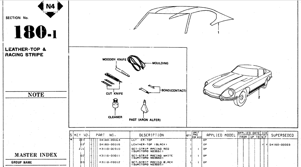

October 16, 20204 yr comment_608106 1 hour ago, 26th-Z said: Your question is posted, PZR. Looks like Lstepp4re is having a "non-constructive" moment. Yes. That was quick! Well spotted on the carb front Captain Obvious. Let's see what the seller says. The more you look at the car, the more you see. Which would be fine - most of these cars have 'had a life' and we all have to be pragmatic with this and that - but it clashes with being talked-up as a "250k+++" car. From what I've seen, very few BaT posts by 'Lstepp4re' seem to be all that constructive. He got it wrong - again - about side stripe kits (he said "aftermarket only") and nobody picked up on it. How is he credited as being any kind of guru? Link to comment https://www.classiczcars.com/forums/topic/64539-31k-miles-series-i-240z-up-for-auction-on-bat-over-100k-on-first-day/?&page=5#findComment-608106 Share on other sites More sharing options...

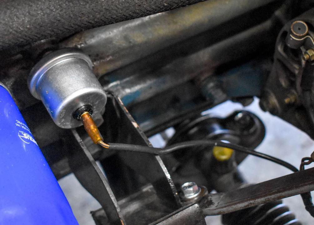

October 16, 20204 yr comment_608113 Also no mention of work done to the mustache bar, it looks to like it has the newer style bushings without the flanged ends. Also the washers are the newer type. Normally wouldn't need servicing at 31K miles, IMHO. Regarding @240260280's mention of the oil pressure sensor, the wiring retainer is also missing. The one that picks up an engine mount bolt. Link to comment https://www.classiczcars.com/forums/topic/64539-31k-miles-series-i-240z-up-for-auction-on-bat-over-100k-on-first-day/?&page=5#findComment-608113 Share on other sites More sharing options...
October 16, 20204 yr comment_608116 'Lstepp4re' seem to be all that constructive. He got it wrong - again - about side stripe kits (he said "aftermarket only") Is Lstepp4re a member of this group? Do any of you know Lstepp4re or their history?Big time collector? Or a flipper? Link to comment https://www.classiczcars.com/forums/topic/64539-31k-miles-series-i-240z-up-for-auction-on-bat-over-100k-on-first-day/?&page=5#findComment-608116 Share on other sites More sharing options...
