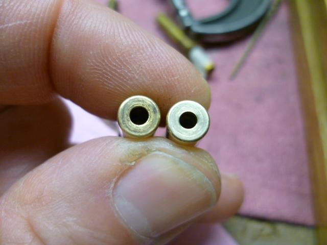

Yeah, it sounds like you're definitely in the market for a new pair of needles, and maybe a pair of nozzles as well.
Material removed by corrosion will wreak havoc on your idle mixture. And if there's pitting on the needle, it's certainly possible there's the same kind of corrosion on the nozzle. That may explain why the needles fixed one carb, but not the other.
As an example... Here's a pair of nozzles. One enlarged by corrosion and another with an accurate original sized hole. The corrosion ate away so much of the material that I can see the difference with the naked eye. At idle, it takes a very small gap to make a huge difference.
