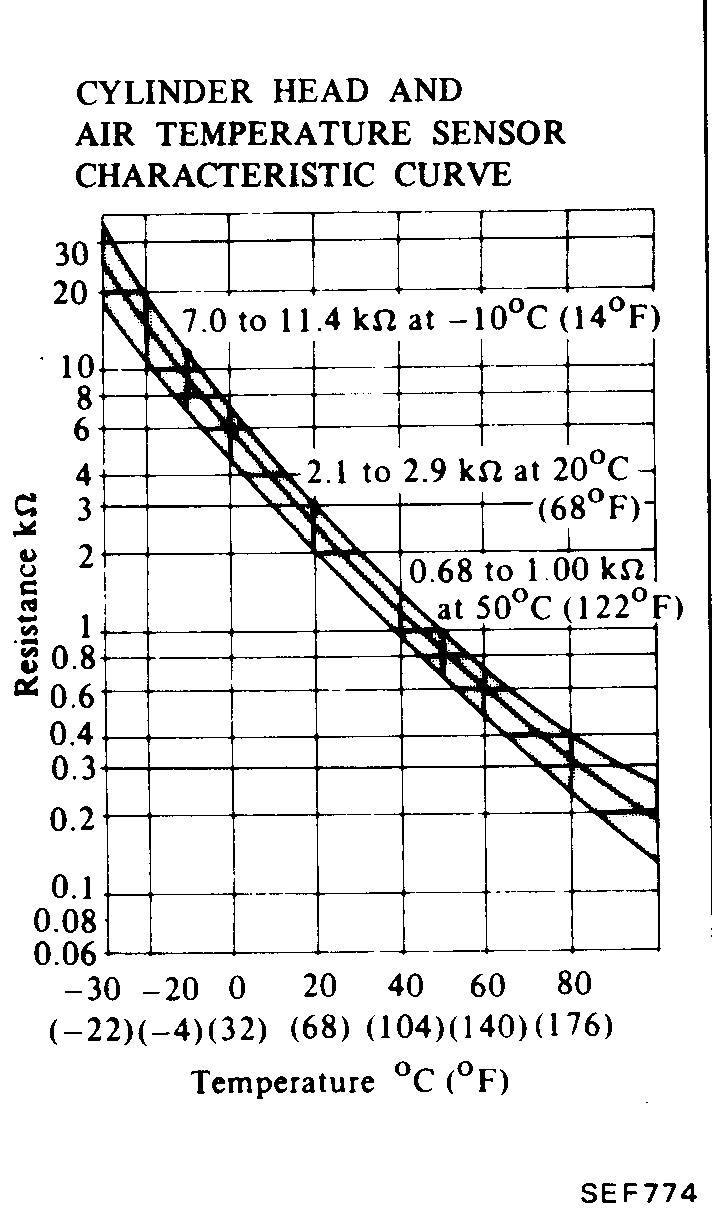

Are you referring to when CO and I were discussing the GM coolant temperature sensor vs the Nissan cylinder head temperature sensor? That was when I was prepping for the fuel injection conversion on the 260Z.
As @Zed Head pointed out, the curves for these sensors are not linear.
For the CHTS, a resistor in series would keep the curve from moving the left. It would essentially stall out at the value of the resistor. A resistor in parallel would move the starting point of the curve to the right, but the effect could be diminished as the sensor resistance drops if the value of the external resistor was high (needed to keep the curve from starting too far to the right).

No, more that you guys just have a better feel and familiarity with the equations.  I had a vague feeling so plotted some numbers to be sure, but generally, practice makes better.  Thought you guys might verify or have an opinion.  Not one of my fortes.

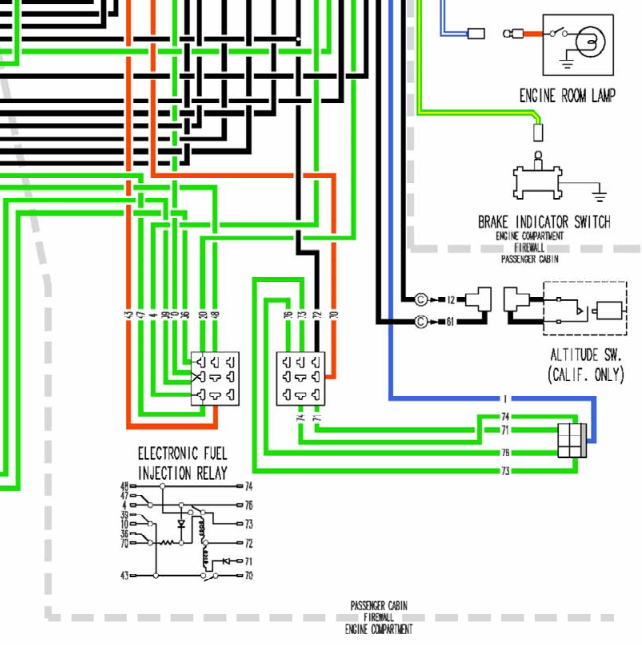

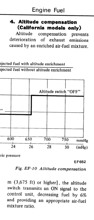

I was reading Dave WM's Pikes Peak thread and realized that you might have an altitude switch.  Keep it in mind if you can't get the FPR change to work, or try it before hand if you don't want to swap rails.
Here's the post that mentions it.  You might have the switch that you can jump or might just have an ECU that will drop fuel by 6% if you short the pins.  Keep it in mind.
The wiring diagram says it's in the cabin.  Probably under the dash by the EFI relay.
There's been a lot of talk about it but I've never seen anyone actually use it.

@Zed Head, @Dave WM et all,
yes, there is an altitude thingy dangling/mount under the steering wheel.  I will take a look at it later.   very interesting to learn at different altitude the car behave differently.  Where I live, the elevation is about 490 feet.
