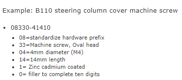

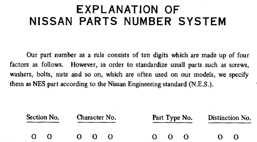

I have a pdf of the 520/521 Datsun Pickup parts catalog and in the explanation of Nissan parts number system it mentions the Nissan NES part numbering system for hardware type items, here is a snippet:
This parts catalog doesn't have full detail of the NES system but with a google search i found some interesting info on datsun1200.com. There is an article on the evolution of Nissan part numbers. I can't vouch for it's accuracy but here is a snippet on the 10 digit breakdown that expands on what you describe above:
Here is a link to the web page,
http://datsun1200.com/modules/mediawiki/index.php?title=NES_Part_Numbers
Cheers, Mike
