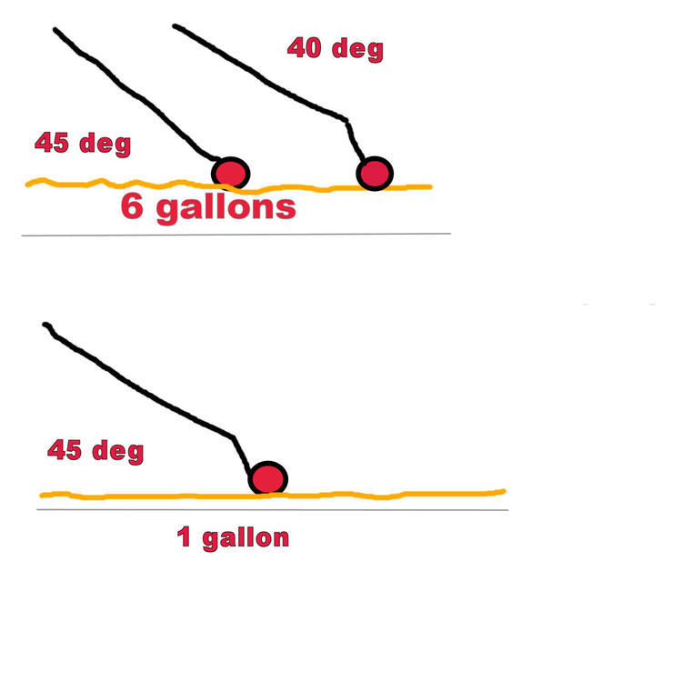

Pardon my crude drawing. Lets assume for the sake of explanation that the float arm at its lowest position is at 45 degrees from level. This will give you an empty reading on the fuel gauge. If you bend the float arm down slightly, it will effectively change the angle of the arm at the pivot point, causing the fuel gauge to read somewhere above empty. The fuel gauge may show full longer, but the main purpose of the fuel gauge is to let you when you are empty, correct? Any reading above empty is not as critical.  gas float.jpg

I agree with Steve. If you bend it down, more toward the bottom of the tank you'll get an empty reading much sooner.

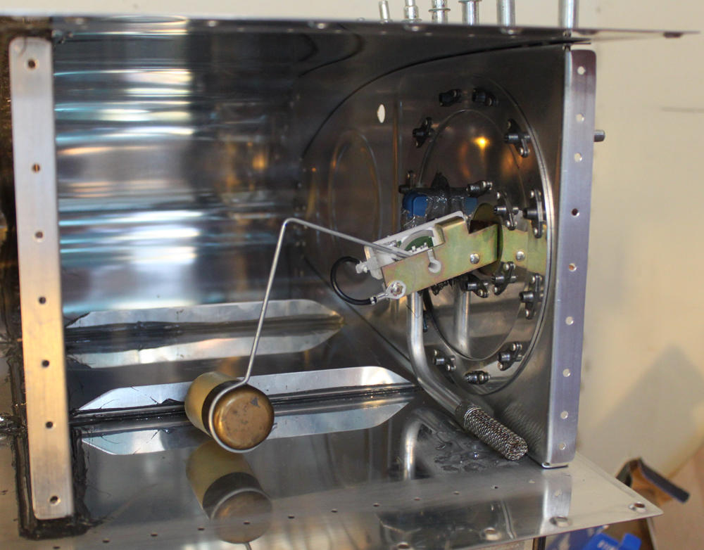

This is not a Z tank but for you to get an understanding of what I'm saying.
Sherlock Holmes here.
Since changing the sender and the dash gauge produces the same result, there is only one thing in common with both scenarios. The tank itself. (other than the wiring)
There is therefore, something in the tank that is touching/interfering with float movement at that 1/3 position. Big dent in the bottom?
About the only other thing about the tank is the rotational orientation of how you are inserting the sender into the tank. There is a little tab on the tank, and small gap in the sender ring that line up?
Really scrapping the bottom of the tank/barrel here...
Another test, If you move the sender arm in free air with it out of the tank, does the gauge respond in the same way? (have to connect a ground wire between the sender body and the tank).
